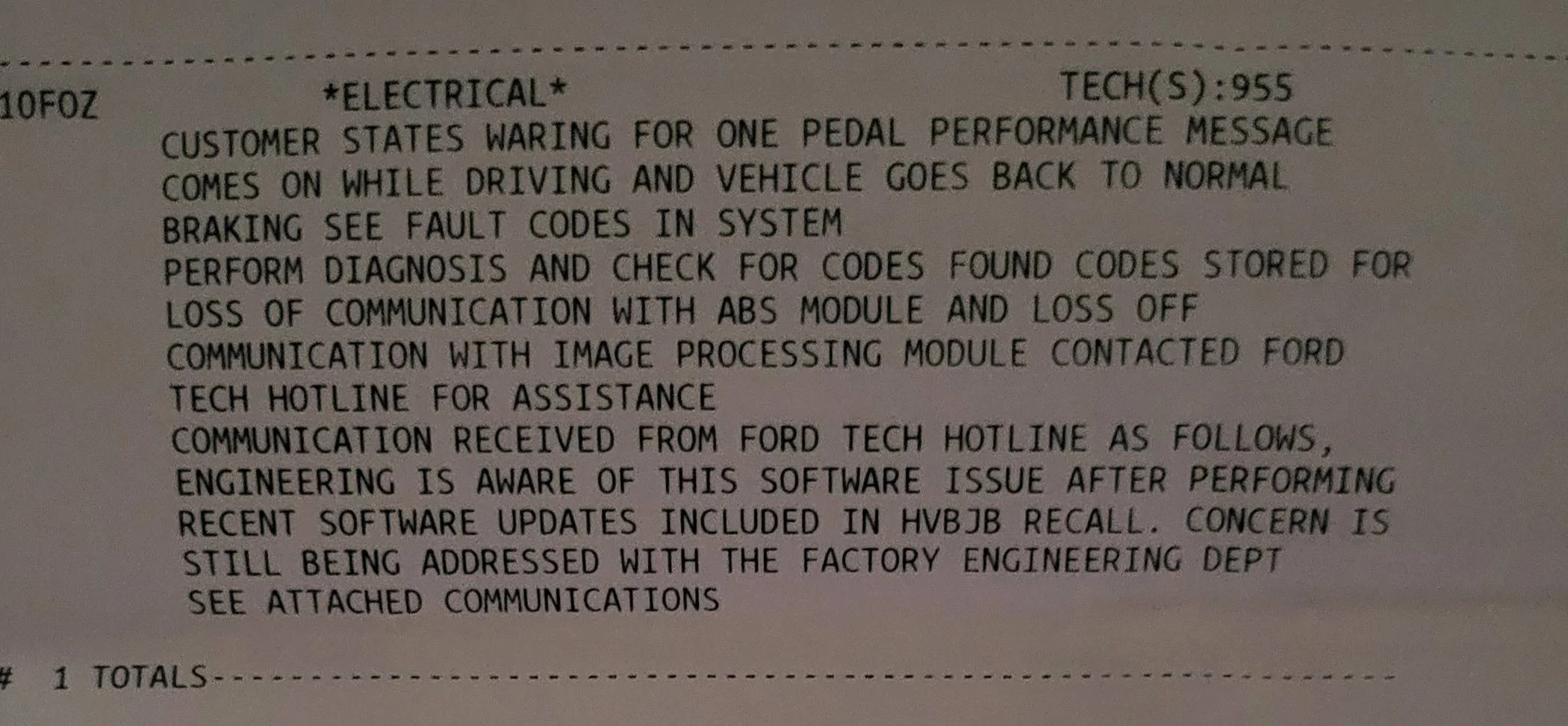

Classic description of a faulty auxiliary transmission pump in the 10r80.My F-150 has an annoying issue with auto hold where it sometimes... doesn't. The light comes on and the truck holds initially, but it kind of does this "bump" where it moves forward slightly at short intervals, like the auto hold is only barely holding and for a moment it lets go then holds again.
I found others that had this issue and it sounds like there may be weak pressure in some portion of the transmission that manages the auto hold (I always thought auto hold was your brakes but sounds like it may not be, I haven't looked into it further though).
It's the electric pump that takes over when ICE turns off. If it's faulty, it fails to keep adequate pressure on the clutch pack and the truck will move. It can be gentle or rather violent, depending.
