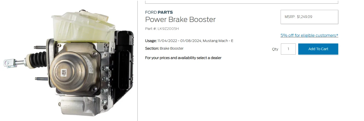

The entire regen / physical braking system is "fly-by-wire" - it's all controlled by software. The brake pedal is basically a dimmer switch.
Software will fix it, and I'm sure Ford is taking it seriously.
At least there is an easy workaround for now, but drivers need to be aware sooner rather than later.
Is it though? There's still a physical connection from the pedal to the brake booster. Now I can't see the internal workings and I'm not willing to take mine apart but I would assume that there is still a physical "master cylinder" with electric assist which also allows for electric override. I could be wrong and hopefully someone will point that out. My question is if you lose power to this unit would it behave like manual non power assist brakes? All the brakes aside form the parking brake are still hydraulic.
Yes, there is mechanical override at the end of the stroke.
Engineering Explained to the rescue!!
