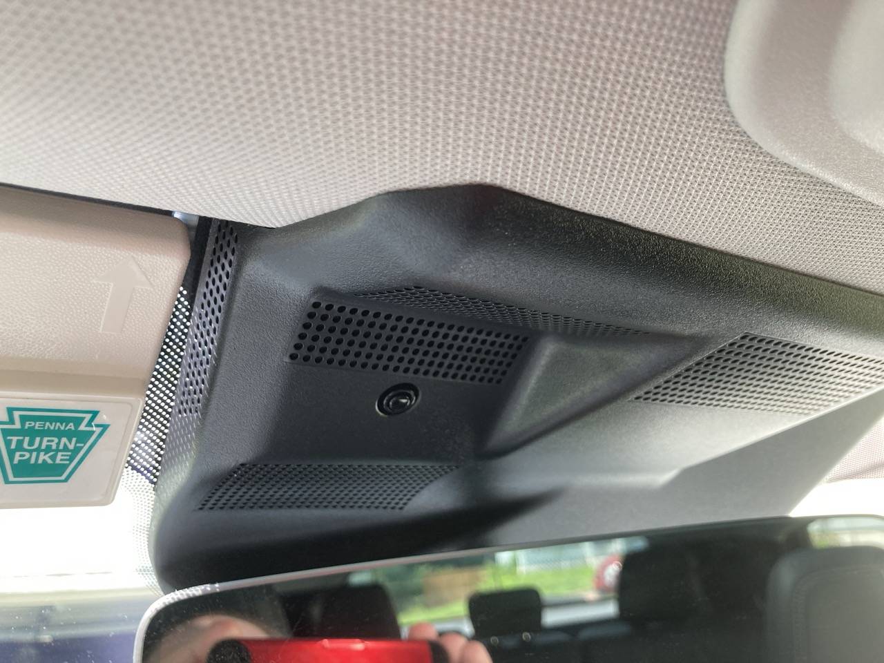

What is this button above the rear-view mirror?
vertov
Jason
Mar 30, 2022
Pennsylvania
Mustang Mach-E California Route 1
Ford Mustang Mach-E What is this button above the rear-view mirror? IMG_2683 Lar
I can not figure out what this is for and I dare not press it. It's a small black button directly behind the rear-view mirror on the roof. I have convinced my kid it's an eject button. I haven't found it in any manual and it's really hard to search for "what does this button do?"

I don't think it's an actual button, I think it might be a sensor or something or maybe just a cover for a mounting boss or something? I took that whole plastic dealy off at one point and forgot to look.
As far as your kiddo is concerned though, definitely an ejection seat.

interior sensors - not a button. ejector seat is SO much cooler though.

Just a guess - but I think it's a motion sensor for the security system.

That little black button looking thing is the In-Vehicle Temperature and Humidity Sensor. It contains both a thermistor for monitoring the cabin temperature and an element to monitor humidity to control the adjustment of the air inlet door (recirculating).

Interior temperature sensor (thermistor). Humidity sensor also in there behind the grille.

Not sure if you are joking or not, but it's not a camera. Lee and I above explained what it was. The camera you are referring to is the device that is just to the rear of the steering wheel in front of the IPC. It is looking at your eyes to make sure you are looking ahead while Blue Cruise is on.
