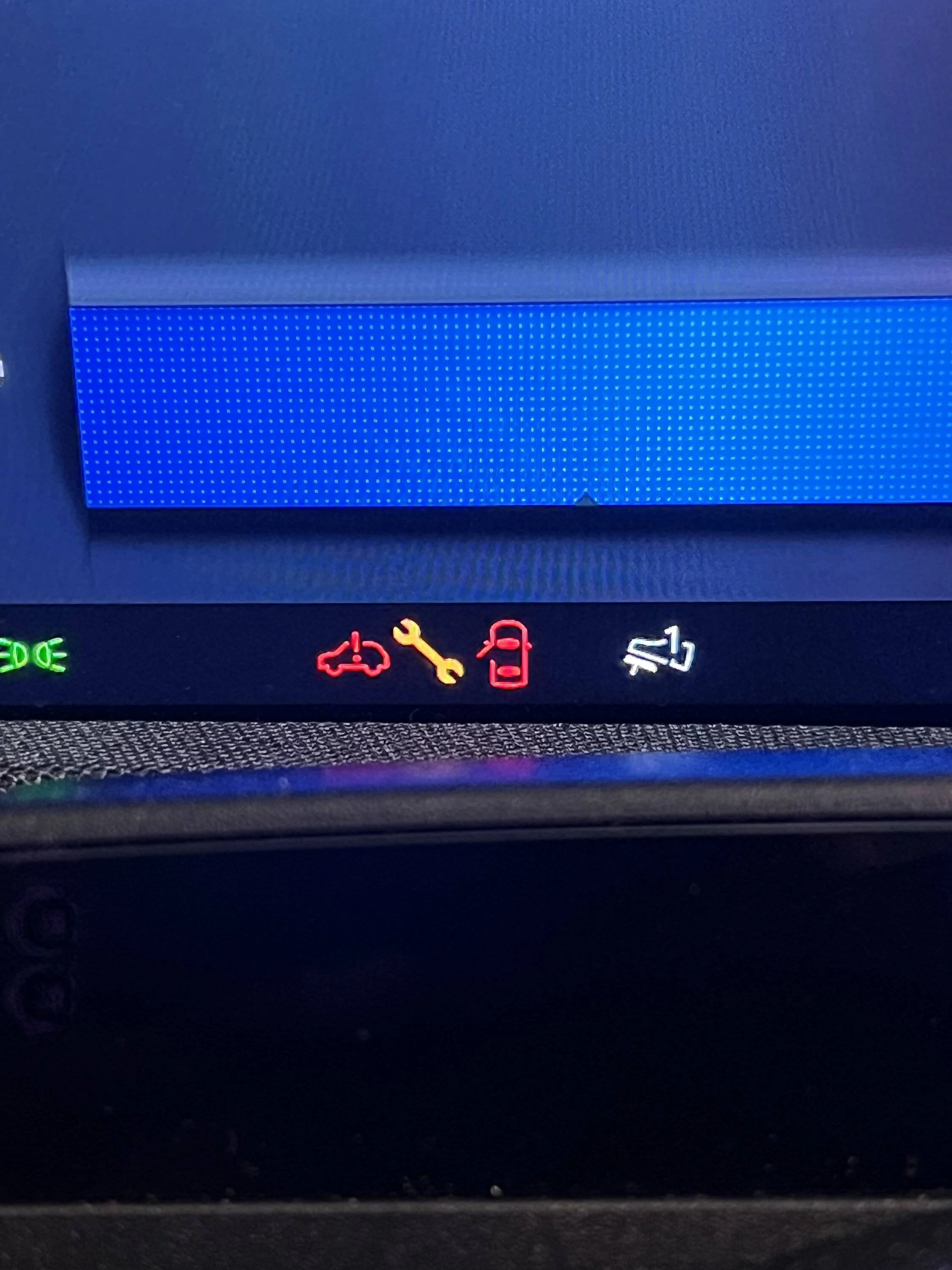

The light with the red car and exclamation point came on while driving. Can anyone tell me what it means. Thanks ??

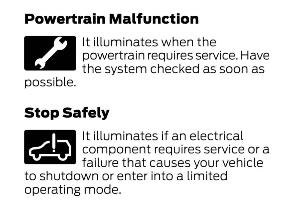

Restart the car and see what it says.
If it says “Service Vehicle Soon” and the car feels slower, then your HVBJB probably needs replacing.
