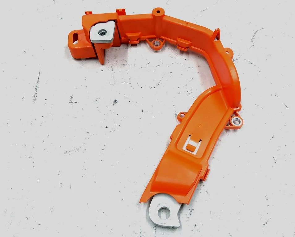

The exact measurements on the Mach-E are 20 x 3 mm. Based on sizing references (here's just one), that's good for about 325 amps continuous give or take. Good engineering practice says you shouldn't really exceed more than about 2x the continuous rating for decent thermal performance. Based on that, the bus bar for the GTs should have been thickened to around 20 x 5 mm to support about 500A continuous/1000A peak. The GTs should have had a beefier HVBJB than the non-GT models, but the busbar is the same size in GT and non-GT HVBJBs.
It's hard to tell, but the busbar in the model Y is thicker than the Mach-E. Probably 4 or 5 mm thick.
The Model Y Performance might have an even beefier junction box compared to the standard version, but I can't find anything on that.

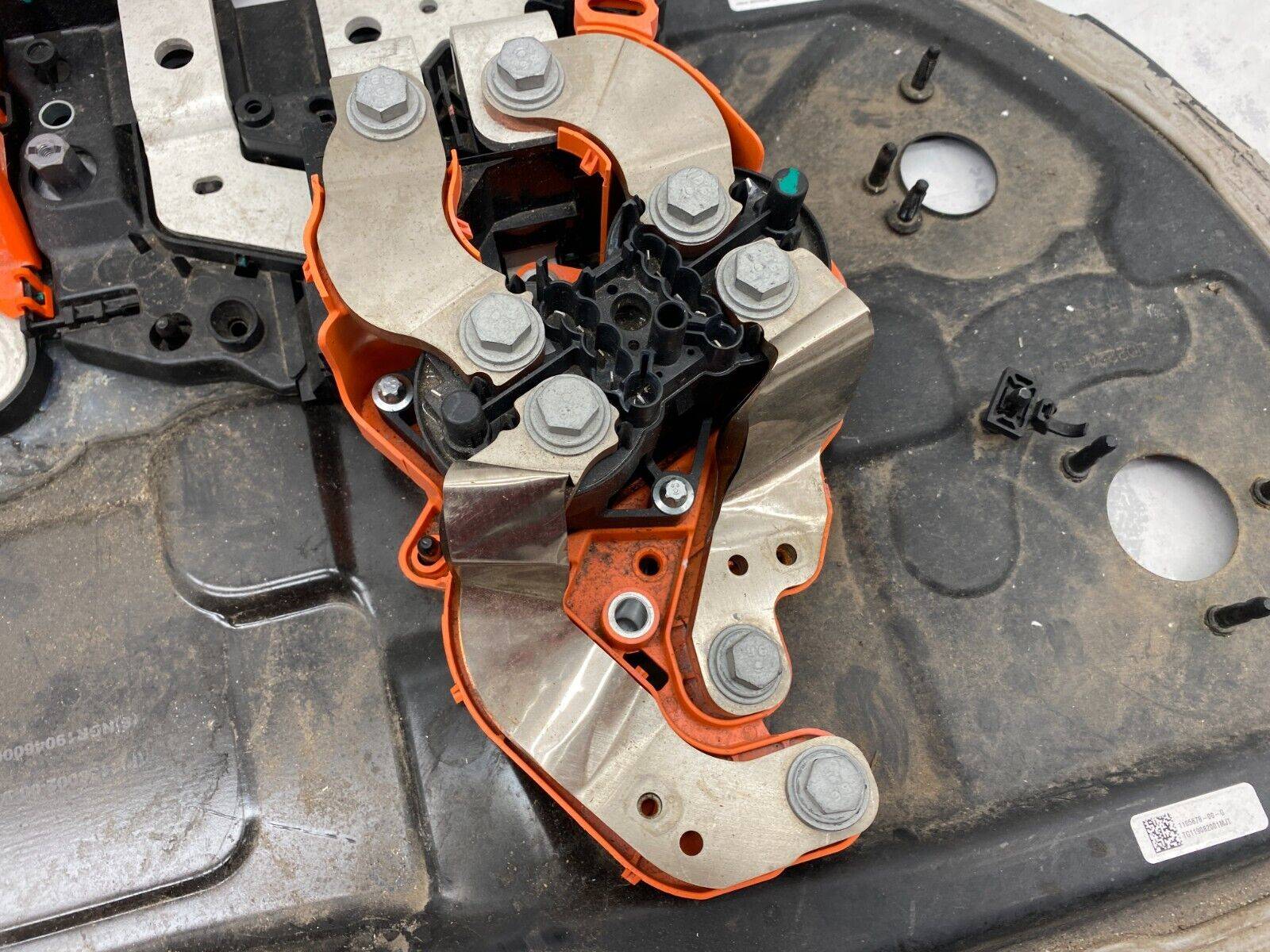

Here's some more pics of a model 3 penthouse from this eBay listing:
Ford Mustang Mach-E When or will GT/PE 5 Second limit be lifted by OTA s-l1600
The busbars at the top might be aluminum but they are thicker than 3 mm. The ones touching the contactors (black things) are copper covered with some kind of silver foil. But under that you can see they are THICK right next to the contactor, probably 7 mm thick if I had to guess. The use of copper and great thickness next to the contractors is for heat sinking (to help dissipate heat from the contactors). Again, this is much thicker and beefier than our 3mm bus plate. The greater thermal mass bolted to the Tesla contactors helps them perform for longer than the Mach-E.

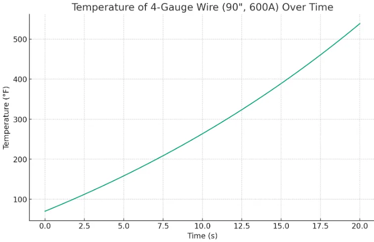

Ford does that often in the wrong areas. They need someone with a brain saying "no bean counters, you're not gimping that part". Calculating loads isn't rocket science. This is pretty common place. The calculations were what they were, and then they built dozens of test articles. Batteries can be tested on load simulators. There's nothing here that caught them by surprise except for the HVBJB.

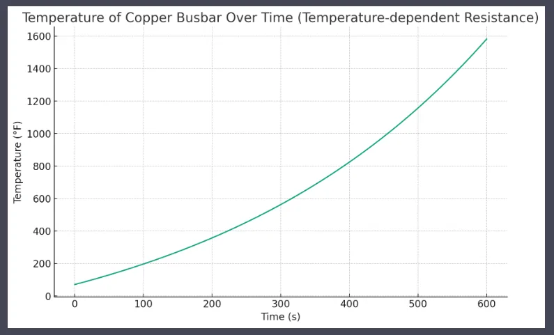

You can have chatGPT with advanced data analytics build these charts with ease. Here's a 20x3mm busbar at 18" long at 1000a taking thermal resistance into account. Starting temp is 70F.
Ford Mustang Mach-E When or will GT/PE 5 Second limit be lifted by OTA 1696137387663

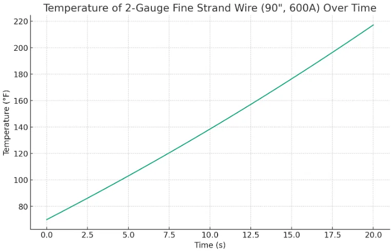

I don't think the limiting factor is the busbars, it appears to be the rear drive motor's feed. That appears to be at best around 2 gauge, and the numbers for it are bad. It's ~80" long in the battery and has another 18" or so before it goes into the inverter.
2ga wire, 90" long, 70f initial temp, 600 amps
Ford Mustang Mach-E When or will GT/PE 5 Second limit be lifted by OTA 1696140708634
Given the insulation used on these, I think the numbers look more like this
Ford Mustang Mach-E When or will GT/PE 5 Second limit be lifted by OTA 1696140910319
That's interesting, but there are a lot of variables that go into those calculations like ambient temp, insulation, wire orientation, spacing, convection, etc. Probably a ballpark but I don't really have confidence in ChatGPT to do proper engineering calculations yet.
I think the rear motor wires are bigger than 2 AWG, from photos it looks like the rear motor wires in the pack are 0.5" diameter externally which would translate to a 1/0 AWG EV wire. Probably 150ºC insulation.

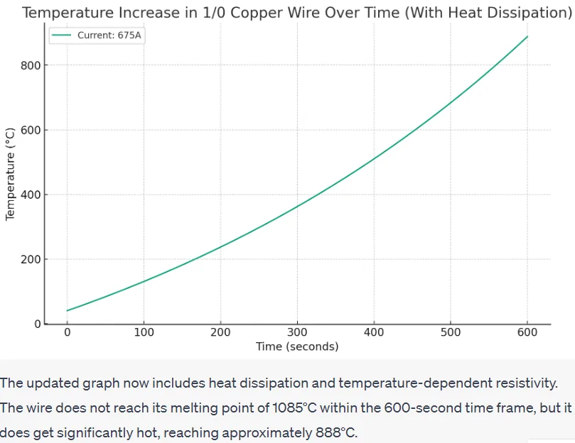

https://www.champcable.com/product/exrad-xle-1000-volt-cable/
^ In that case, the ampacity of 1/0 is listed as 339A in free air 40ºC.
See if you can run 1/0 in confined space 40ºC ambient 675A?
ChatGPT simply feeds the formula into code interpreter (now called data analytics). At first it wasn't taking into account thermal resistance values, the values are post thermal resistance instruction turning them into curves, not lines. By using it to check its work, it pans out. Don't use the base LLM to do calculations, have it write script then check its work. There's much more utility to be had with API access than just using the browser w/ plugins.
I'd have to get in the battery with my dial calipers to truly put the entire picture together. Given contactors are a failure point, it's safe to assume they're a weak link. The cabling cannot be overlooked. I've got cables from the hybrid F150, they've got 3 layers of insulation with a foil shield between them. 30% or more of the diameter you see is insulation, if even that little. My 2ga welding cable is larger than the battery's internal rear run based on weber auto's HVBJB removal vid (below)

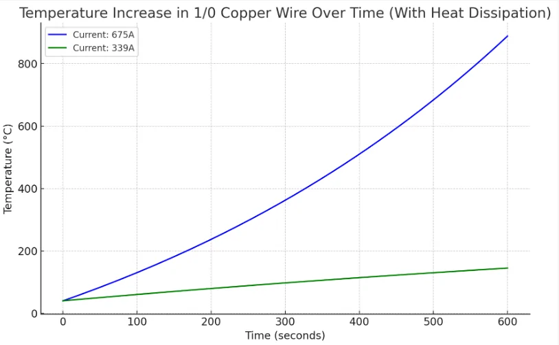

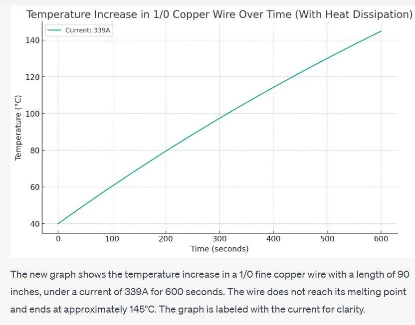

Here's your request...
Ford Mustang Mach-E When or will GT/PE 5 Second limit be lifted by OTA 1696156651398
And at its 339a rated capacity. Notice the curve shapes.
Ford Mustang Mach-E When or will GT/PE 5 Second limit be lifted by OTA 1696156819968
Just had it combine them.
Ford Mustang Mach-E When or will GT/PE 5 Second limit be lifted by OTA 1696157795566
