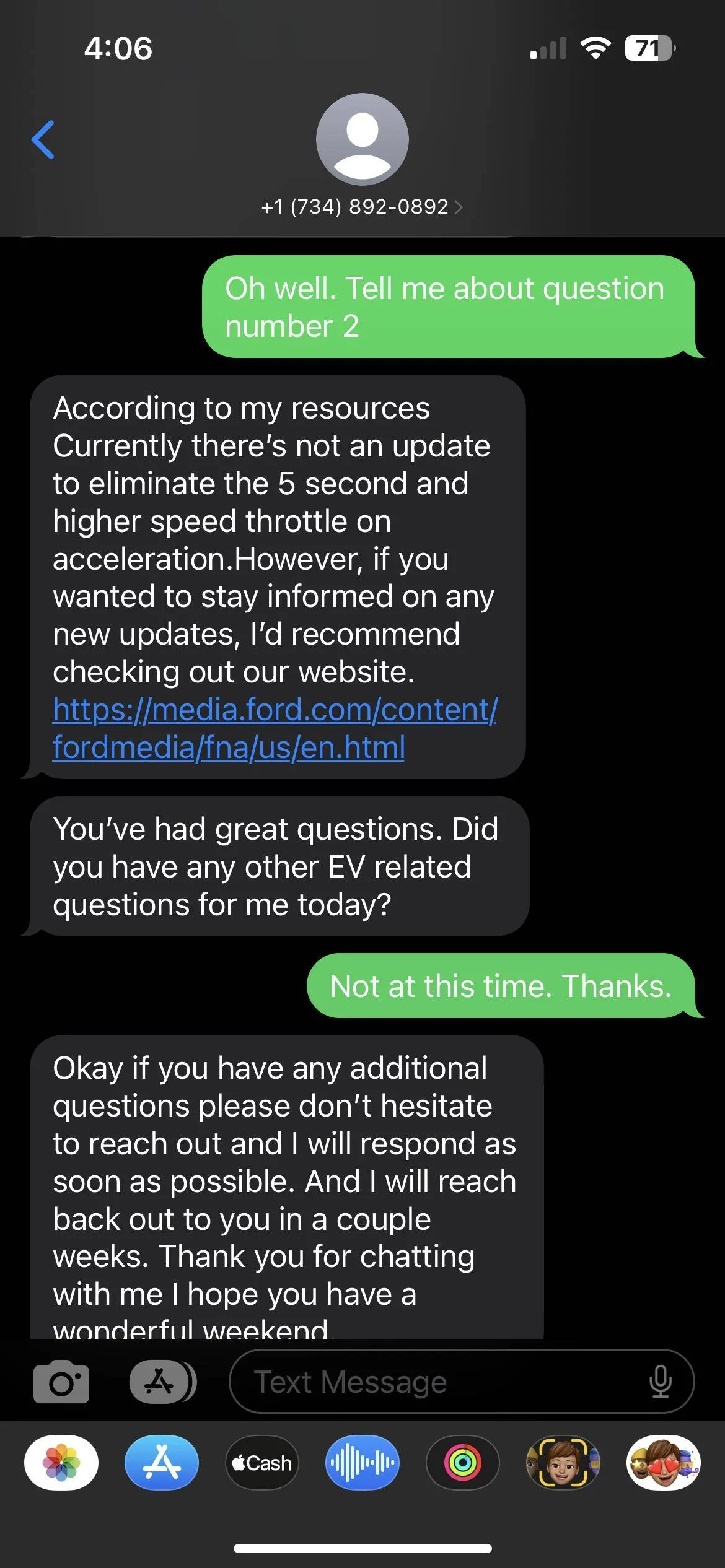

Texted with ford this morning. Definitely not indicating anything I’d coming any time soon.
Lol
Definitive answer……… from an AI bot.
You’re better off asking Siri or Alexa. Or looking in a fortune cookie or magic 8 ball.
