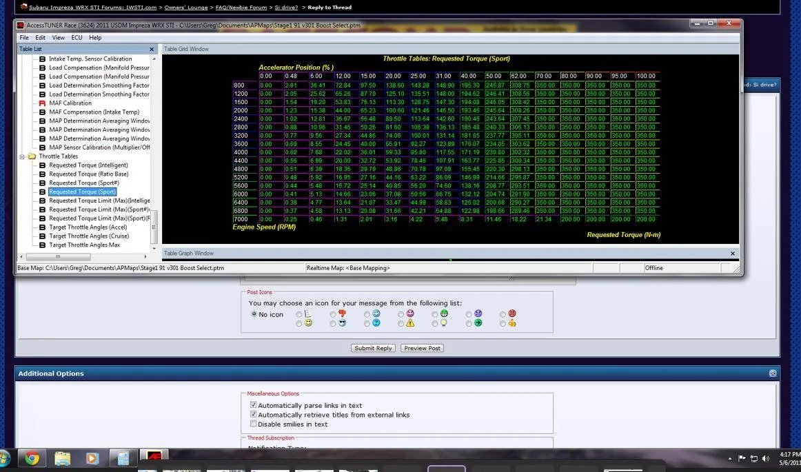

Can't speak to corvettes but my STI tunes were gear limited initially. These are my screen shots from a decade ago as I was tuning my '11 STI, so I don't have all the tables listed but based on requested torque targets, there were torque limits based on which drive mode you were in, as well as which gear. You wouldn't ever get full requested torque in first gear on the stock tune.
