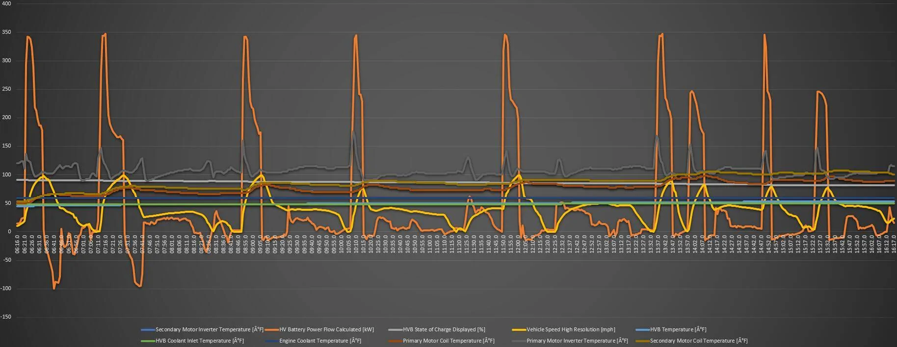

Outside temp is 42 Degrees. Car was parked in the garage plugged in. Did a remote start for 10 minutes before these runs. Power meter was showing 1 gray bar of limitation at the start, so Not 100% full power but close.
I did multiple runs, charted the SoC, Speed, Power flow, and every temp sensor I could find that would be related.
2 runs I didn't let the gray bars clear from the power meter. You can see those by being limited at around 200kWh.
The main thing I'm seeing is the primary inverter does shoot up in temp quite a bit, but drops back down almost as quick.

Also attaching the spreadsheet file of the data if anyone wants to investigate a bit closer.
I will do this again later, and hopefully I can get the car to not have any limitation on the power meter for the next runs. And I'll try and be a little more consistent on what speed I get to and How quick I slow down. And If someone has something they'd like me to try or add to the testing, just let me know.

Here you go.
very interesting that the Inverter temps may be the most reactive.... also a good thing for possible chiller since that's a lot less mass to keep cool than the entire battery tray
what I suggest, in the name of science, is to limit the number of sensor inputs now so you can hopefully get the time scale on the readings to several per second.
I'd suggest just the HV battery current (or kw), and the inverter temps starting 'cold' with no prewarming, and making a couple back to back runs to see if the time duration of full current accelleration is exactly 5 seconds, or is reduced as inverters/coolant warm up.
i.e. with no pre-conditioning/warming, and left outside overnight, everything might start off at 50 degrees, and then after a couple back to back runs the coolant inlet temp might be closer to 90 and not cool the inverter as well. The hypothesis would be the first runs would have longer run at full current if the system is based on temp rather than pure timer.

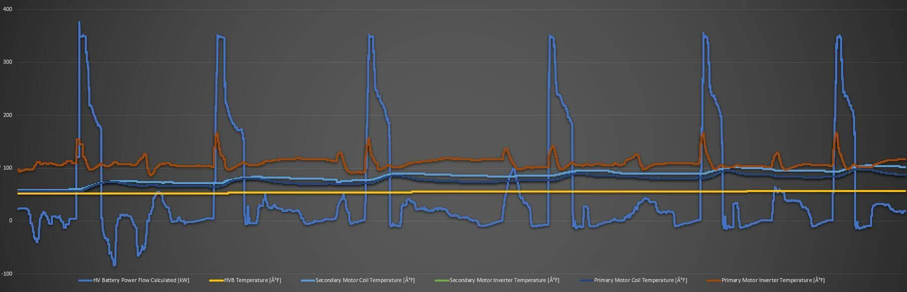

OK, another 6 runs today. Turned up the logging frequency. This was with no pre-conditioning. Car in the garage, started it up drove the 1 mile to a back road, and ran these pretty much back to back. Still had 1 gray bar of power limitation in the power meter. Haven't been able to get that to go away yet.

definitely doesn't look to be a battery temp issue unless that HVB Temp isn't an accurate sensor.
So it looks like the inverter temp spikes but only for literally a second or two and starts cooling off even while at full throttle?
Battery temps seem quite stable and in safe ranges.
The battery power output almost reads exactly like what I expect a Dyno would read.
350 kw for a few seconds (470hp)
Drops to 225 kw after 5 seconds (300 hp)
And slides to 175 kw by the end of the run (235 hp)
What speed were you going at the end of each run and about how long (time in seconds)?
Looks like it loses around 100 kw (135hp) minimum after the 5 seconds based on those runs.
I think all these runs ended with me hitting between 95-100mph
Also 1 request: please try easing into the throttle instead of stabbing it. I’m curious if the inverter temp won’t spike that way and if the drop in power is less severe. My car feels faster easing into it vs stabbing for some reason.
I will try that tomorrow. I also want to try a few runs in unbridled extend just to see what those look like.
Just based on what I'm seeing, its looking more and more like its just a timed limitation over an actual sensor based limitation at this point.
