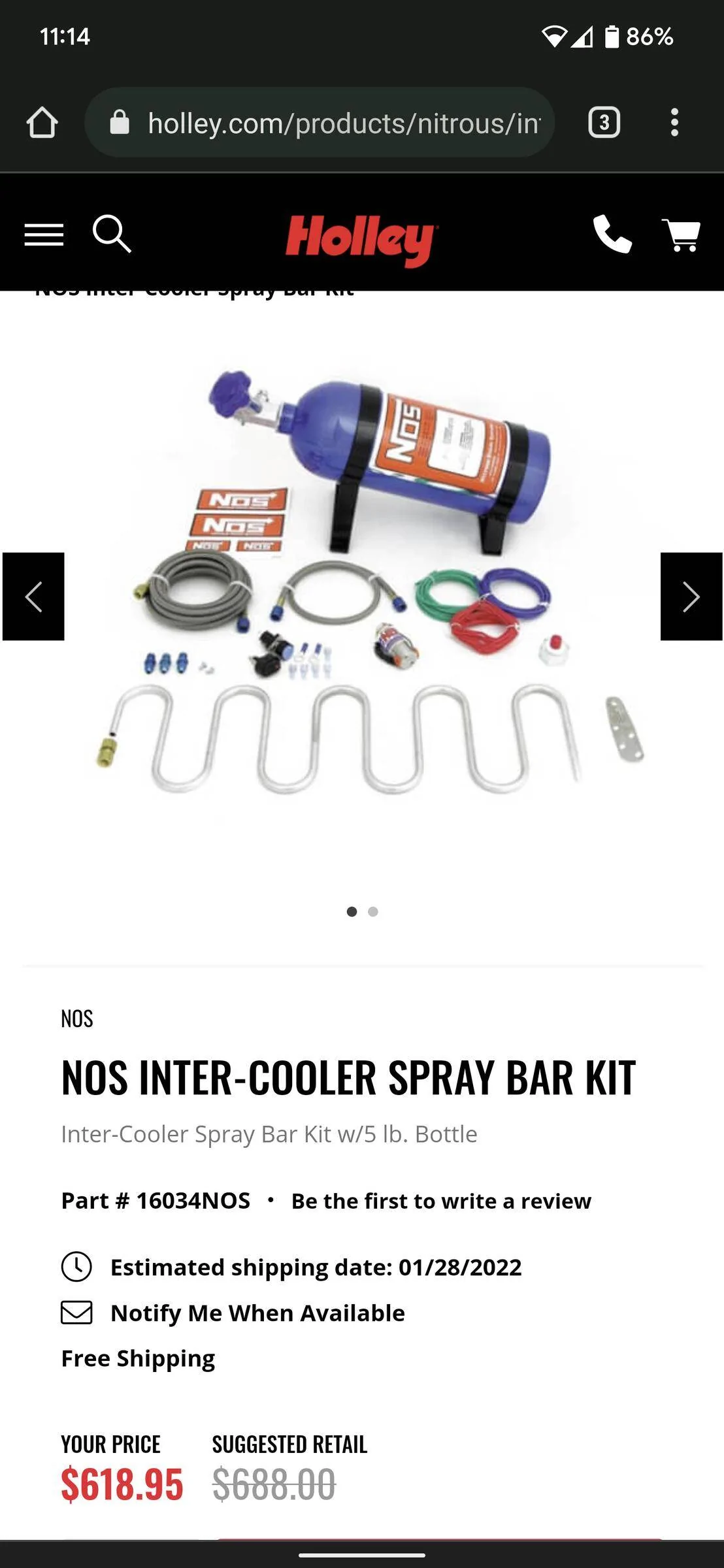

I keep waiting for one of the 5 second complainers to try a mod to flash-cool the battery/inverter/motor coolant loop and report results. Could be as simple as rigging a fire extinguisher in front of the radiator and bleeding some CO2 thru it prior/during a drag run.
If that buys more than 5 seconds at 100% current, and more 'long term' mod could be to pull the frunk and add an electric chiller (heat pump) and inline heat exchanger to chill the coolant loop.
Just get like 4 tanks in parallel give u more time. ?
