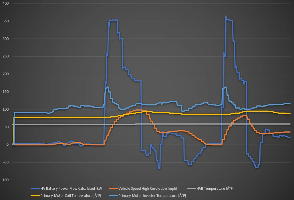

Had the chance to do 2 runs with no gray bars tonight. Also have updated my car with the newest updates with FDRS. Not sure if that changed power delivery at all. but wanted to note it.
