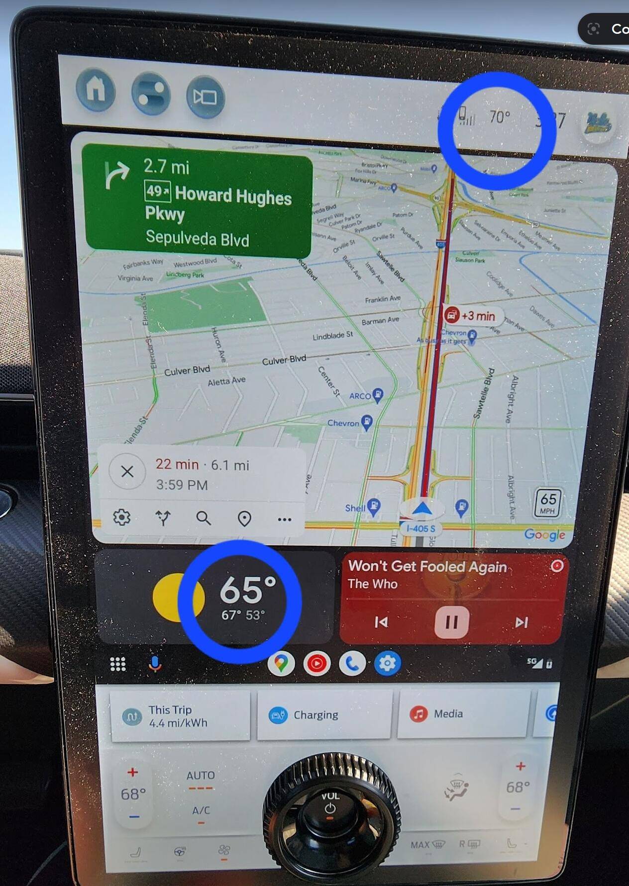

Here's a pet peeve of mine. Look at the two temperatures in the screenshot. This is Android Auto. The tiny temperature in the upper right is the correct temperature. The LARGE one on the bottom left is incorrect. While it's not dramatic in the photo, sometimes it's a big difference. Yesterday I was in the San Fernando Valley and the small one said 89 degrees and the bottom left one said 67. I was outside and I can tell you for sure that it was 89. Whats more the bottom left showed that the day's high would be 72 and the low 51. Clearly just wrong.
Look at the AC setting. I had it turned down to 68 because it was friggin' hot out!
Even more confusing is that if I ask Google for the weather it comes up with a third temp not matching either of the ones on the display. This implies that the bottom left temp isn't coming from Google.
The car is now being ridiculed by my passengers for its blatant inaccuracies. I wish there was a way to turn the bottom temp screen completely off. I'd rather have no information instead of wrong information.
