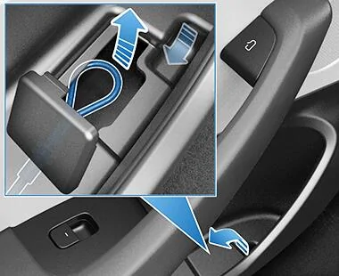

I read a recent news article about Tesla that caught fire after an accident. The doors couldn't be opened because they required the battery to work, and people died. Will a Mach-e door open without the battery? From what I read the Tesla doors have a separate latch which is difficult to find.
it is hidden... right where your fingers go.
I notice you didn't show the stupid, stupid rear door design where you have to release the hidden latch to then pull on a loop? What the hell?

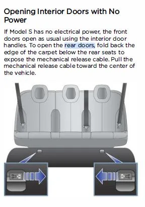

Or this beautiful design decision:
Ford Mustang Mach-E Will the doors open without power? tesla really dum
You read that right; FOLD BACK THE EDGE OF THE CARPET, WHICH IS WHERE YOU WOULD OF COURSE EXPECT TO FIND A DOOR HANDLE!
As I understand it, our front latches will mechanically open if we pull the level far enough back...
But our rear doors don't even have a HIDDEN mechanical means of opening.
Even WORSE than the Tesla. Someone correct me if I'm wrong.
