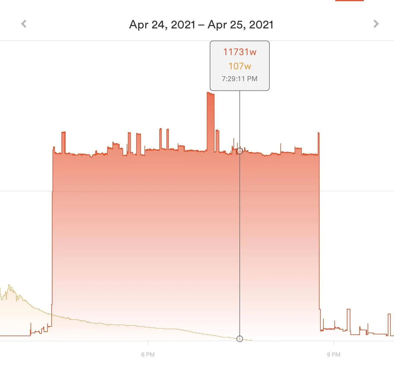

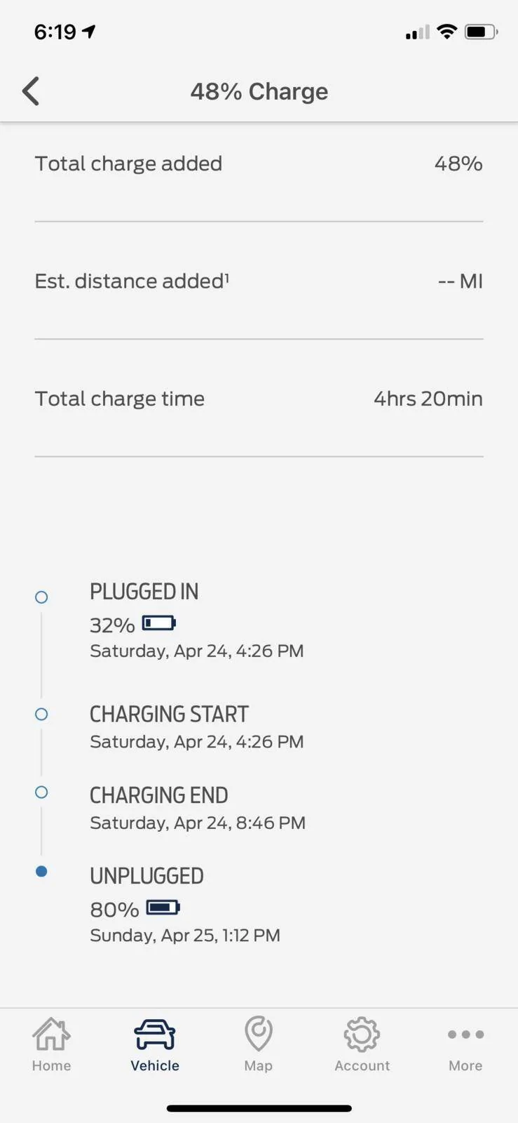

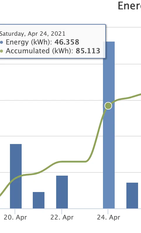

Oh, which brings up a secondary question. In the FordPass charging log, does anyone know if the “energy” it reports is kWh from the wall, or kWh into the pack?
(aside, I actually need to drop the rear belly pan, because a tab is out; maybe there is a label somewhere on the side of the battery. Do folks drop that pan for the rear hitch install? Are there any battery labels on the battery pack back there?)
So, here is as close as I can get with an anecdotal example - On April 24 I got home needing 48% charge to get back to 80%. FordPass says I took on 42.24 kW-hr over 4 hours 20 minutes. My chargepoint flex is 11 kW. So, that would mean about 47.6 kW-hr dispensed. Chargepoint App says I dispensed 46.358 kW-hr (I think it actually runs at ~10.7 kW with MME which is 46.3 kW-hr). At least for this single example, it seems that FordPass might be reporting actual energy received either at MME charger input, or to the battery itself after some losses. Here are the various screens, including my whole home monitor, which may have some additional info (TBD, it includes all home loads in the graph):
So, this method seems to work okay - 48% of 88 kW-hr is about 42 KW-hr,
and 48% of 68 kW-hr is about 32 kW-hr (so I do not have the smaller 68 kW-hr battery :) )

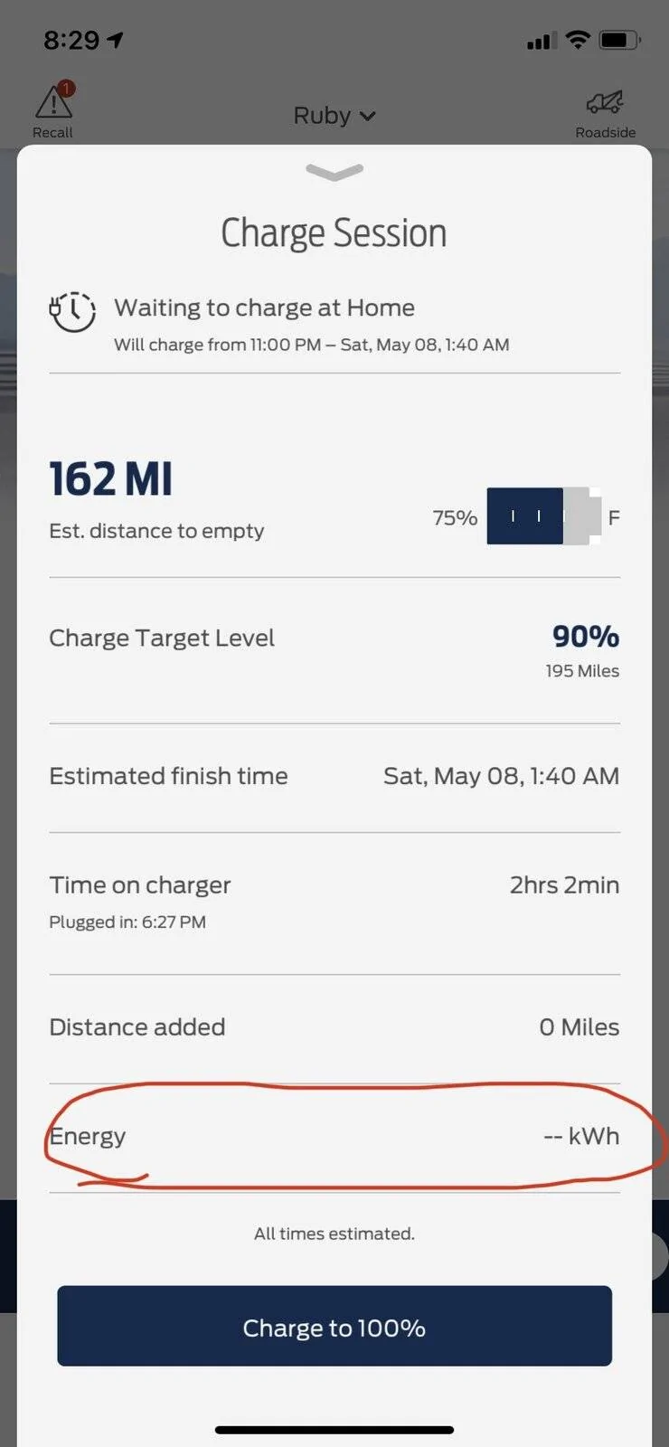

If you go to the details of a current charging session, FordPass will show total kWh added so far. The battery logs do not. But a current charge session will. (At least on iOS)

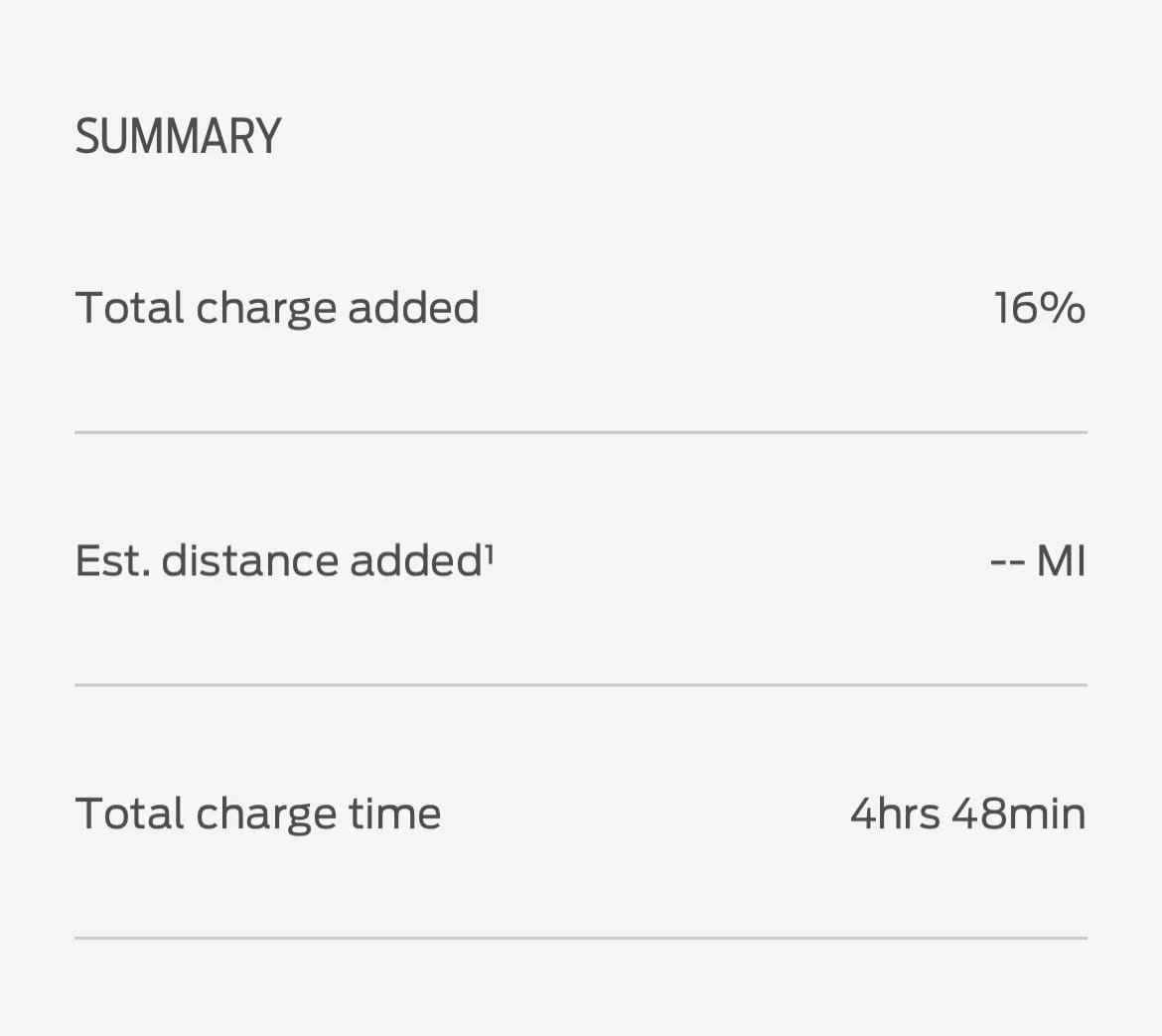

frustrating the Ford app charging log only goes by “miles added”, and doesn’t give the starting and ending percentages
It doesn't??? Mine does:
Ford Mustang Mach-E Wrong Battery Pack? Screenshot_20210511-181320_FordPass
