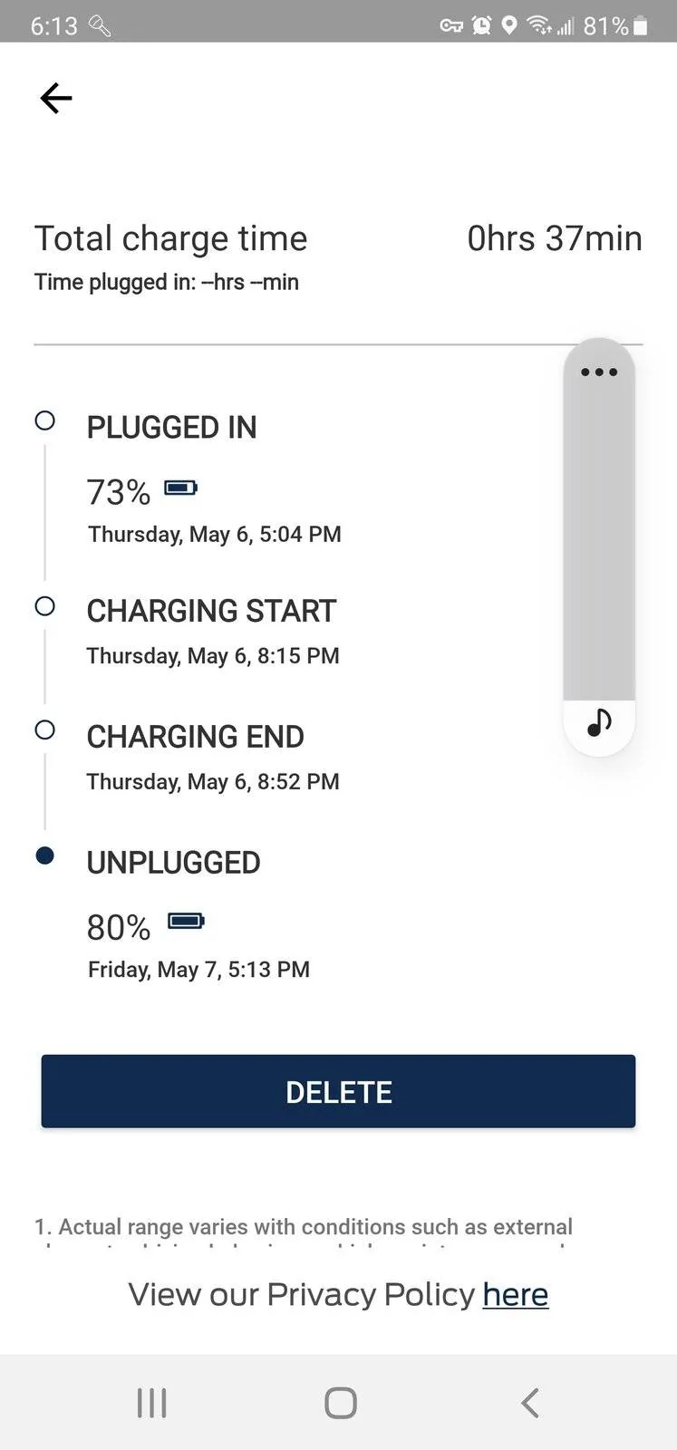

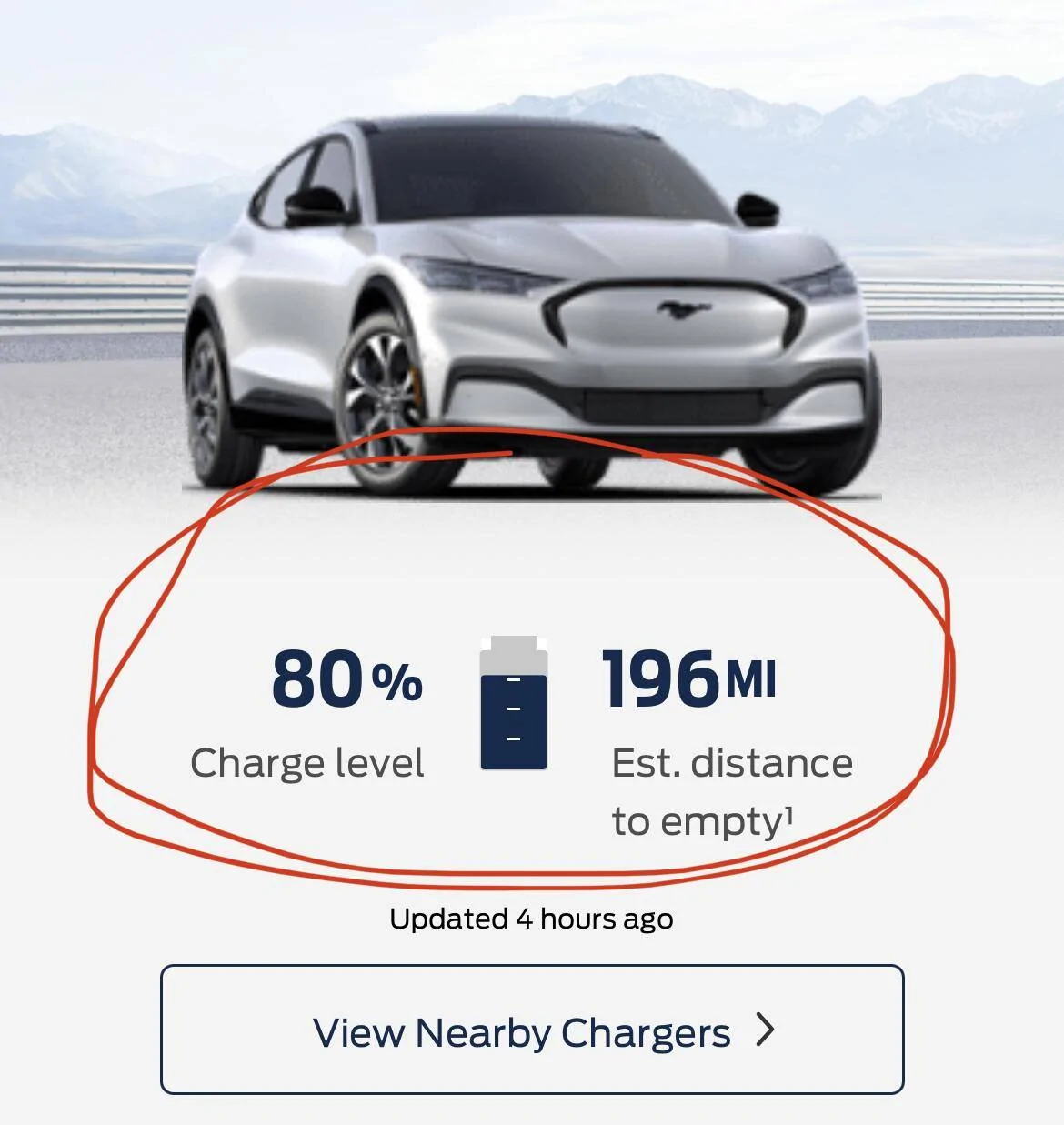

So, I’ve been frustrated by the low range estimate on my Mach-E4X. It’s been way off since I bought it, but because everyone says that it adjusts over time and takes a while, I’ve been patient. But I’m growing weary. Here’s where I am at:
I bought it with 17 miles and reset the driving history and trip meters at around 50. That reset the GOM to about 210 miles. I’ve now put over 1,000 miles on it, and my trip meter says I’ve averaged 3.5 mi/kWhr over those 1000 miles. BUT the highest extrapolated range I’ve ever seen is 245 miles.
if I believe Ford’s EPA estimate on the AWD with 68kWhr standard pack, you’d need to get about 3.1 mi/kWhr to hit 210 miles, and an average of 3.5 mi/kWhr is 238 miles, which is suspiciously close to the figure my car has been reporting all along, and nowhere near the 308 it should be getting if I really did use 88 kWhr at an average of 3.5.
I know everyone says it takes a while to “learn,” but over how long? If 1,000 miles isn’t enough, what is?
So is it possible my car either has the wrong battery pack installed, or is misconfigured to believe it does? Is there any way to check what the vehicle reports it has for the pack or total capacity?
196 at 80% is 240 at 100%
You're having 88kwh.

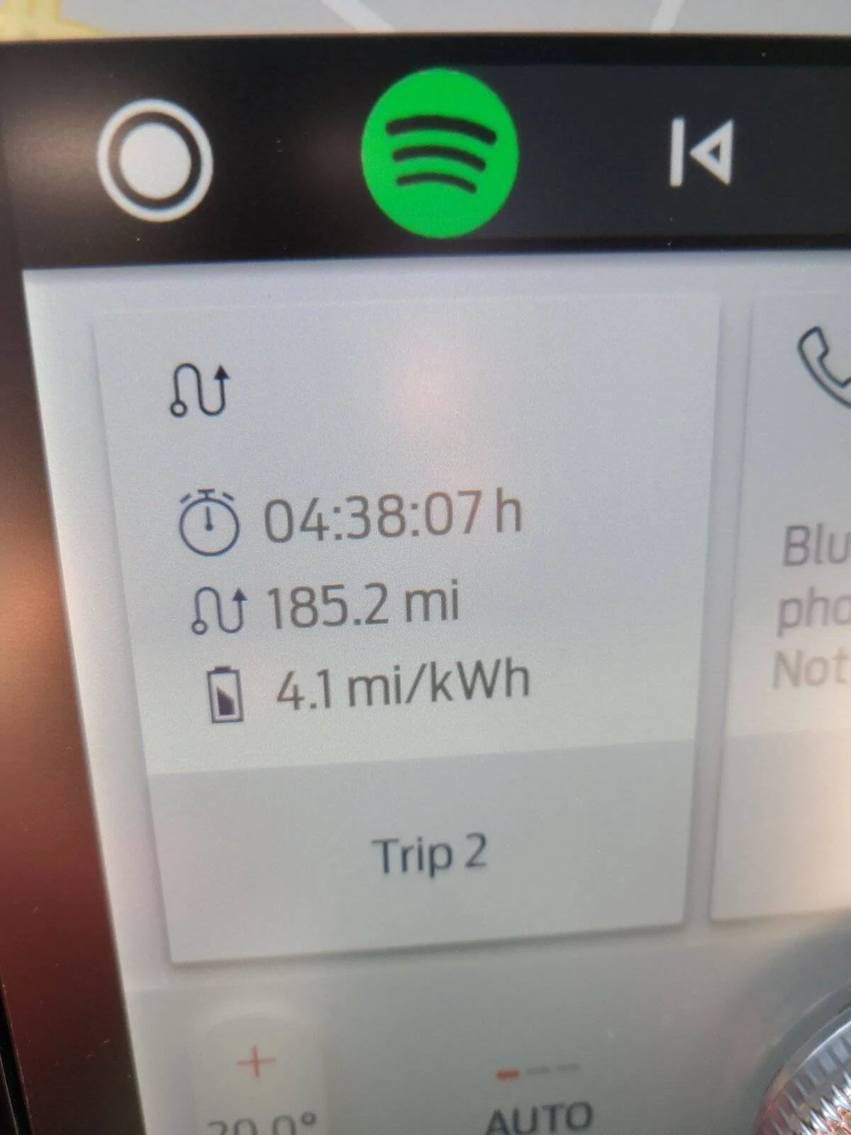

I just did 185 miles and used only 50% , but my gom shows 50% less and can only do 127 more.
Your 196mi at 80% extrapolates to 245 miles. Thats not far off of your car's expected 270 mile range.
Yes the 245 is what I stated in my original post. Again, the reason for my questioning is because the “expected range” is derived based on an average of 3.1 mi/kWhr. However I have averaged 3.5 over the last 1,000 miles (according to the car’s trip meter), and it’s still projecting 245. And 3.5mi/kWhr x 68kWhr (smaller battery pack) = 238 miles. So after 1,000 miles, my car is still reporting *exactly* what the smaller pack should be if it were indeed using its own reported 1,000 mile average of 3.5 . THAT is why this question came up.
So either it’s using ≈2.8 as the basis for the GOM (which believe it or not still seems possible based on some rough charging calculations) , or it’s calculating that GOM based on 68kWhr pack.
