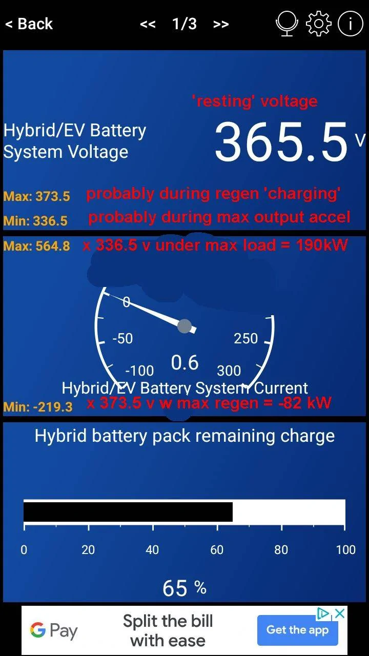

Is there any way to check what the vehicle reports it has for the pack or total capacity?
You might consider getting a ODB2 reader (<$40), the CarScanner (free) app, and take a look at all the available sensors. I don't recall one displaying kWhr directly, but there is HV voltage.
at rest with 60-70% SOC, the SR battery pack will display right around 365 volts
the EX pack will be higher because the cells are in a different configuration

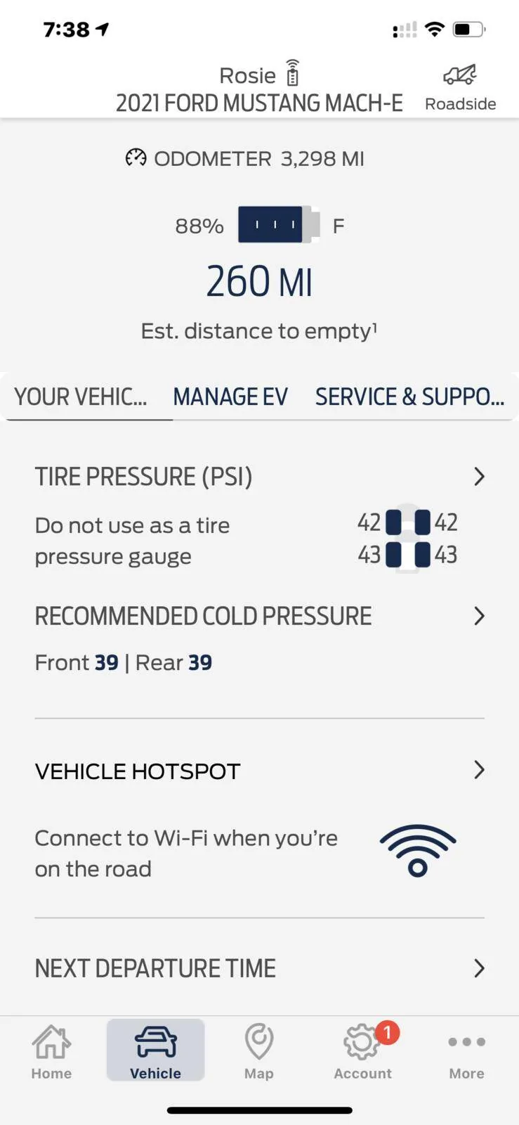

Yesterday morning (E4X):
Ford Mustang Mach-E Wrong Battery Pack? 184E02DF-CCFB-4EA6-9F4D-224352131A4E

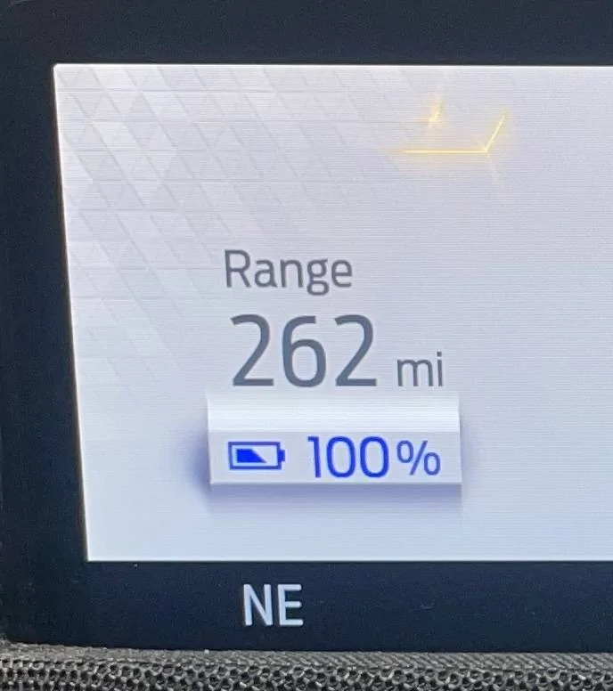

I've never seen 230 on full range in SR.
200 miles is probably the maximum estimated range I've seen on 100% charge. I have over 1000 miles on the car.
I've seen 226 on mine at least once.
