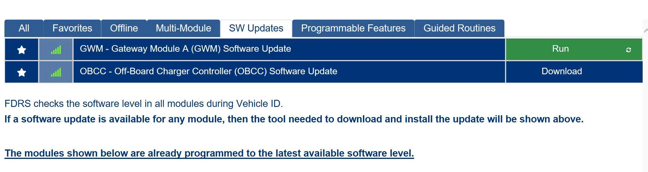

Preface: These updates are being performed by the few of us that have FDRS and are not available via OTA at this time. Your dealer will not update these on the car for free because there is no Customer Satisfaction Program, recall or TSB as of today. I'm sure you could pay them to do the updates, but that's at your discretion. I'm sure they will eventually be OTA.
What's happening:
There's a Gateway Module Update, which hopefully fixes some bugs on Job2 vehicles. I'm going to flash it right now and let you all know. Thanks to @WyldStallyn for pointing out that there's also an OBCC update released on 06/21 in addition to the 06/20 release of the GWM. Thanks to @generaltso for pointing out that the OBCC is also for job1.
Warning: The GWM update requires a USB drive. This update is quite large.
For errors on failed updates see troubleshooting in posts 87 & 88 of this thread.
Update: 06/22/22 - GWM is now available to update in FDRS after it was broken for a couple days
OBCC installs just fine and is about a 5 minute install.
What specifically do these updates do: - The GWM update resolved issues that I had regarding missing data being sent to Ford and FordPass. I'm not sure what else it does, but it's a large update.
The OBCC update could have some minor changes to charging. Nothing is confirmed as of 06/22/22. That discussion is on page 5.

Because Ford wants to "F" with me today, I cannot update the module at this time.
