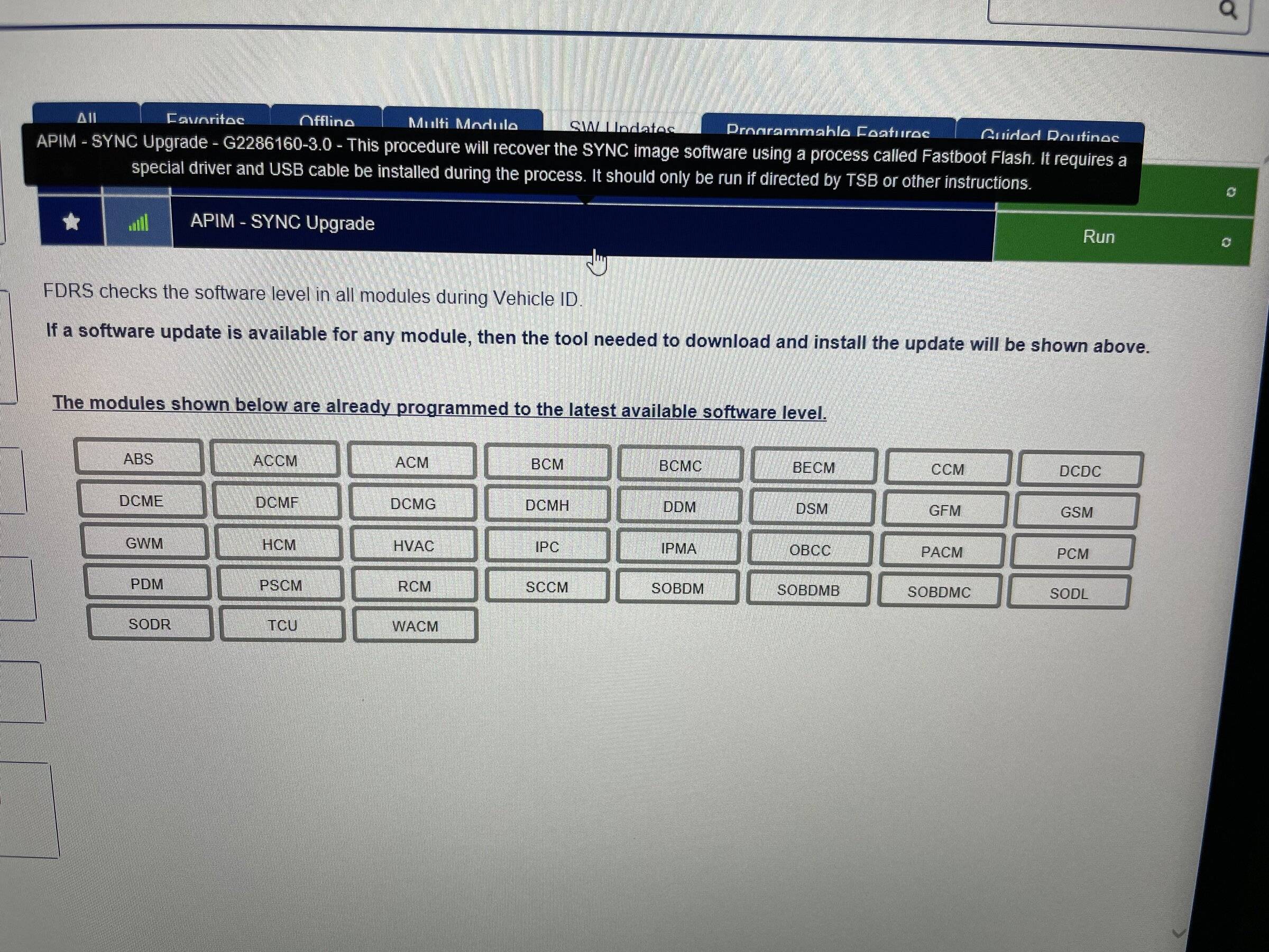

I’m only getting offered the 2 APIMs again. You can see in the black bubble regarding the cable. Fast boot flash is something I’ve seen with android but not sync.
I was not careful enough to see the hover over, I get the same message. I will be more careful in the future read those hover over messages, and to look for "only if directed". Too bad, I thought everything on our custom VIN page was already tailored to our VIN.
I wonder if "recover the Sync image software" should be under tools, not SW Updates? I bet all of this was a Friday snafu and that it will get fixed by mid week.

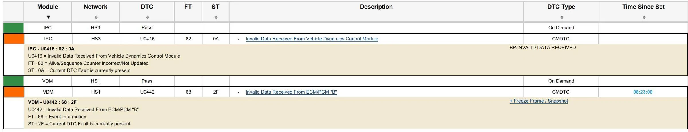

@DevSecOps do you have an IPC code for invalid data received from VDM and a VDM code for invalid data received from ECM/PCM B? Also do you now have a traction control option on the touchscreen that doesn't work?
Yes Sir:

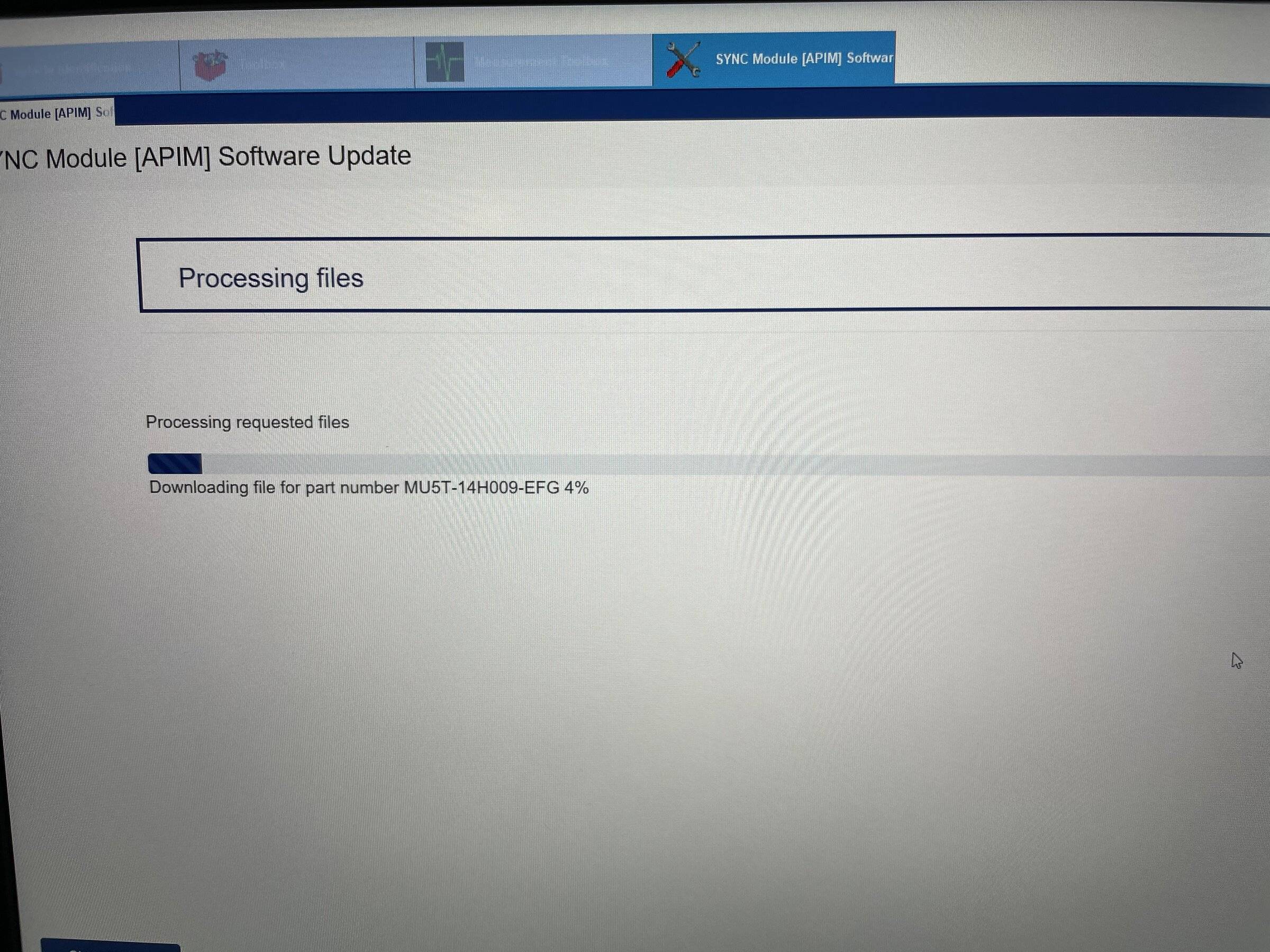

Trying to update my APIM but getting a message saying cannot download binary. Trying again

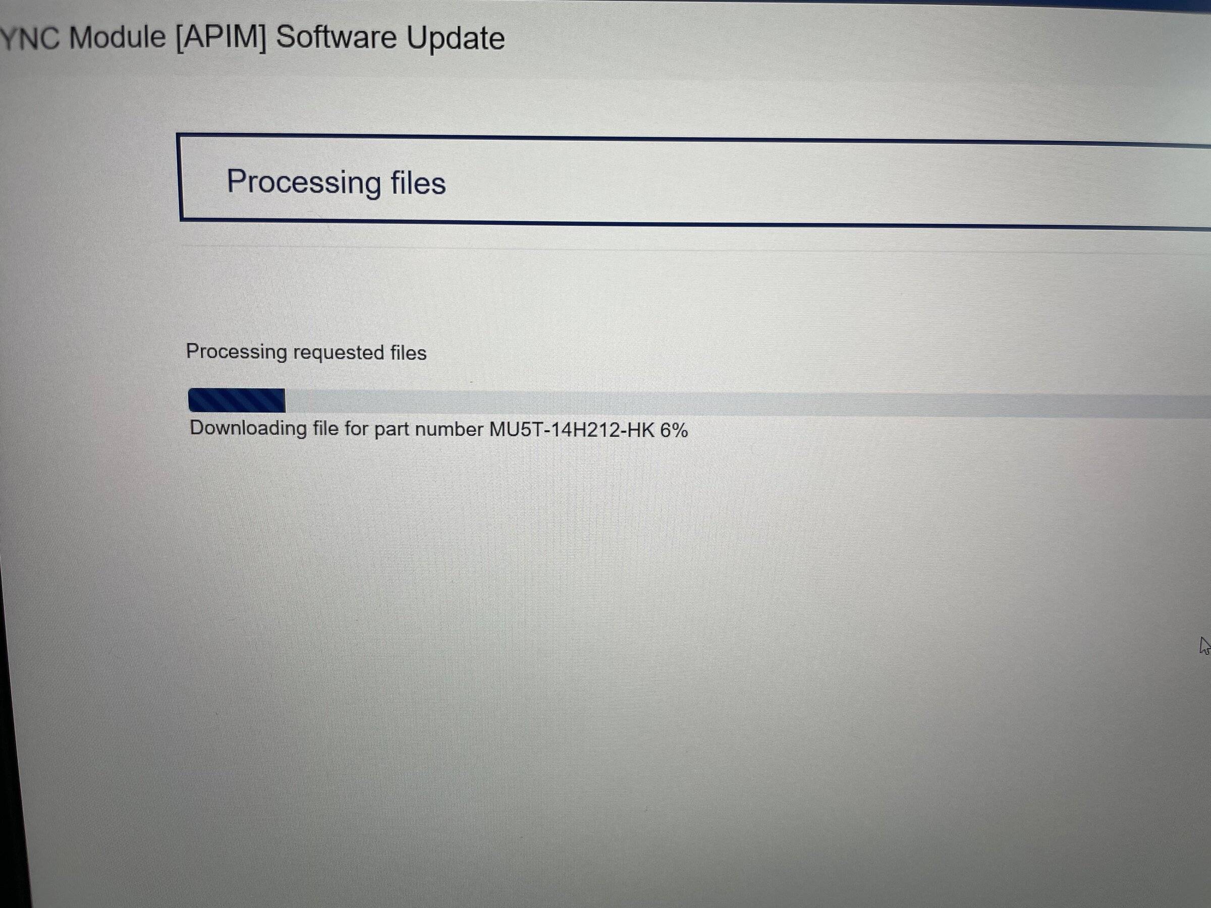

ProximusAl
May 27, 2021
674
707
UK
Mach-E - SR-AWD - Star White
Next one…getting there..24 mins so far

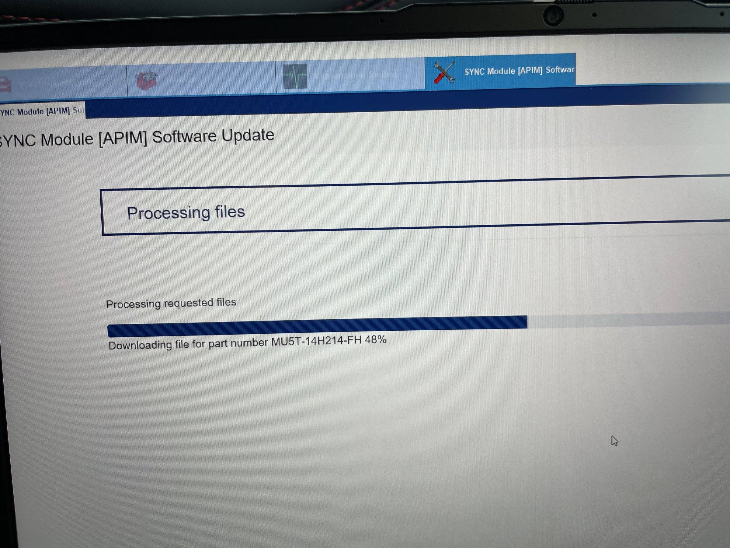

ProximusAl
May 27, 2021
674
707
UK
This one keeps flicking between obtaining software and this
