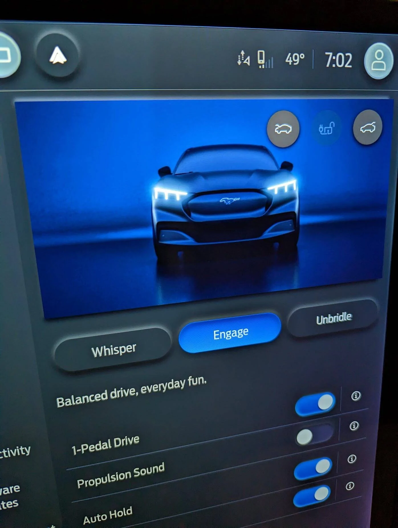

Same situation for my Job 1 car. Got 21P22 late (October) and the door code "trick" works. I don't have the option through the main screen, though.
TBH, I am not sure if the frunk code option was enabled via 21P22 or an OTA update. I happened to try it after 21P22, but no idea when it actually started working.
I too had 21P22 done very late and was nice to my service advisor. He bought his dealer's demo car and told me he had done every update. I told him he should be able to open the frunk from the door. He didn't believe me until we walked out to his car and he entered the code, pushed the buttons and....ker-chunk his frunk opened! I got an enthusiastic, "Holy sh!t!" out of him. :)
Lo-and-behold, when they were done doing 21P22, the door trick worked for me, too.
Then I did a little FORscanning....and even after the 4.1.2, I have this:
Ford Mustang Mach-E 4.1.2 Dissappintment 1672978307647
