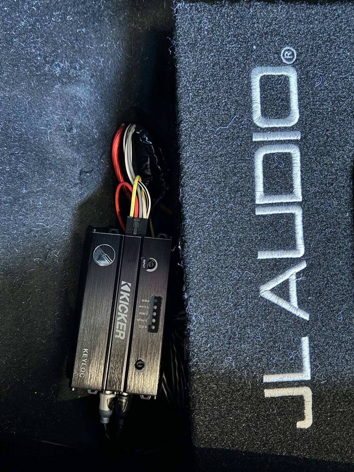

UPDATE 04/07/24:
Three years ago, I started this thread after installing the JL Audio 10” sub enclosure with built in amp in my Premium. It’s a great little sub and because it has a built in amp, it’s a bit easier to install. This sub allows the cargo floor to be in the upper or lower position.
A month or so later, I replaced it with their 12” version. Because of the taller height, you must keep the cargo floor in the upper position. I upgraded to the 12” version not because I needed more output (it has more than enough for this system), but because the lower end was kind of lacking. It depends on the genre of music one listens to, but many find the OEM sub to be all they need (I don’t see how when it barely puts out any low end bass) while others want that lower end that they are missing in their music or use to it from their high end home system.
I’v had my GT now for 2+ years and have the same JL 12” Sub as I had in the Premium and while it works well, have never been completely satisfied with the lack of very low end bass. I get reminded of this every time I drive my ICE Mustang which has the same JL 12” sub. The bass in that car goes very low and sounds more dynamic. After doing some research I found that the B&O DSP/Amp in the Mach-E has a steep rolloff starting at 35Hz. Not only that, but starting at 14 on the volume control, the level of the audio signal going to the OEM sub no longer matches that of the other speakers and is somewhat attenuated.
In order to fix both of these issues I need to do two things. One, install a device that removes the rolloff and restores the low end bass and Two, grab the audio signal for the JL amp from some where other than the OEM sub wiring.
After reading online and talking to one of my friends that owns an auto stereo store, the best device (which also happens to be the least expensive) is the Kicker KeyLoc DSP/LOC. This little device analyzes the heavily EQ’d audio signal coming from the B&O amp and makes it flat across the entire band within 1.5dB. This is exactly what I was looking for. It is only a two channel device which is perfect since I’m only working with the sub. There are many other companies that make these devices like JL Audio and Audio Controls which have many more channels to correct your entire system but the sub is only one channel. Besides, if I wanted to correct the entire system and make it flat, I can easily do that using FORScan (free) but I would only be doing this if I replaced all the speakers and I’m not going that far with this car. As a side note, I did add a small JL Audio 200W RMS (50W RMS x4) amp after the B&O to provide 50W for each door which really woke up the B&O speakers. Much better dynamics and punchier mid-bass.
Installing the Kicker KeyLoc was fairly easy. Originally I had used the audio signal from the OEM sub to the input of the JL sub amp but since this signal becomes attenuated above 14 on the volume control, I needed to tap into the wires going to the front door speakers coming from the B&O amp. The wires are LF White +, White/Brown - and RF White/Violet +. White/Orange -. I ran those into the KeyLoc and started its setup process. You need to download three audio files from Kicker. One file tests for proper input gain, another for noise floor and the last analyzes the frequencies and flattens out the incoming signal. The KeyLoc has RCA outputs that plug right into the JL sub amp. After it had completed its setup, it is very easy to hear the difference because you can easily turn the EQ of the KeyLoc on and off. Turning on the “flat” setting on the KeyLoc instantly brought back that nice low end bass I was missing. I am very very happy with the bass in the car now. I want to say again, this might NOT be something you will want to do depending on the type of music you listen to. If you are happy with the bass that you have now with whatever aftermarket sub you have, I don’t think I would spend the $140 for the KeyLoc plus the time it takes to install it (1-3 hours depending on your skill level).
I used my RTA to test the output at 60, 50, 40, 30, 25 and 20Hz with and without the KeyLoc EQ. With the KeyLoc EQ turned off (B&O EQ active) At 60 and 50Hz, there was no difference. 40Hz, was down 2.5dB, 30Hz was down 12.5dB and 25, 20Hz was not even on the display so they were more than 20dB down.

Tapping into the front speaker wires is right at the B&O amp which is next to the OEM sub. You remove the connector going in the amp, peel back the loom protector, find the wires I mentioned in the update and tap off of them. The constant 12V and ground is already connected to the JL sub amp so just tap off of that. Done.
