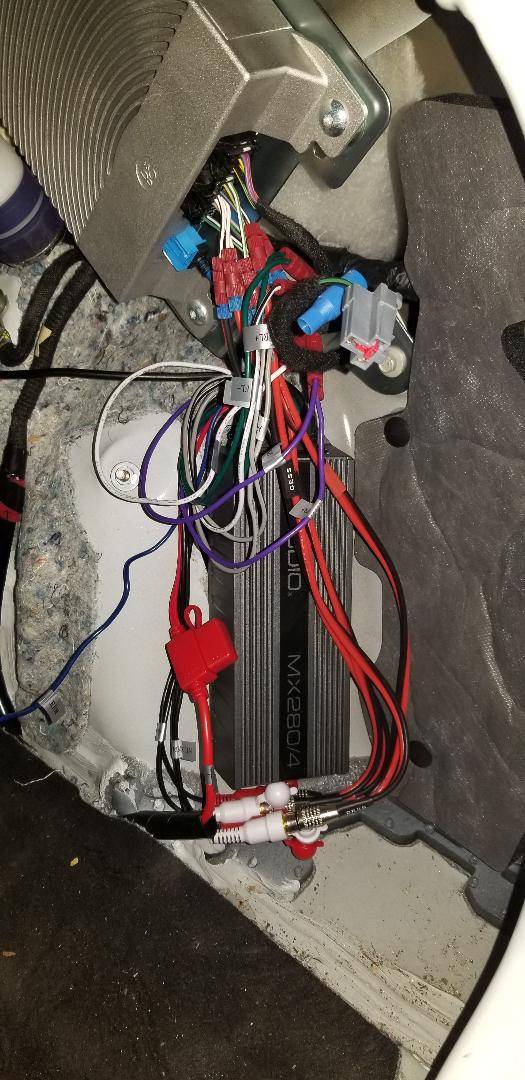

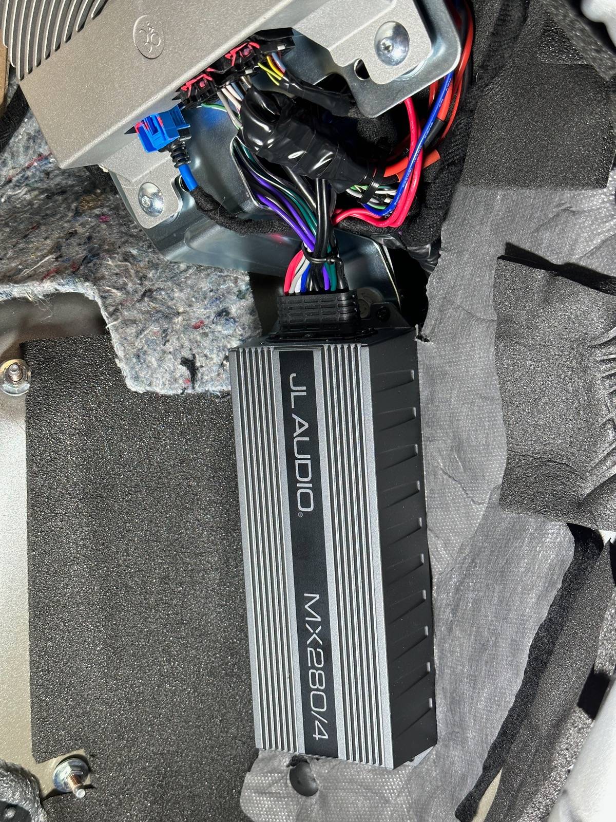

My installation looks like this. I used Posi-Lock connectors (the little red tubes). Also, the blue larger Posi-Tap connector on the top right is to an OEM ground.
I used an OEM body stud from the inadequate Ford sub that used to live in this space to bolt down the bottom of this JL amp. It is just below the JL amp's bottom edge and cannot be seen in this picture. This one OEM body stud & nut keep the JL amp snugly in place.
The JL amp's wires are all clearly marked with channel tags. You just need to match every speaker wire from the Ford amp (example: Left Rear Door, etc.) and splice in the JL amp Left Rear Door wire into that speaker wire run, etcetera speaker wire by speaker wire. That, and ground the JL amp and also pull in a power line, as described in the thread... I used the 10-inch Sub's power line from below the trunk floor. Finally, look at the RCA connections as described in the thread. The RCA stuff and the ground are easy... the only tedious careful work is individual speaker wire interconnections. And of course running the power line...
Good luck! This mod is worth the installation work.

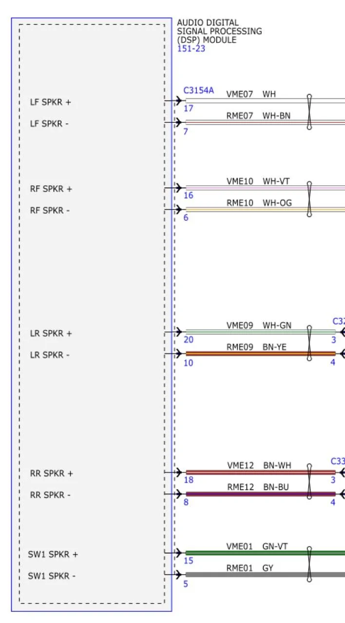

Thanks Martin and I will add the wire diagram for the proper colors necessary to make these connections and you also need two pairs of RCA wire converters for the input to the JL amp. I sent Marcus a detailed explanation on this. You need to pick up the remote turn on at the power point in the right rear of the cargo area and the proper wire to connect to for that is the Violet/Brown wire at that power point.
RCA wire connectors (you need two pairs)
https://www.amazon.com/gp/product/B082DPQ8WD/ref=ppx_yo_dt_b_search_asin_title?ie=UTF8&th=1
Speaker wiring diagram (10 speaker B&O system)

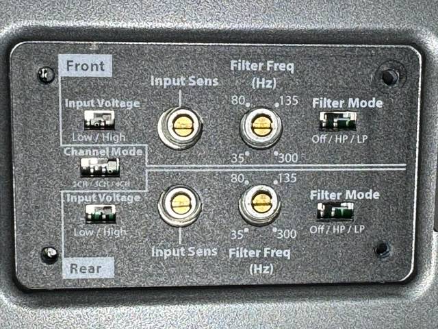

JL amp settings.
