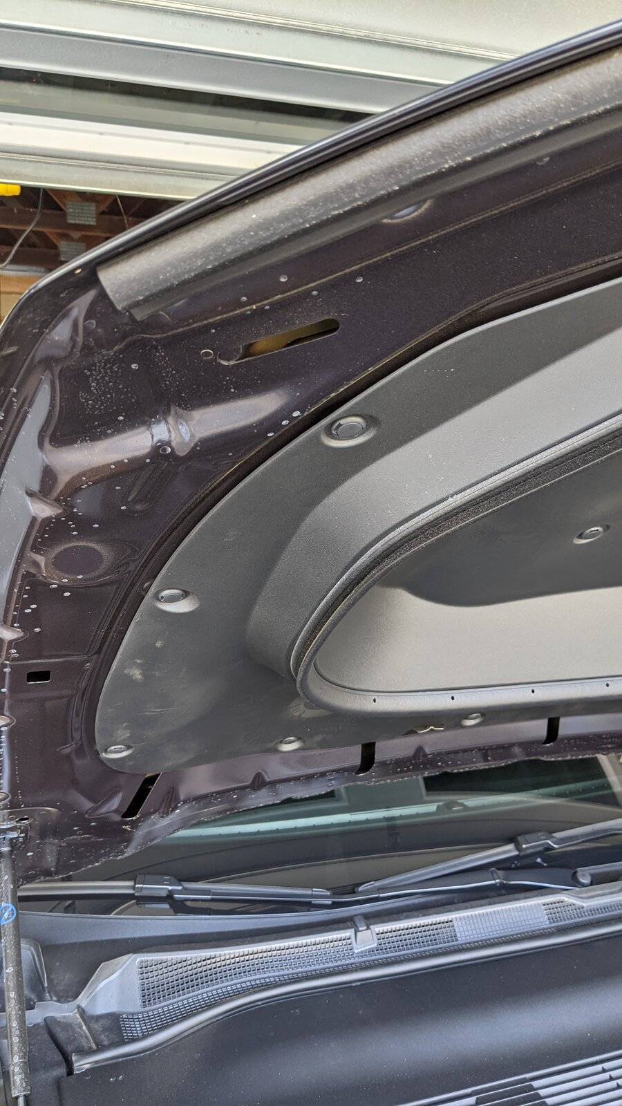

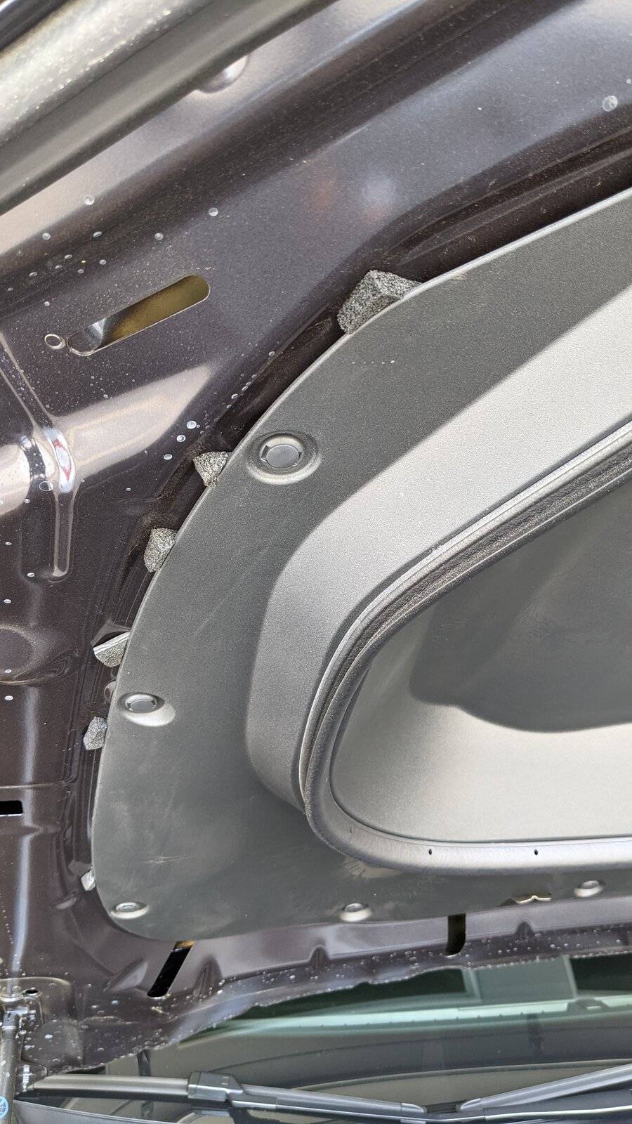

Ok so over the weekend I took apart a large portion of the dash, a-pillar, headliner etc and found nothing that would give me indication of the source.
I did however find something that's very plausible and I'm going to do some testing to see if this resolves the issue.
If you pop the hood you'll see the plastic liner on the hood itself. There's no insulation preventing cross wind from hitting this plastic. Slightly touching it causes the plastic to rattle against the hoods metal underside.
I'm putting some foam under the lip to see if the issue resolves. Below is a picture of the area in question.

Today we have about a 15mph wind so I took the car out after foaming it. I still got rattle on the passenger side where I applied the foam, but it wasn't as bad (compared to the driver side, which i didn't foam). I didn't apply foam anywhere along the windshield side which could have lead to the rattle. I will continue testing as I think next steps would be to get some foam tape, remove the plastic cover and apply it correctly, then re-attach.

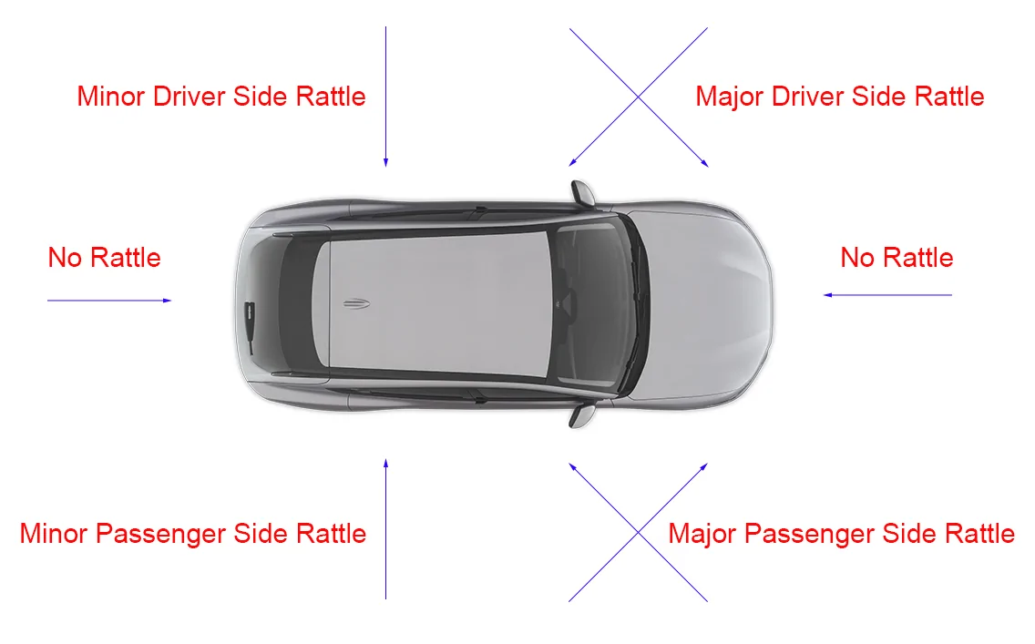

Since I am specifically looking for this issue now, I noticed the rattle (for me) is 100% based on cross wind, specifically 45% degree winds as shown in the picture below. I can confirm that the noise originates from the side with the cross wind hitting the vehicle and changes sides accordingly.
@ARK I tested your suggestion and nothing happened. It's definitely coming from the dash/vent area. Thank you for your suggestion however! @Mach-Lee I tried this without climate and it still happens. Thank you as well for the suggestion.
TO ANYONE WITHOUT A GT - Could you pop your frunk and slightly tap on the plastic where there's the push pins and see if it EASILY rattles against the metal of the hood?
