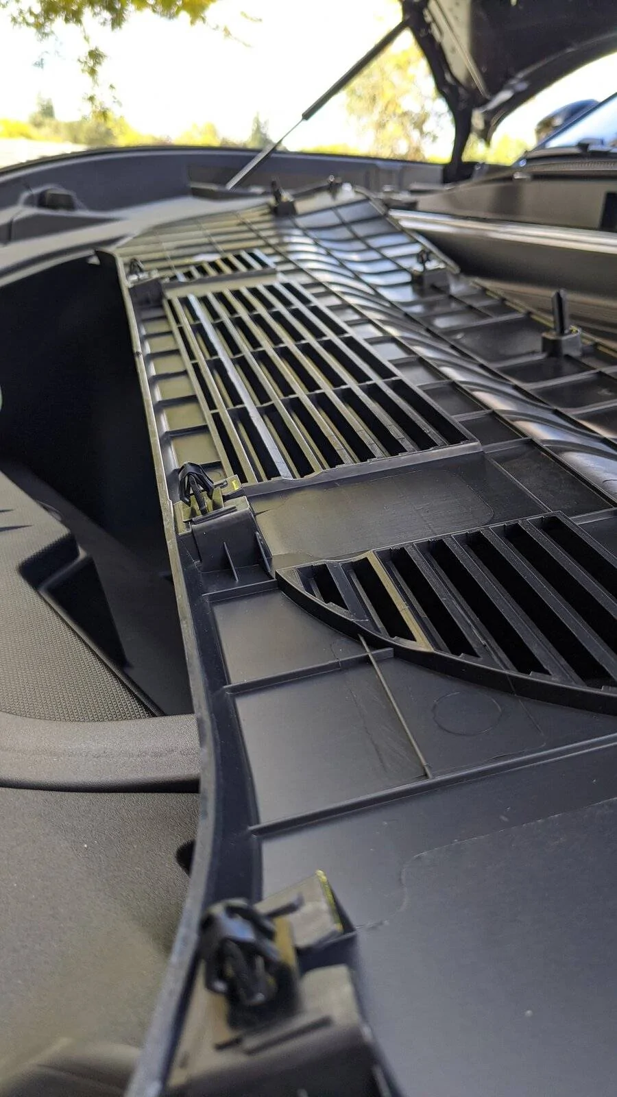

So far I think we might have isolated it if you read the last couple posts of this thread. Try popping the frunk and removing the plastic housing in the pictures above. Drive without it a couple days and if goes away apply foam tape as shown here by @Scooby24

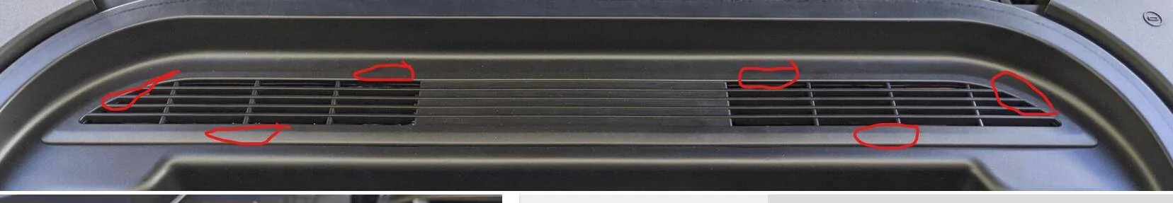

Sorry to hear...did u hit the yellow spots? Also push around at the other plastic parts to make sure all snapped. I had one on driver's side not snapped.
I couldn't hear any noise today with crosswinds.

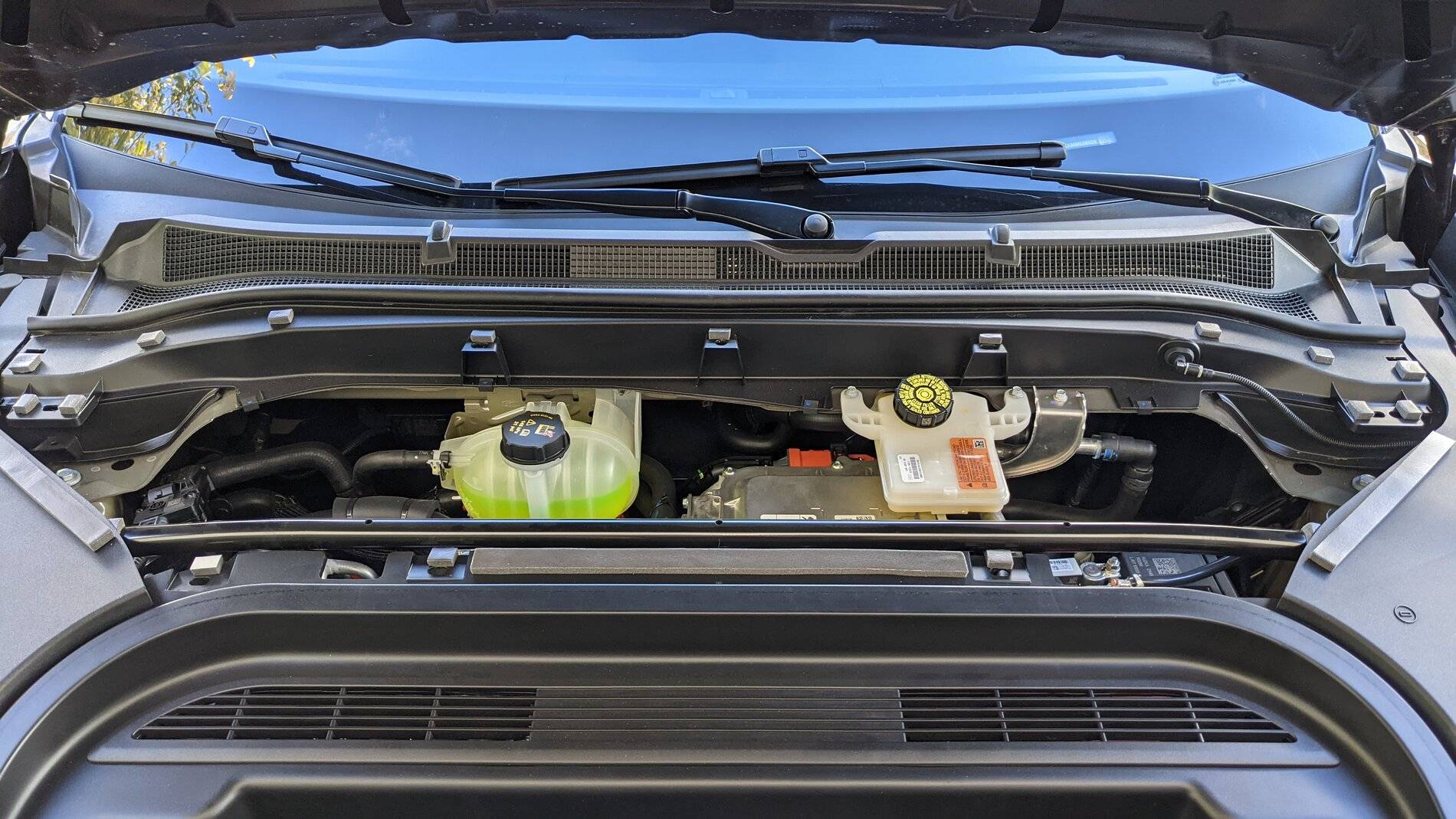

Pretty sure I got them all... Except the two on the cross member. I added those between the member and the plastic. We'll see if that helps.

Oh c'mon. There was some sarcasm in my statement when I said that. I have only broken one clip in my life and I just grabbed a new one from Amazon for $0.50
Here's what they look like:

Last place I could find any rattle. Ends pull up with clips. DO NOT PULL the center up. It's plastic riveted. Found that out the hard way.
Ford Mustang Mach-E Cross wind rattle ... Anyone else? 1635041901554
Take your fingers and just tap them around all over the plastic. This is where you'll find the rattle and I'm almost positive this is the source of it...as the cross wind will enter the wheel well and cause a pressure differential which would cause these plastic pieces to rattle with the pressure.
