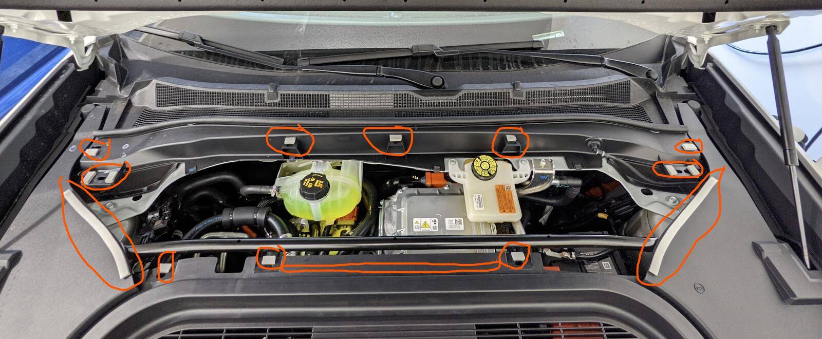

Give this a try. I taped the following locations and the test drive after had no noise...but the wind also had died down.
I added one additional long strip on the front since that was still rattling if I tapped the plastic.

One last update...take your fingers and just tap them along that upper trim piece and you'll hear where it's rattling. Last rattle I could find was at the upper most part by the windshield. Placed a few pieces of foam right along the edge of the trim and now tapping all over it simulating vibration results in zero noise.
Ford could probably resolve this with 4 well placed felt pads on the trim pieces.
New locations noted in yellow.
