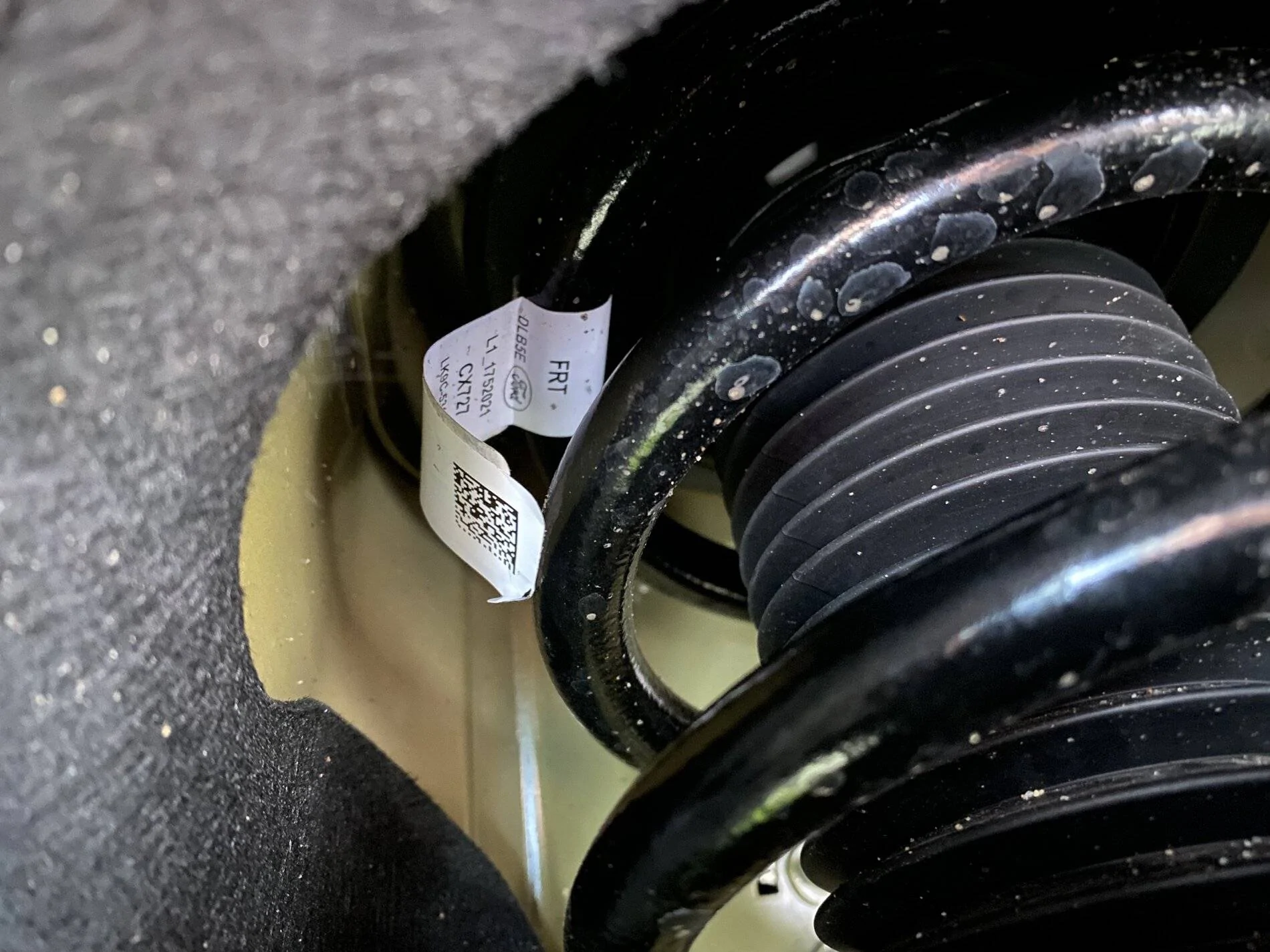

I had this on another car. I had owned the car a while and bought it at one year old and 33k miles. Some time later I started hearing a noise that changed with speed. The dealer found a factory part sticker on a drive shaft that was coming loose and started hitting something nearby once I was going fast enough.
Well damn. I took a look in the wheel well and noticed this part sticker...
Ford Mustang Mach-E Cross wind rattle ... Anyone else? IMG_4234
definitely looks like it can flap around to me, I removed the sticker but haven't had a chance to test it yet. will let you guys know if this resolves anything.
that is legit crazypants
I saw that too but didn't think it would be the cause based on the sound. I'll remove mine also and see.

I'm not the only one! I'm experiencing the exact same noise from the front passenger side of the vehicle. I've already taken mine to the dealer, they couldn't recreate it after a 6 mile test drive.
I found the part sticker on the passenger shock, removed it, still have the noise. I don't believe mine is caused by cross winds. If I drive down my road, turn around, I still hear the noise going both directions. Current wind speed, 0-4 MPH at my house.
