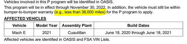

I wonder if this means OTA support will end with the warranty as well?
See this is kind of insane to me. They basically have defective software that causes problems FROM BRAND NEW but you can't fix it brand new because the fix doesn't exist. Yet if you drive the car more than 36k...well...you're screwed, they won't fix it for free then even though it was defective at purchase. Just insanity.
They have to figure out a better way to do this and support future software issues.
I wouldn't think so. These updates probably could have been pushed via OTA from Ford without having to pay a dealer (hence the warranty claim limits for payment). But it seems like Ford is offering to do this now, sooner, rather than having us wait for an OTA in mid 2022 or whenever.
There was no customer notification going out about this, so these updates would only be applied if the customer happened to know about (because they read about it online), or their vehicle was otherwise in the dealer for different service related reason.
"As this program is intended to be performed on vehicles already at the dealership for service, customer notifications will not be issued for this program."
I'd guess if you don't get this applied via the dealer it would come to you eventually anyways via OTA. Totally guessing.
