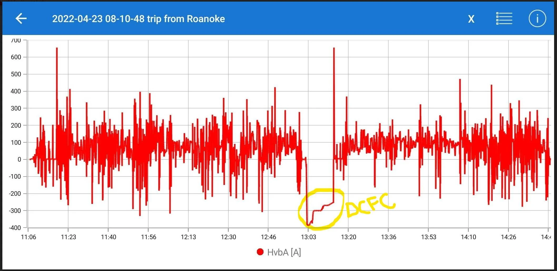

I am really curious about the current people are drawing when the failure occurs. So many are 400+ Amps when the failure was recorded.
I checked the data for a trip I took from my mom's house, and I rarely exceeded 400 Amps. It was usually well below that.
Ford Mustang Mach-E [DATA] - HVBJB Mega Data Aggregation Thread 1664411791932
Todd, I know you were capturing data when your failure occurred. Did you look at the HVB Current for that trip and see how much you were pulling? I would love to see if it looks similar to mine, or a lot different. Of course we didn't take the same route, but I am interested to see if you were pulling more current over a long period of time.
My trip has a lot of hills and I go over a mountain. I was expecting to see much higher current draw as I went up the mountain, but it isn't obvious so I can't pick out exactly where that was.
