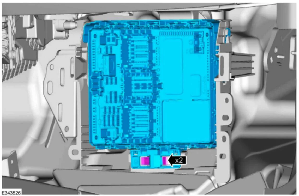

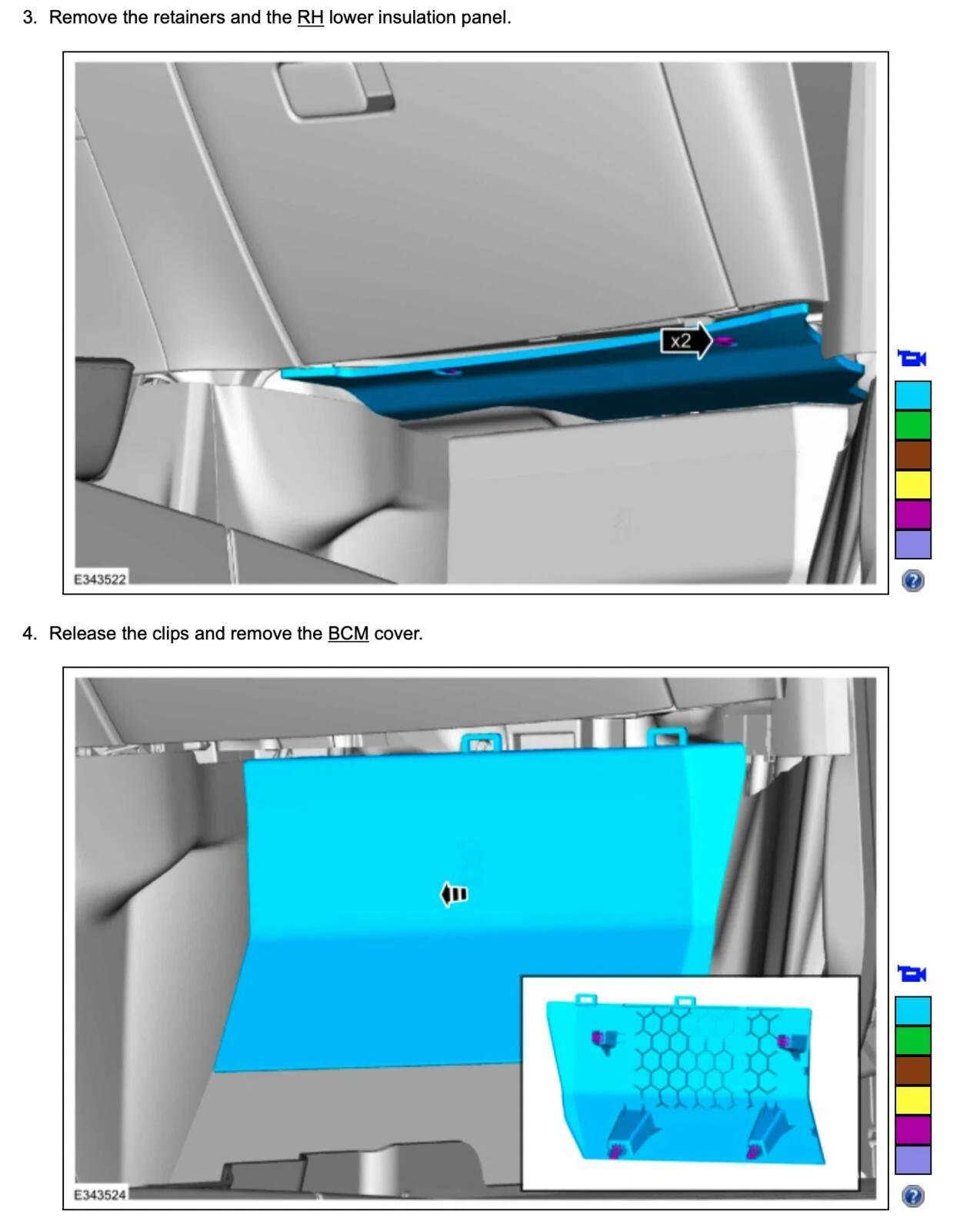

Usually the fuse box is built into the body control module (BCM). Here are pictures of its removal (skipping the unplugging connectors picture).

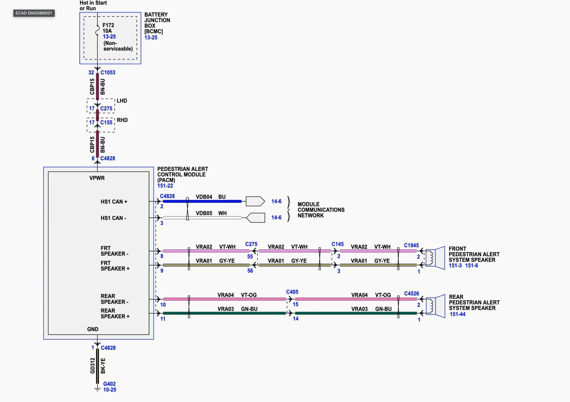

Unfortunately the fuse isn't user serviceable according to the wiring diagrams. Also note how it shows a rear speaker but there appears to be none.

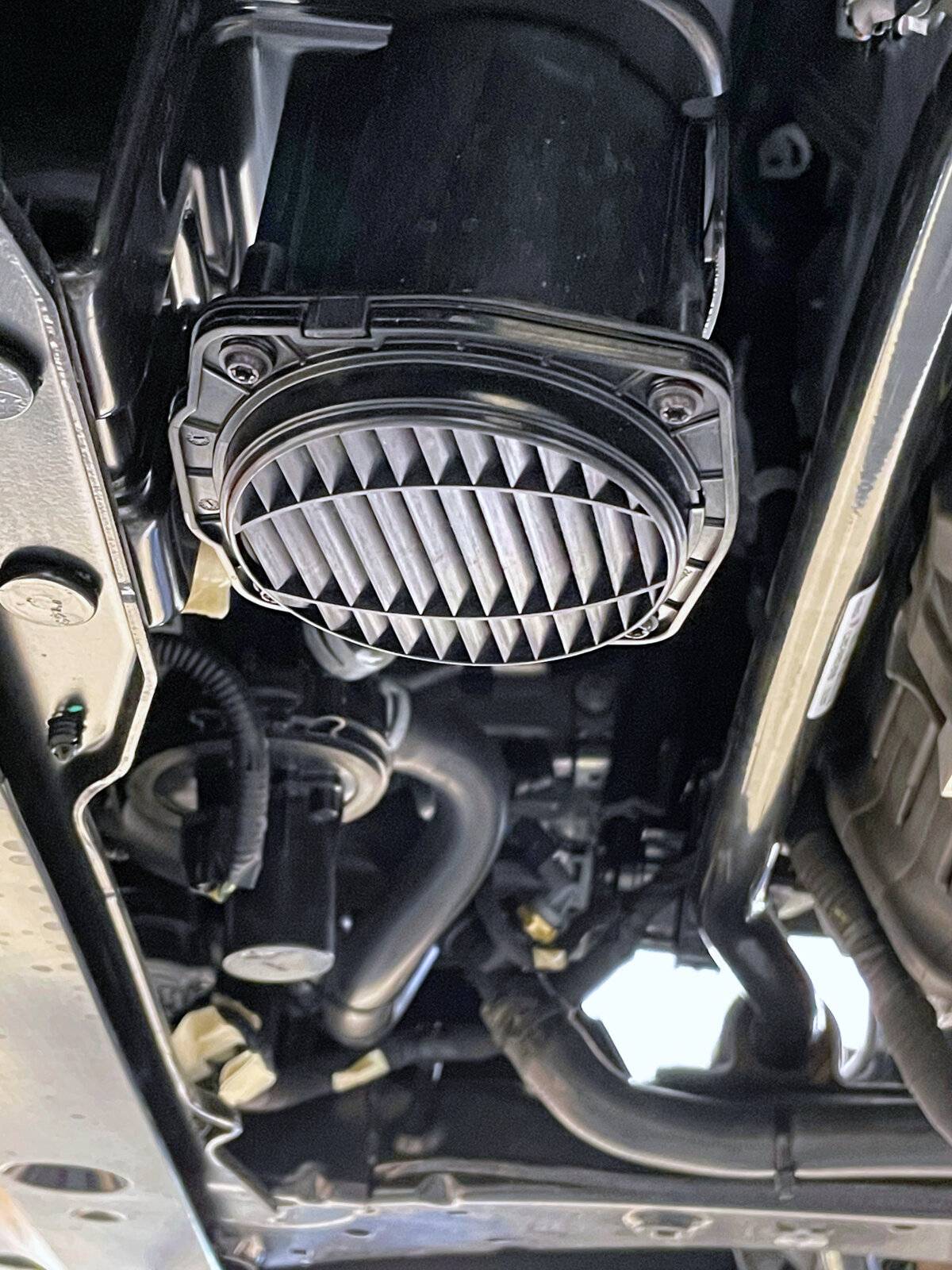

Thought I would take a to look at the Pedestrian Speaker since there has been a few questions about it.
1. The back up beeping comes from the Pedestrian Speaker. 2. There is only ONE Pedestrian Speaker and that is up front under the front underbody shield. 3. When you disconnect it you get a warning that the Pedestrian Alert System is malfunctioning.

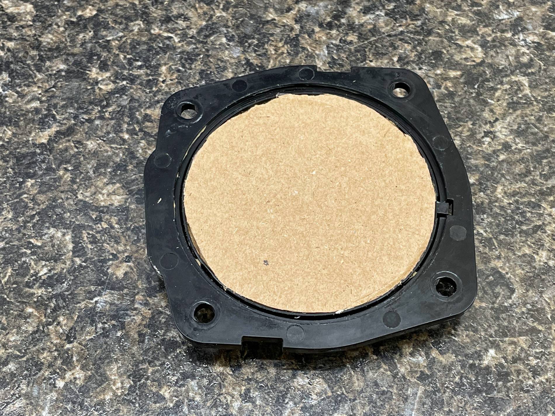

I do not want the back up beeping nor the Pedestrian Alert sound. I could replace the speaker with a resistor of the same impedance load or just block the sound. For now, I chose to block the sound. Four screws and the speaker grill comes off exposing the speaker. I cut a 3" cardboard circle and put it in the speaker grill and put it back on. I no longer hear the Pedestrian Alert noise and can barely hear the back up beeping in a quiet garage. Outside with low ambient noise you do not hear it at all. I am happy and done with that project.
There has been talk about there being a second pedestrian speaker in the rear since the service manual shows wiring for a rear speaker. I have checked and the Mach-E DOES NOT have a rear pedestrian speaker.
1. The back up beeping comes from the Pedestrian Speaker. 2. There is only one Pedestrian Speaker and that is up front under the front underbody shield. 3. When you disconnect it you get a warning that the Pedestrian Alert audio system is malfunctioning.
Sounds like a winner to me. How hard was it to get access to? Have to pull off much of the shielding? I haven’t looked at the underside yet.

Nicely done Mark. I'd like to see just how attenuated it gets with this in place. I might consider doing the same.
