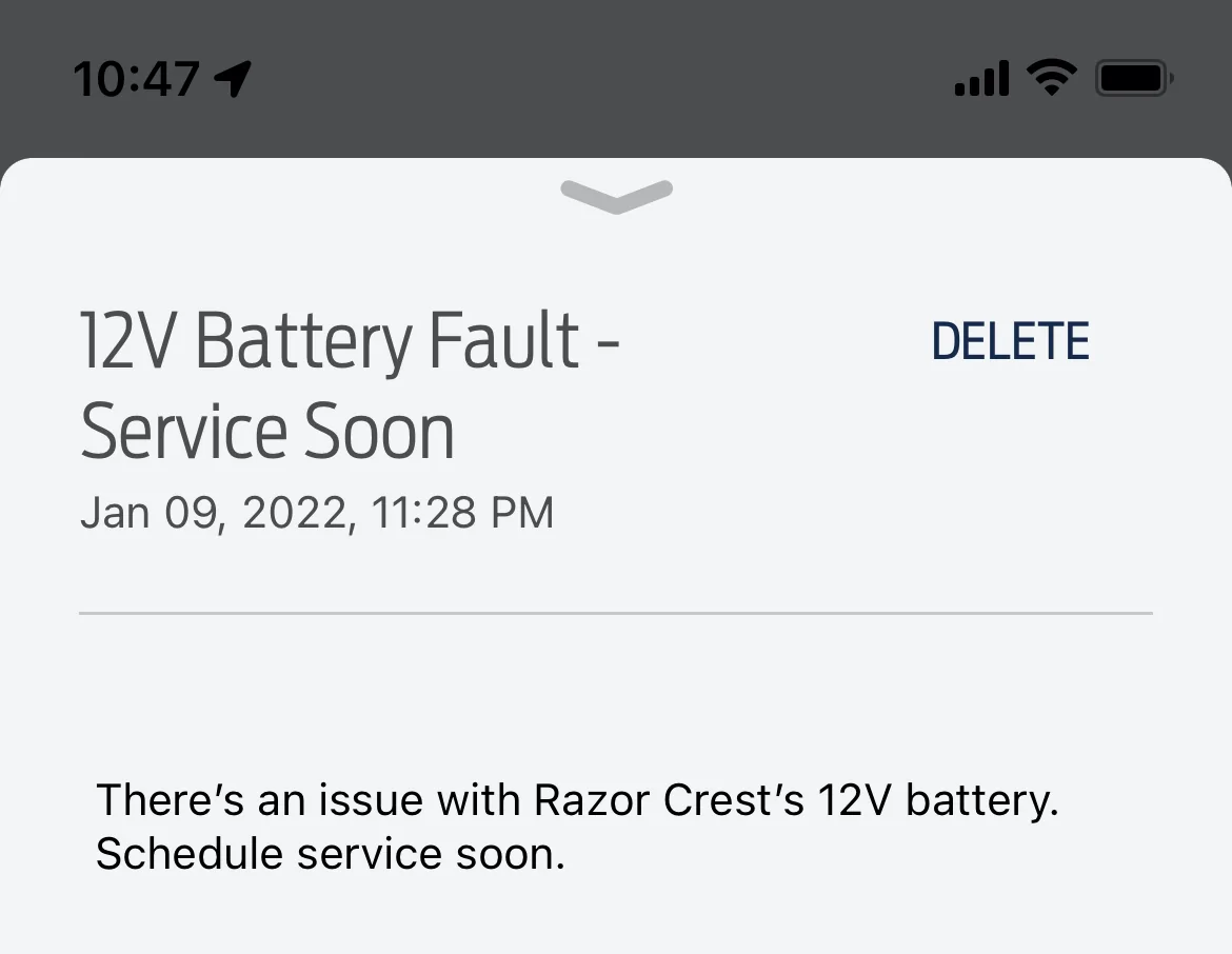

Down for the count :(

Probably dead then, and I'm about to turn in. I hate to ask this, but do you still see that accessory box when you start it, because nothing will work in accessory mode (often a blinking led in the start button too).
You probably tried this, but just in case. Turn MME completely off, get out and close the door, leave it alone for 10+ minutes. If the headlights do not turn off after the delay, rotate the headlamp switch to off, then back to auto. Then on return, be sure to do the regular start, pressing the brake pedal while pressing the on button.
If you do that, does it still come back on in accessory mode?
So could be dead 12V, or there have been a few module / motor failures (very unusual).

Again? I figured your troubles were over. Sorry to hear. Is your car completely unresponsive? Did you try turning the headlights on manually? In my car, that appears to force the DC/DC converter to max charge but only when in Ready Mode. Doesn't seem to do much in accessory mode umfortunately.....
Tried the headlight thing and didn't work. I can't get it out of accessory mode(blinking green light on start/stop button). When I try to start it, even my seat won't move to go to where I have it set for my profile. Just got a call that ford roadside is still trying to find a tow to get my car from my workplace. Thank goodness ford is paying for a rental car because my dealership didn't have any loaners for me and a coworker was able to drive me 35 minutes to get it.

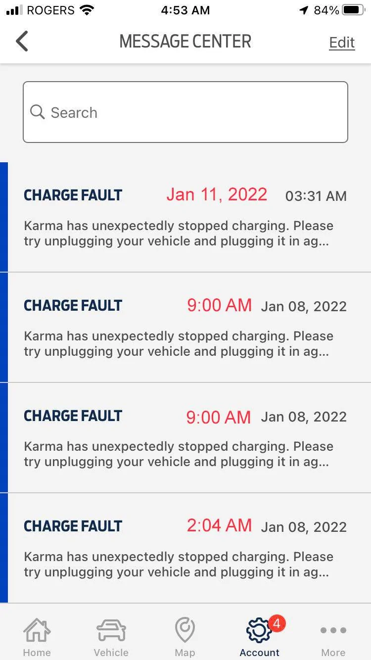

I was told I was playing with fordpass too often when it drained last February ?. Ya plugged into 240 V and 85% of a 100 KWh battery you should not walk by it too often. ;)
Here is what I get on the 3 times it has drained the 12V. I caught it on the 11th unfortunately not on the 8th. On the 11th I went out at 7 am it was - 30 F and started it and let it "run" to charge. At 9 am -15 F on the 8th it it was too late and a 12V charger was required. Getting a bit old at this stage.
