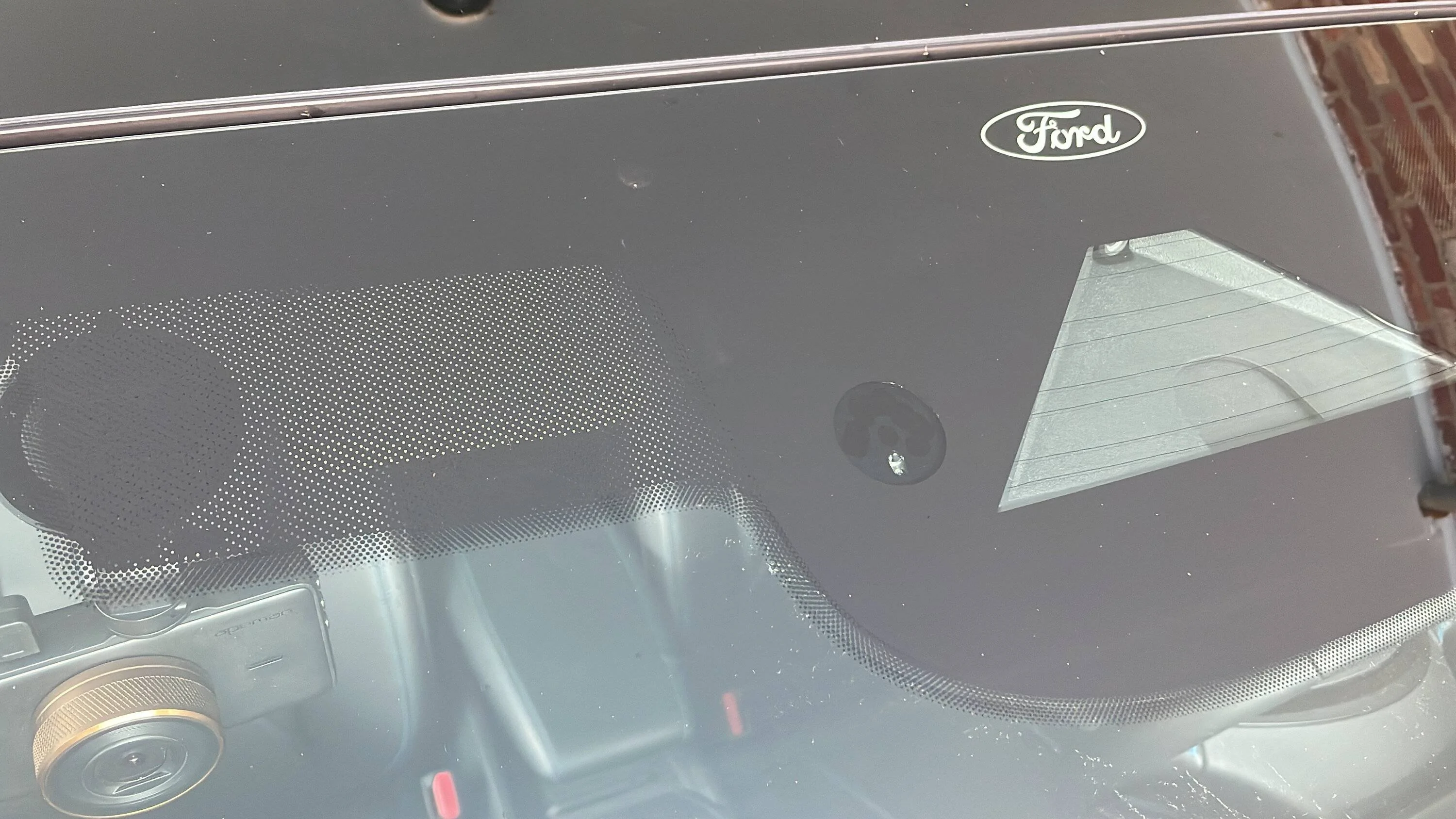

You can see the dramatic difference in the EMF transmissibility with a GPS Test app on your phone when it's not connected to AndroidAuto (and maybe CarPlay?).
Hold the phone just about anywhere in the cabin and you'll have poor signal. Hold it up to the frit (the dotted part of the windshield next to the center mirror, and watch you're signal go back to normal!

For those of us with Radar Detectors we've been discussing this, coming up with solutions and custom manufacturing mounts just to be in this little clear spot. Putting a radar detector anywhere else will render it useless. So yes, as @generaltso mentioned, this has been discussed for years on here including putting transponders in that area, which is also mentioned in the owners manual.

Well this is what I get for using youtube as my primary information source. Watched several videos and they all said stay an inch away from any dotted areas on a windshield.
Now... anybody know where to get new velcro-like thingies for re-attaching the transponder to the correct location? Hopefully the original ones can be teased off the windshield and re-used. If not I'm guessing they can be had at turnpike service plazas but if anybody has that info I'd be much obliged.
