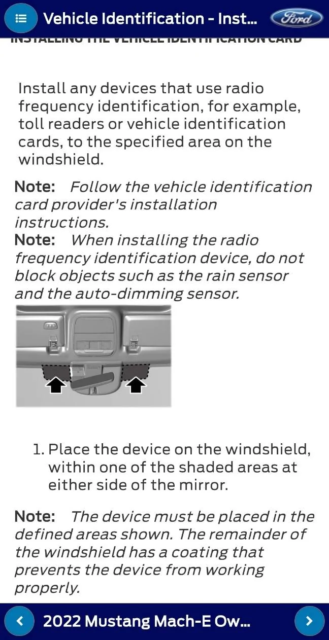

Has anyone had a problem with their E-Z Pass transponder attached to their windshield not being read when they go under a toll reader? If so, how did you solve the problem? If not, where on your windshield do you mount your reader? Is anyone using an externally-mounted transponder? If so, how did you mount it?
