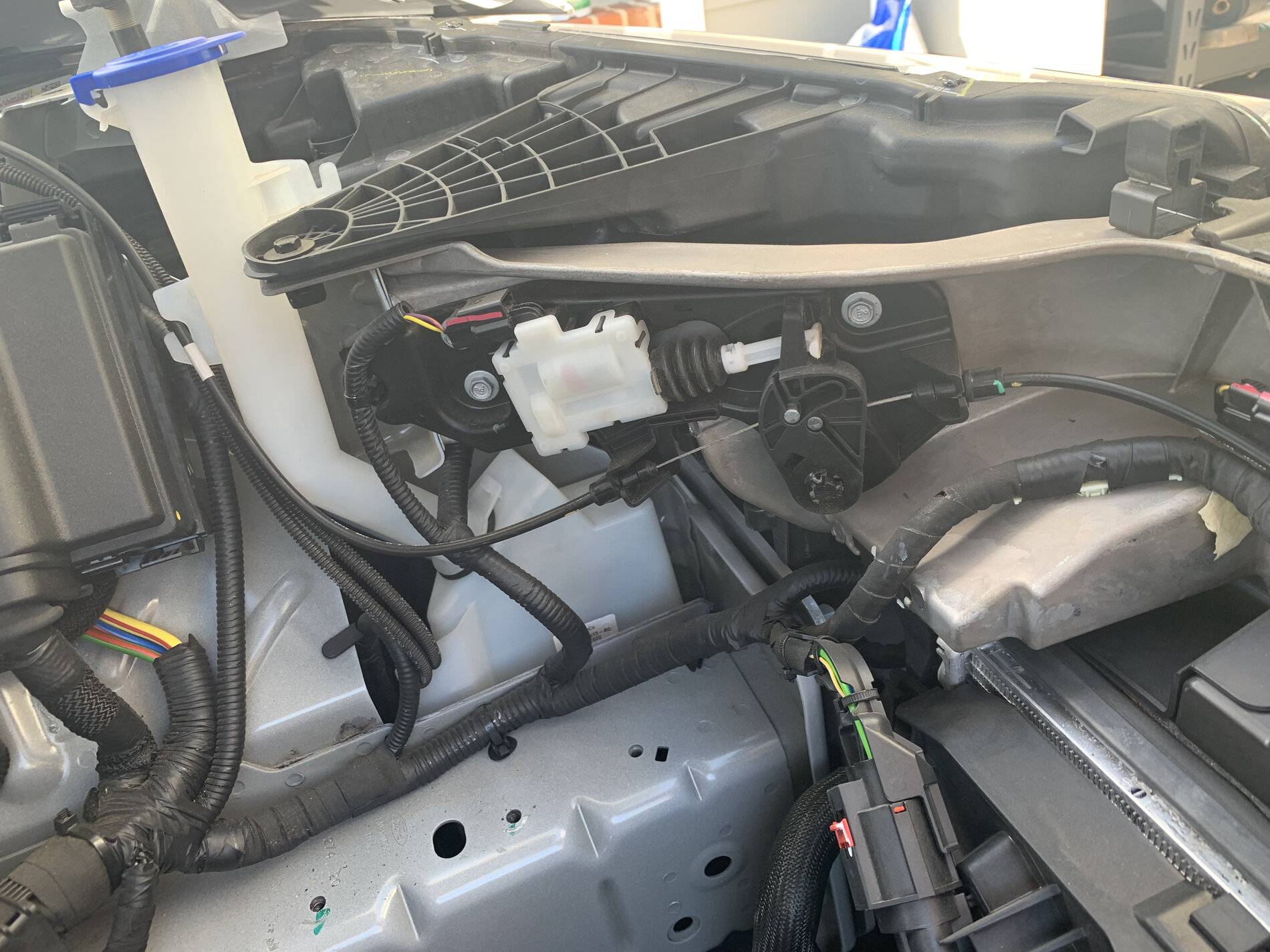

I had to remove the frunk and found the electric frunk pop. I unplugged applied 12v and it works. I was a little too busy to install a button but it looks like, when allowed, Ford should be able to add this feature. If it doesn’t come out in the near future I plan on installing buttons to do the frunk and the trunk.

Make sure you don't shoot it the juice and back-feed something fussy.
Yea that’s why I did it with it unplugged, if I end up doing the button I would use some diodes to prevent back feeding. I’m sure this thing is one big computer and I’m not trying to fry something.

The current use of that solenoid is the emergency frunk release activated by applying 12V to the wires behind the cover in the front bumper. Used in the case of a locked car with a dead LVB. Make sure you don't inadvertently disable that system.
