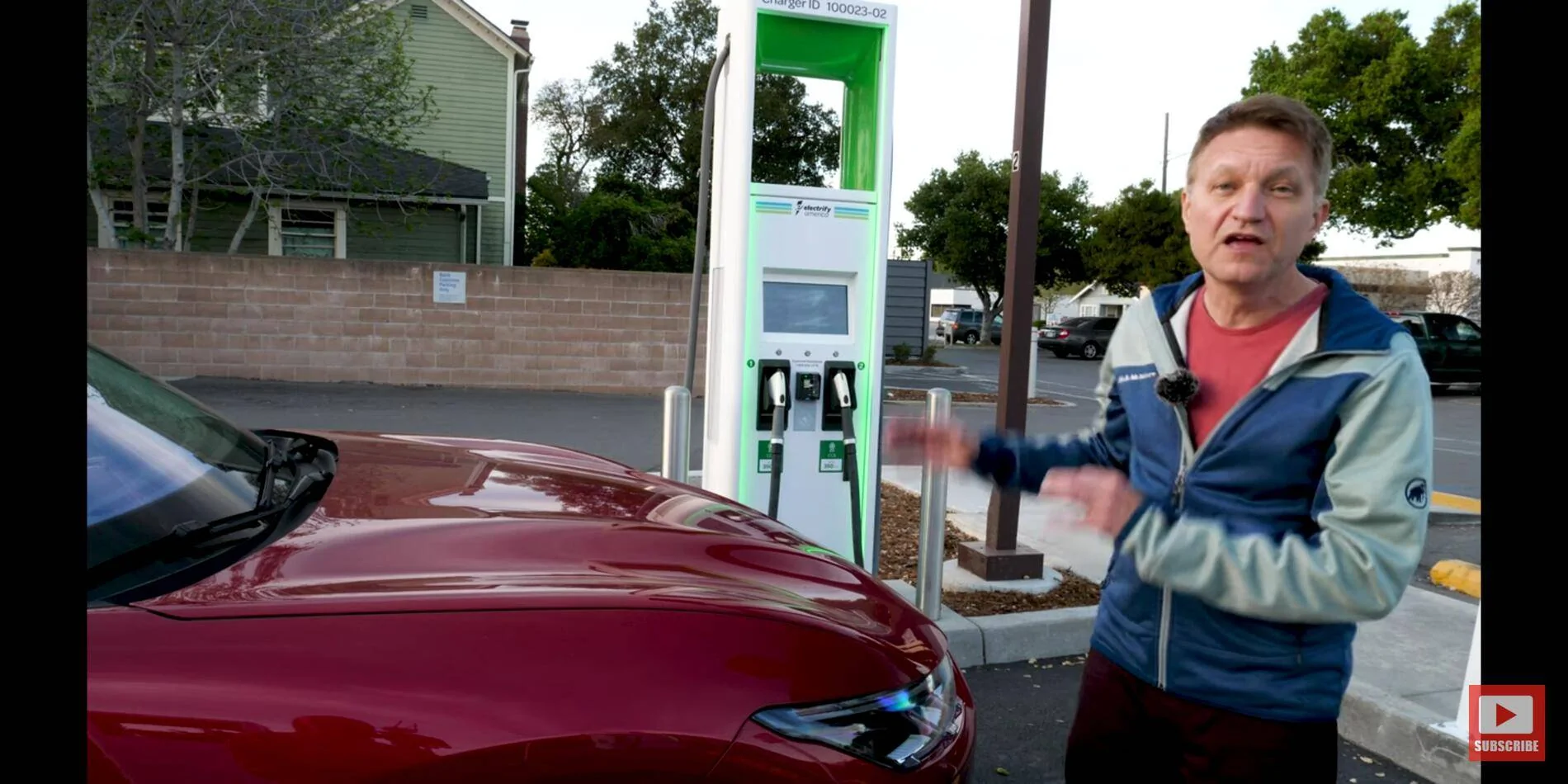

Looks like Paso Robles uses the older units which are systematically being replaced with more reliable chargers.
This reviewer was hogging the Paso Robles EA station for a few hours to get up to 100%.

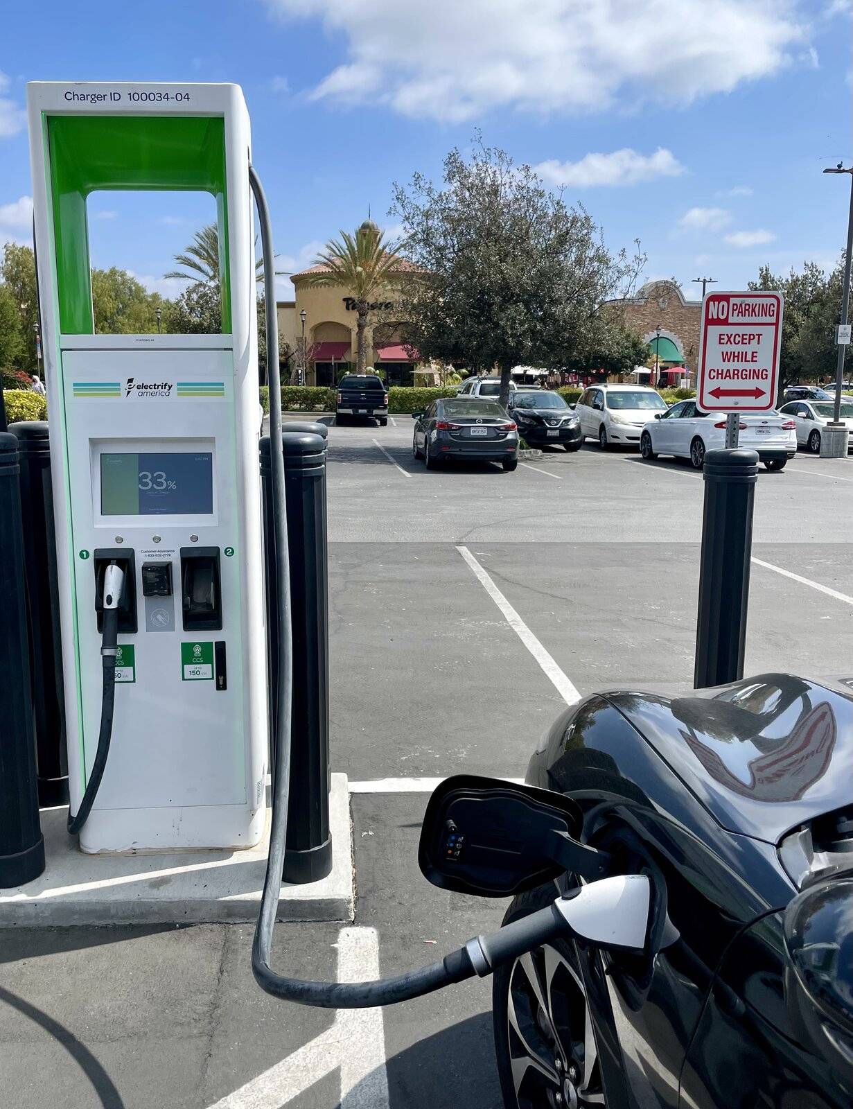

1st time using EA at camarillo, california in the outlet malls. a dozen or so stations just 2 miles off the 101 freeway and a panera and burger place right across the way along with plenty of shopping
pulled in around 25%, grabbed a sandwich and salad, and 30min later i was at 80%. actually only needed an extra 10% but i figured i’d let it do it’s thing while i got a bite.
had set up connected services when i first got the car. knew i had the 250kw ford credits.
had also downloaded the EA app just in case, but did not set up a separate account.
literally just plugged it into a random open station in the middle (150kw charger) and everything worked.
so for me plug&charge worked on the 1st try.
If all of the stations weren't in use with another person waiting, is it really "hogging"
