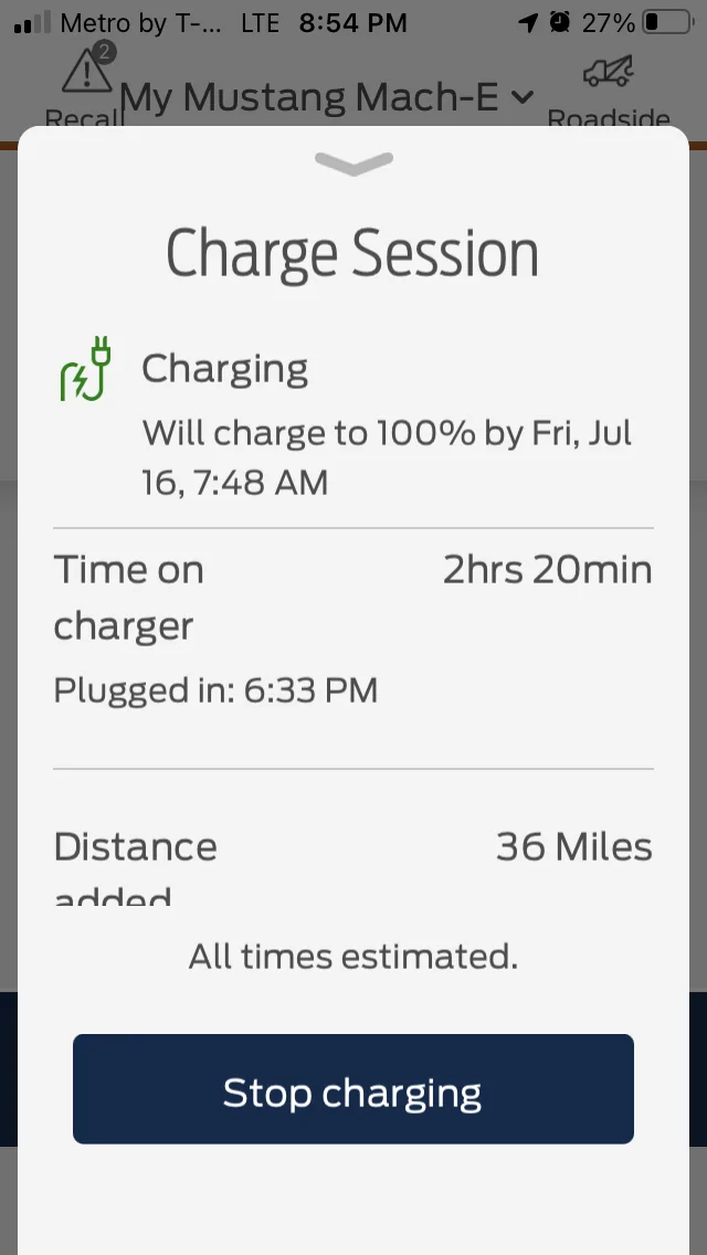

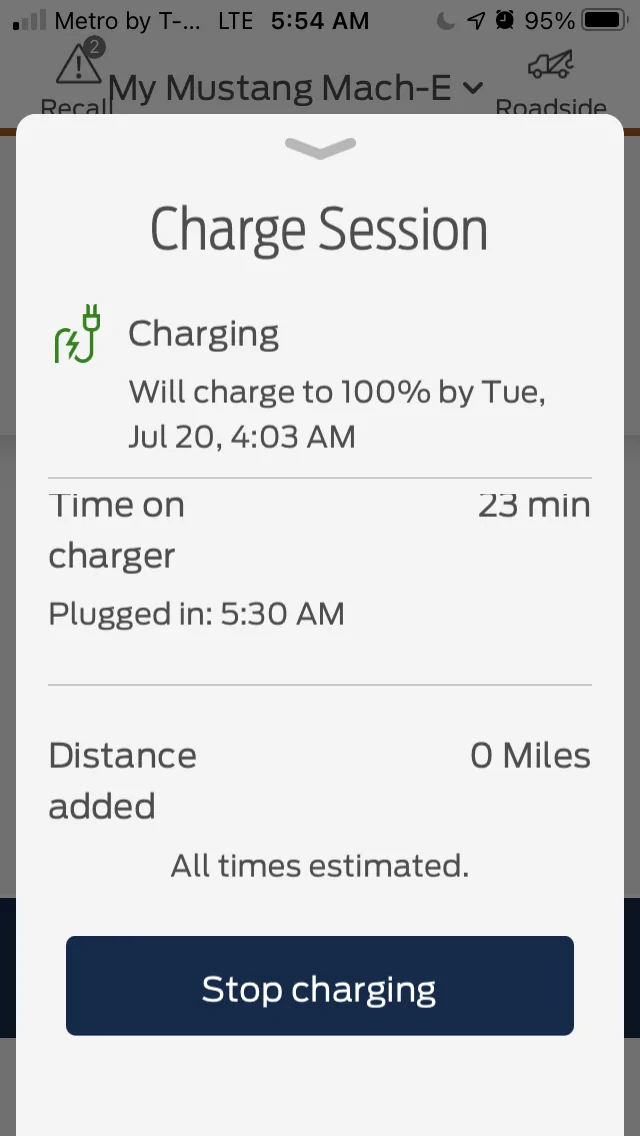

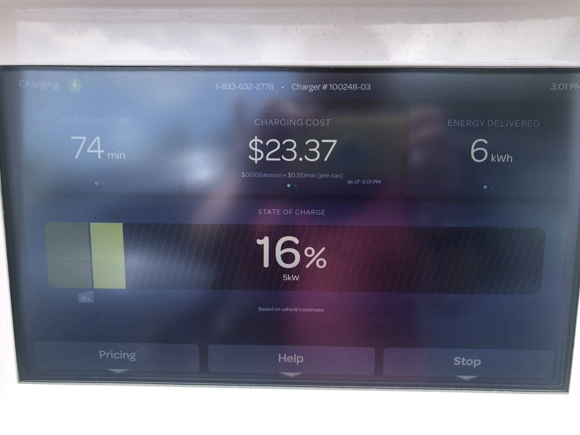

Major issues charging, period. Used EA, Charge point and now at a Blink station! Took total of 9 hours yesterday to add about 80 miles! Is it just my Mach E?

Something is dramatically wrong there. 5 kW should be more like 120-160 kW at that point in the charge curve. In fact it should never get down to 5 kW on DCFC. Above 80% SOC it drops to the 10-12 kW range in the MME (by design), but you should never see it go as low as 5 kW on a DCFC charger. Especially below 80% SOC.
Sucks even more that it was in a per-minute state instead of the usual per-kWh.
Since you experienced similar extreme slowness at a totally unrelated Blink charger too, I'd suspect something is wrong with the car and it needs service. If you take it to another DCFC just to do a quick 3rd test, you'd know within minutes. If it stays stuck around 5 kW, it clearly needs service.
