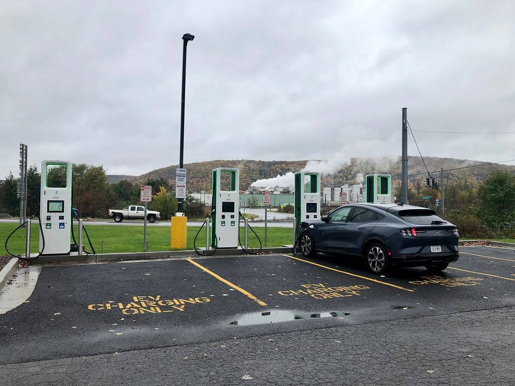

I charged three times on my roundtrip between Syracuse, NY and Allentown, PA. I used the EA stations all three times. Plug and Charge worked flawlessly each time.
Ford Mustang Mach-E Electrify America Mach-E Charging Issues i-ZXRwWDN-XL
Used 350Kw station at Love's Travel Stop in Binghamton, NY twice on the way down and back. I ate at Wendy's which is inside the Love's building and used their very clean bathroom. You can also find anything a traveler would need in the Love's store.
