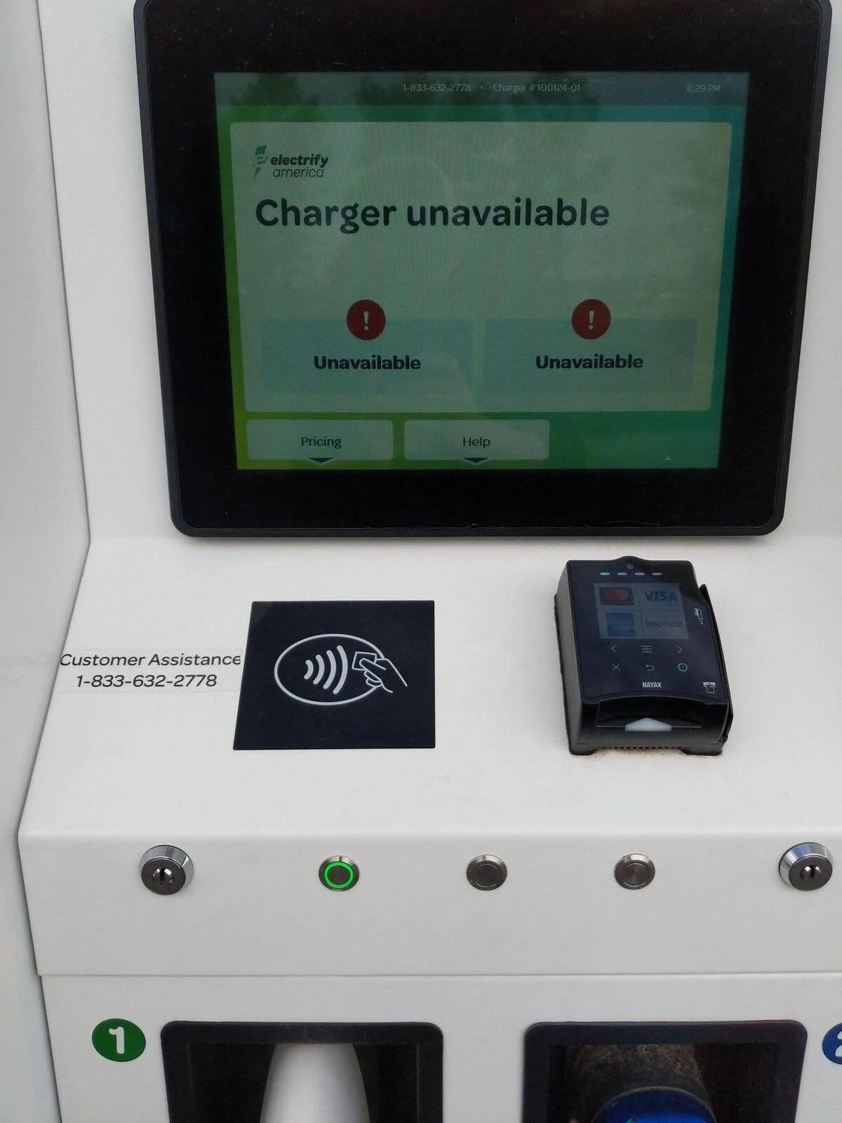

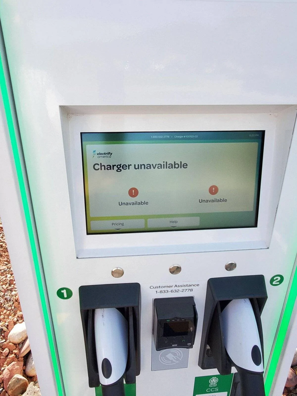

I've gotten phone tap to work on the type of charger in the 1st pic, but not the 2nd...
Ford Mustang Mach-E Electrify America Mach-E Charging Issues 754829
Ford Mustang Mach-E Electrify America Mach-E Charging Issues 591366

Both work on my end. Definitely aim clearly for the gray tap area at the bottom. Sometimes it “beeps” as I’m near the credit card reader but that won’t work.
