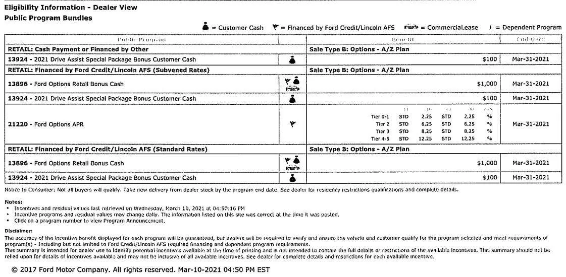

Thanks again @hybrid2bev. Dealer called back and went through everything...seemed to be knowledgeable. Only thing was 13896 Ford Options Bonus Cash was quoted as $1000 not $2500. Is that correct? They provided the Step 3: Determine Eligibility page with a timestamp of an hour ago.

Options cash is either 1000 or 2500 depending on ur zip. Either way that doesn’t impact the dealer. Comes from Ford. U can “price” a new MME on the Ford site and looking at financing based on zip. It will list either 1000 or 2500

Yes, both $2500 or $1000 are valid values.
The bonus cash amount can vary based upon which marketing region you live in. Here in MI it's only $1,000 in other marketing regions it's $2,500.
