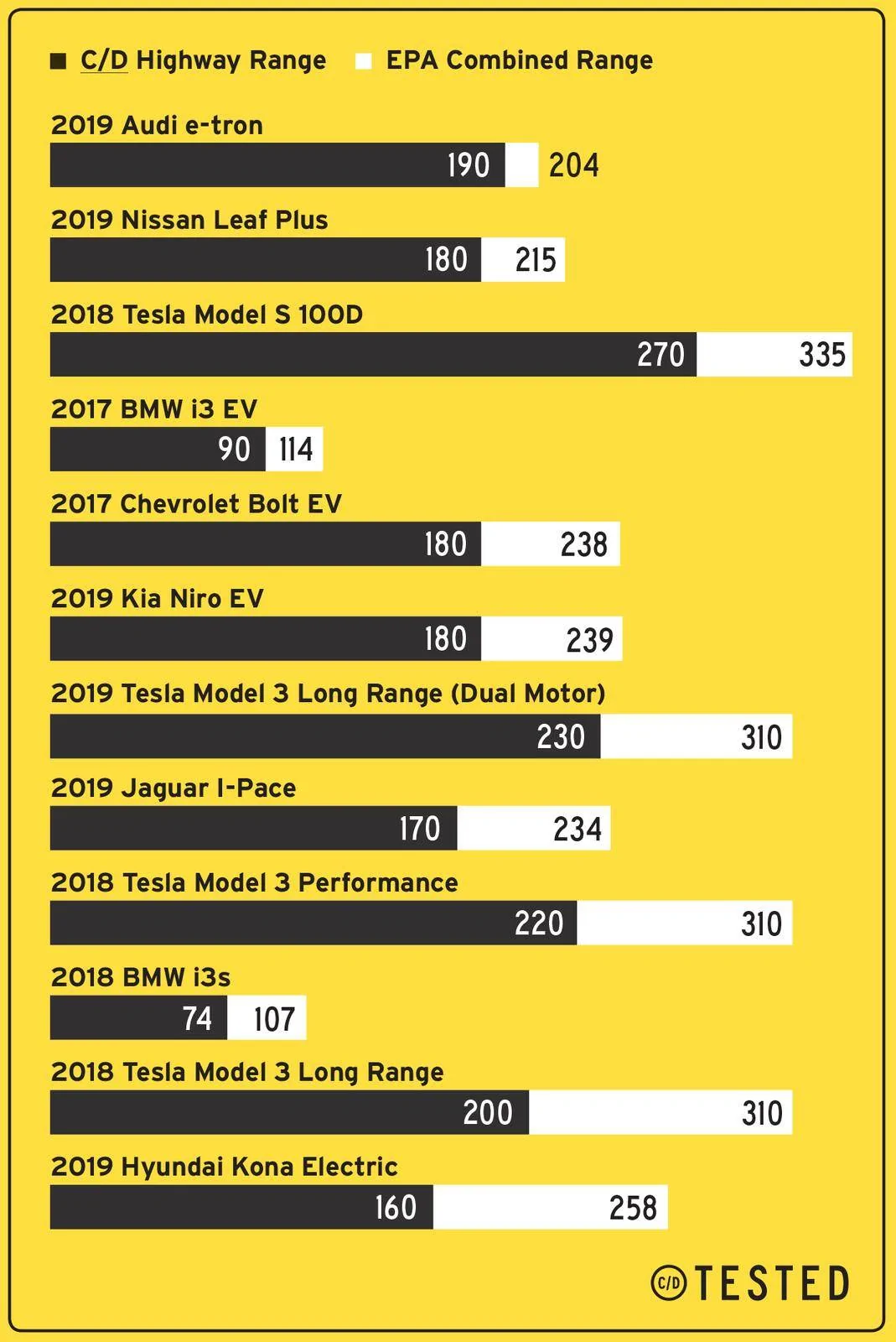

That’s pretty interesting, especially knowing what we know about that Norway Drive which was like 300+ going like 55mph. Yes we would have to guess what the ratio is, I would think we would compare most on rating to in the Audi Or the bolt since Ford always benchmarks Chevy.
would put us at like 250-260mi highway and like 330ish when hypermiling like Norway.
Google pegs that Norway drive at a 47 MPH average if driving the speed limit, although it's possible that there could be some 55 MPH stretches in there (90 KPH). And some city on each end with some regen.
Overall, 47 is probably still in the wheelhouse for BEV efficiency. Still fairly low air resistance, and better motor RPM.
From what I've read, sounds like many BEVs can even go up to 60 or 65 without serious loss. But then it really starts to fall off above that. Sounds like the difference between 60 and 75 could be major (like losing 30-40 miles). Although we just won't know specifically for the MME until we try it. That'll be one of my first tests -- doing a 75 MPH stretch on I-25. That's my drive to Costco anyway.

Yes having the option of the Escape makes things pretty easy. I think the range issue will sort itself once you have the vehicle. I would not put too much stock in the Car and Driver numbers. I've had a couple of cars on the list and have never seen such lower numbers, and I can be a fairly aggressive driver.
Since the EPA range number is heavily weighted towards the City number, my shortcut calculation is to take the Highway MPGe number, divide it by the City MPGe number, and multiply by the range. That overweights the Highway by a small amount but it's easy and simple to do and, in my experience, will give you a very accurate approximation of the range you can expect.
In this regard, CARWOW did a similar test as Car and Driver and got quite different results. For example, the Nissan Leaf ended up at 203 miles rather than my projected 177 miles. The tests weren't exactly the same, one difference being CARWOW had more a steady 70 MPH rather than a steady 75 MPH. That can make a difference but still doesn't explain the differing results.

Pretty sure I can get on an open highway and set the cruise control at 75 MPH just as easily as C/D did. Which is exactly what I do (80 in Utah).
You've got it right. The Bolt speedometer efficiency feedback goes from green to lime-green/yellow between 60 & 65. Solid yellow by the time you reach 70. You will definitely see a range difference at 75.
