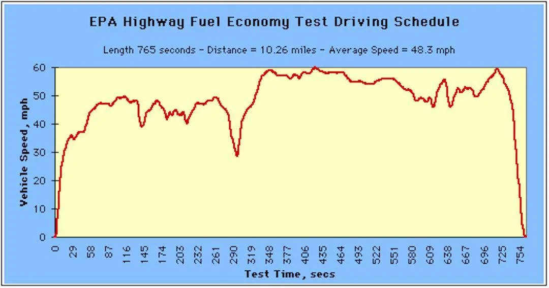

It's heavily weighted in the Highway number
Except it's not "heavily" weighted toward it. Just the opposite. If it were heavily weighted toward it, the average speed would be something like 73 or 77 or at least 69. Instead it's so slanted toward medium and low speed that the average is a mere 48.3 MPH (but passed off as "highway" speed).
Ford Mustang Mach-E Ford Range Increase Coming? 3HWFETSchedul
And of course the EPA "range" number everyone actually hears about isn't even that fast. It's a combo of the 48.3 avg speed and the 19.59 avg CITY speed. That would combine for an average somewhere in the 30's.
https://insideevs.com/news/439290/how-is-electric-car-range-calculated/
Bottom line: EPA range more reflects realistic city speeds, not realistic highway speeds. Just have to wait for experts to publish results of real world tests to find out realistic highway range at various high speeds.

And that's exactly my point. You just described a COMBINATION of highway+city. And that's similar to what EPA does on their "highway" test. And that's a misnomer because that's "combo", not "highway". 48 MPH avg is not "highway", it's combo (at best).
Then for the EPA "range" number, they dilute it further by splitting it with 19 MPH "city". By the time they get to their "combo" number, there's little highway speed left in it. Thus why EPA range is a very inferior number for actual interstate speeds.
