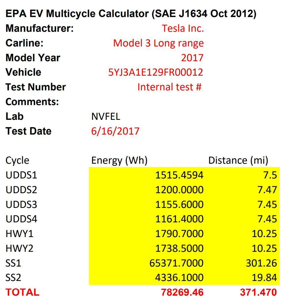

I'll take a crack at it.
Assumption: you start with a full charge of ~78.3kWh and drive at 75mph average until it stops.
Known relationship: energy required varies with the square of speed.
Calculation:
Speed 1 (average EPA highway test)48.300MPH
Speed 2 (Hypothetical)75.000MPH
Efficiency (average for HWY cycle from Tesla EPA filing)1764.600Wh/10.25mi
Efficiency (average for HWY cycle from Tesla EPA filing)0.172kWh/mi
Speed Ratio^22.411-
Avg efficiency for Speed 20.415kWh/mi
Total Energy Available78.269kWh
Total Range at Speed 2188.557mi
Source data:
EPA Highway Test Schedule average speed:
Ford Mustang Mach-E Ford Range Increase Coming? hwfetdds
Energy Consumption from Tesla EPA testing of Highway Test Schedule:
Ford Mustang Mach-E Ford Range Increase Coming? Untitled

No worries. It's the bottom line. 188.6 miles. I went back and made it red, so it should be more obvious.

The data I used were from 2017, and the associated rating was 310 miles.
I should add a disclaimer: I don't claim there is anything definitive about my post. All I did was take what Tesla reported it took to complete two highway cycles, ratioed that up for the higher speed, and extrapolated to the full battery. The methodology seems sound by may be flawed.
