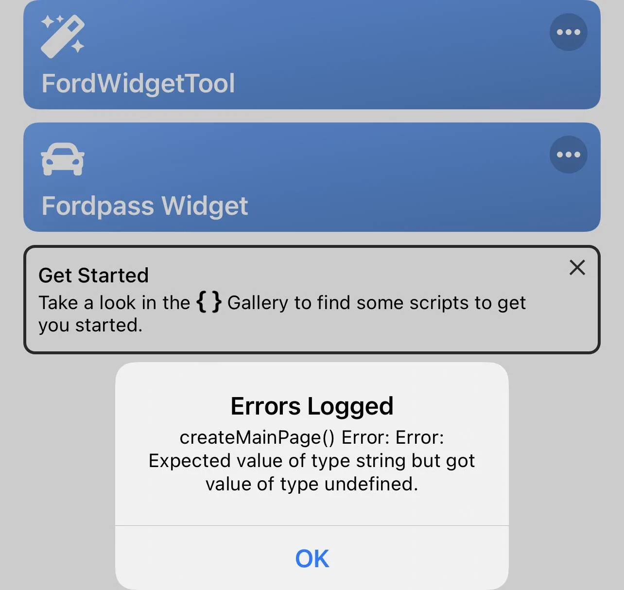

New today, started after 2.5.1 installed. Tried an update, restart etc.
Run the Ford Widget Tool and reinstall the instance, as that has corrected this error for me in the past.
I just started getting this exact same error. 2.5.1 dropped yesterday.

Any word on the broken widget tool? ???
