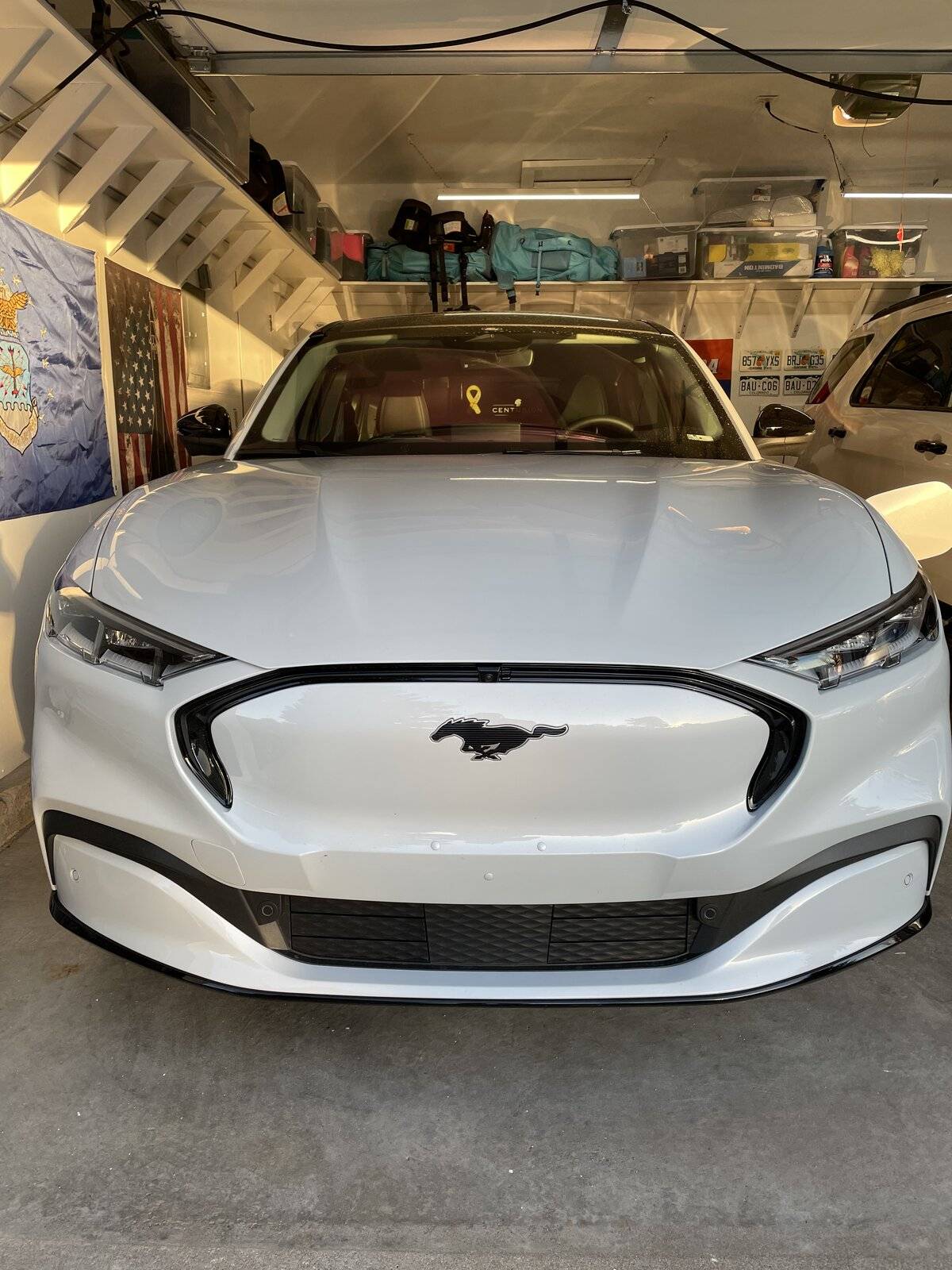

Space White bumper plugs from Bumper Plugs!
Question is what size and type to get? The video is for a BMW, the size hole from the factory rivets are larger.
I got two from bumper plugs but I am stuck on spending another 30 for one piece of plastic. I got touchup paint already.
I agonized over that too but then figured it’s at least $1k to fix/repaint the bumper, and if a dude was holding my $50K+ car hostage with a drill to my bumper, I would gladly give him $60 to go away...assuming I couldn’t win a fight. (I also hadn’t seen that video...looks like that will work great for cheaper)
Also, slight chance you break one plug on install so you at least have a backup, or someone on here would probably buy a single!
I didn’t see an option to change size, just selected my car (or maybe just Ford) and color and they fit.

Those look good. If my DIY version doesn't cut it, I will have no problem ordering these once they have Infinite Blue available.

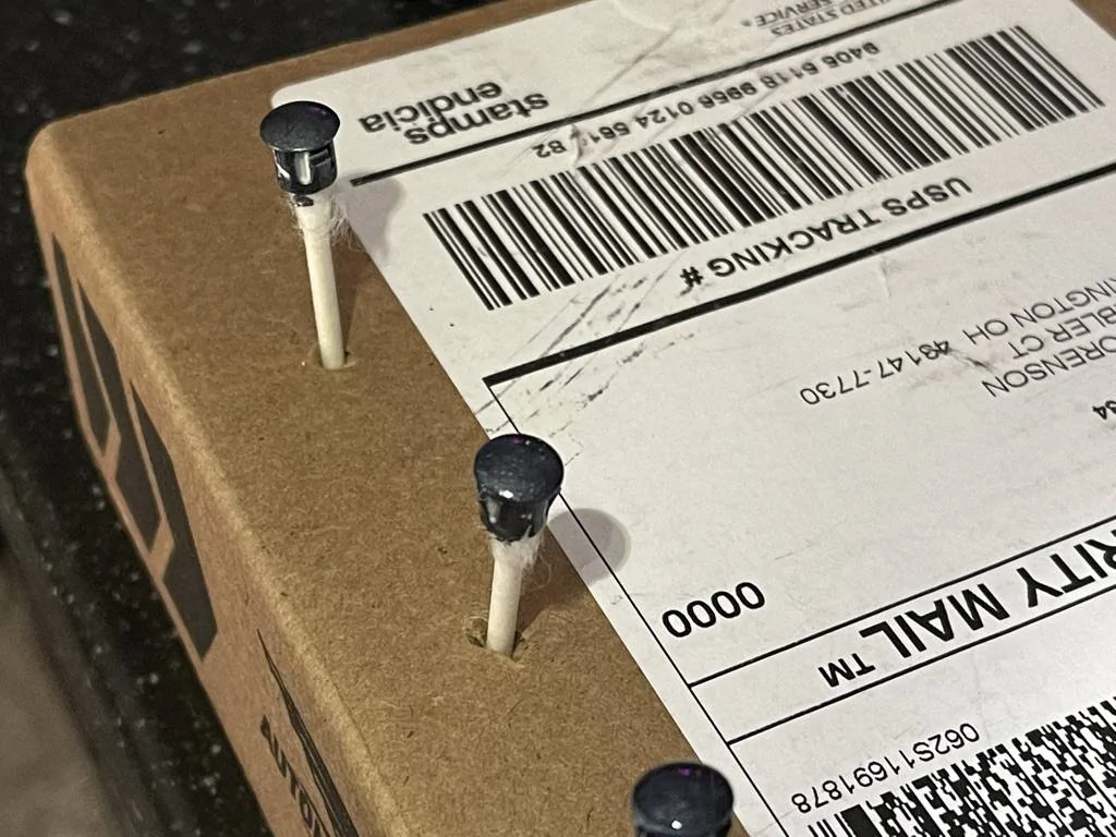

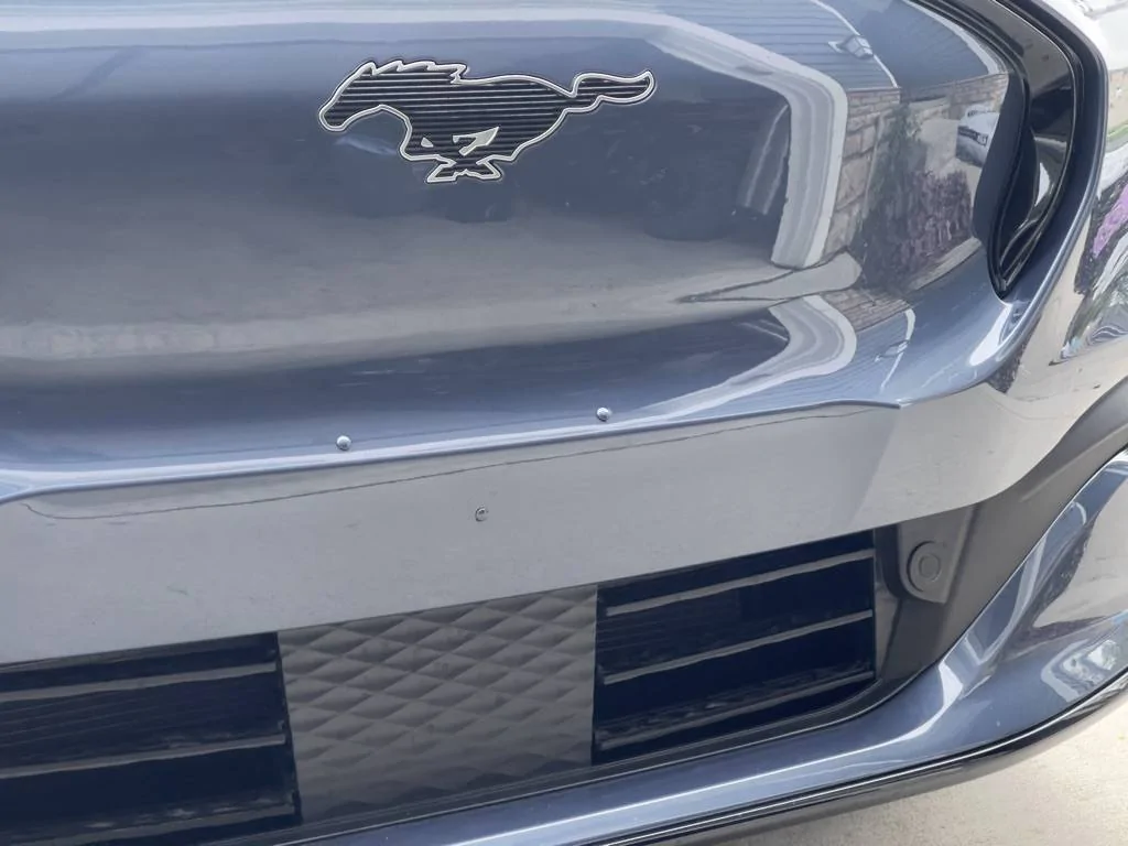

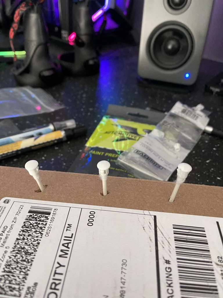

So this is attempt number 1 with the DIY plugs. I purchased both touch-up pens and brush-in-bottle for the color and clear coat (always good to have on hand anyway). I ended up using the brush-in-bottle paint and clear coat and I am pretty happy with the results. The photos are not the best but this was super simple and those 1/4" hole plugs I linked are a perfect fit. Hopefully they don't pop out while washing/waxing and the paint stays on them. For $.89/pair and to have extra touch-up paint now, I think it's worth a try.

that looks pretty great for the cost of some cheap plastic parts, some cotton swaps, and touch-up paint that everyone should get up getting anyway!
