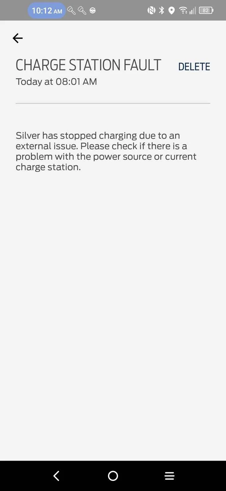

I have a grizzll-e classic premium cable 24'. It is on a 50 amp circuit 14-50 plug. If I plug the unit in during the scheduled charge it works properly and charges. If it is plugged in during off schedule the car senses it and shows waiting for scheduled charge. When that time arrives the car shows red, I unplug from the car and plug back in and it starts?.
The Ford mobile charger works properly. Does anyone else have a problem setting a schedule and having the Grizzl-e charge?

My Grizzl-E started just tripping red during the day when unplugged, has degraded over time to the point now that it will not charge the car for over 30 minutes without tripping. Think there is a bad batch of them out there. I contacted the company last Tuesday and am waiting for a response.
Will give them another chance next week and if no joy move on to another brand.
I've got the same issue, they sent me a technical support form on Tuesday which I filled out and returned but no response yet.

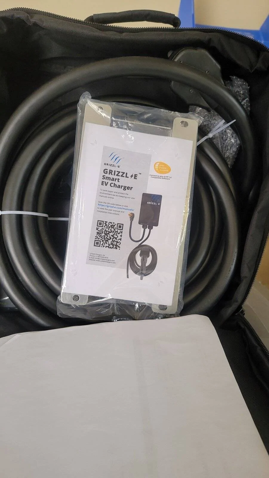

I just bought the Smart version and have the installation scheduled for June 10th. If I see issues I will post them in this thread.

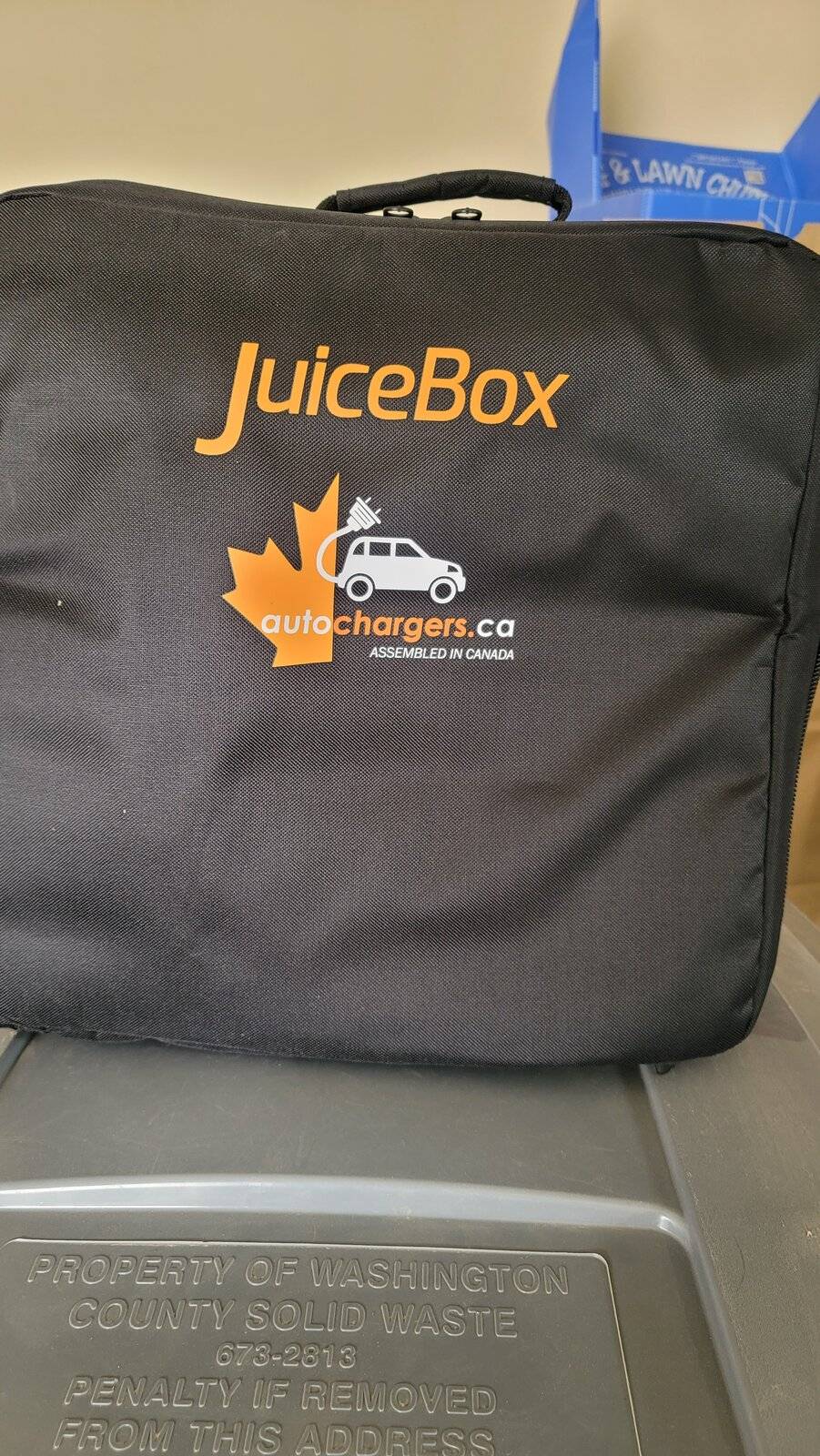

Interestingly, I also bought the Soft Carry Case and it is clearly branded as "Juice Box"! Is there a connection between Juice Box & Grizzl-E?
The only connection I'm aware of is that both brands are sold by autochargers.ca. Maybe Grizzl-E resells the autochargers.ca bag for customers who want a bag?
It is weird, though, especially since autochargers.ca doesn't sell its own bag on its own site.
