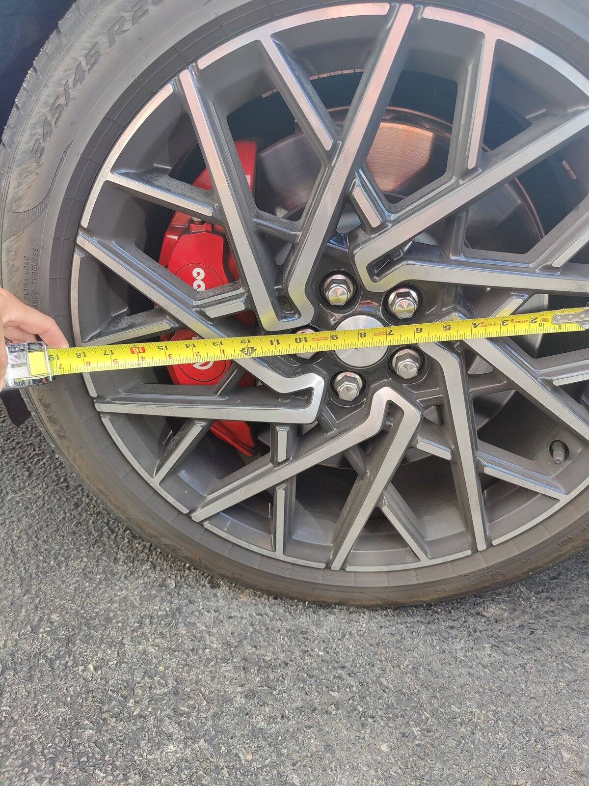

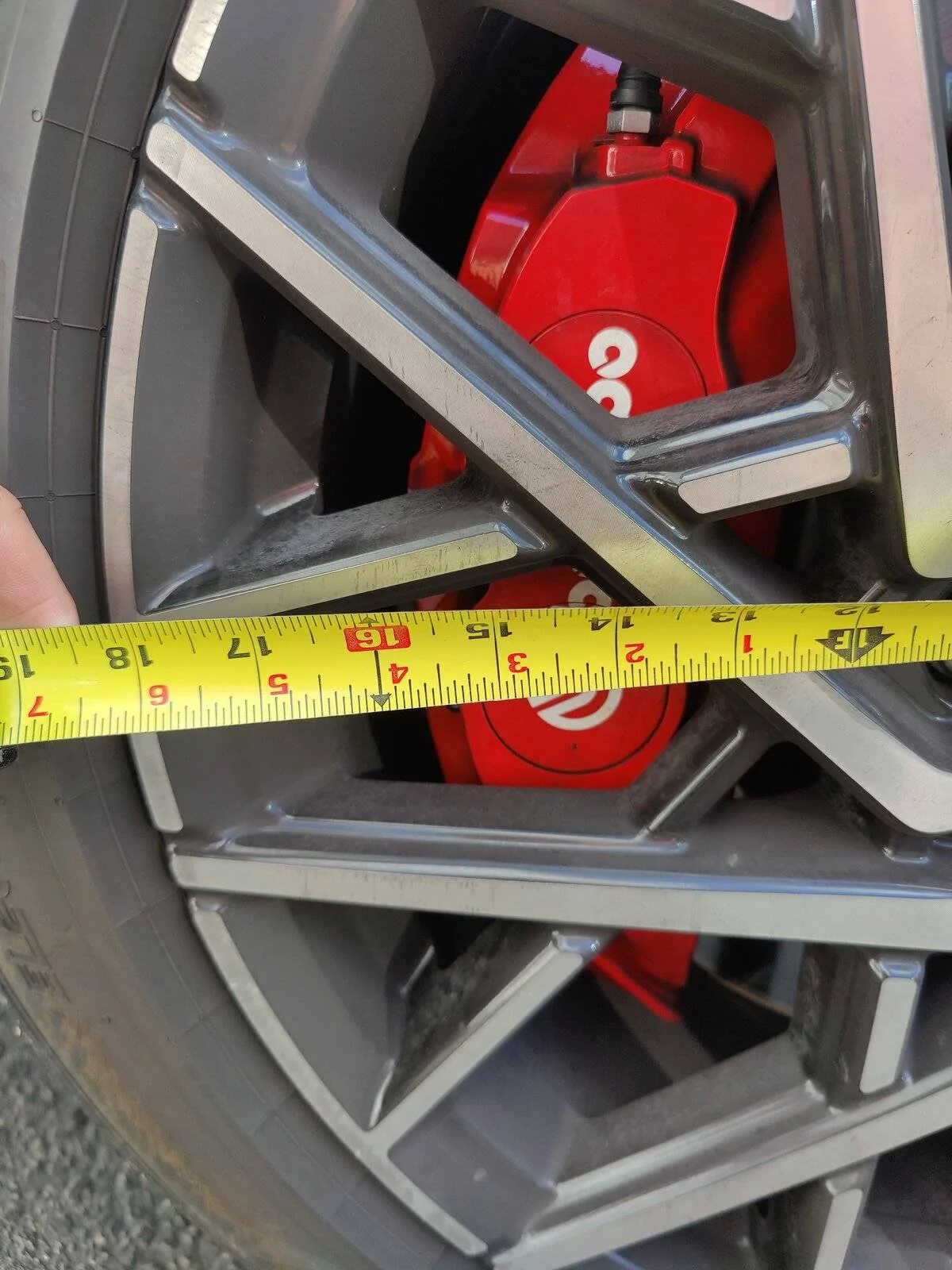

(obviously rough because I didn't remove anything)
I'm seeing just over 15" diameter rotor and close to 16" to the outside of the caliper. That tracks to Ford documentation, but does that fit under a 19" wheel?

Hard to say for sure but looks to be just over 1/2" clearance for the calipers to the barrel of the wheel. That would be a TIGHT fit for 19" wheels and a close shave for the wheel weights. I don't think I'd chance it. Hard to believe you'd NEED a 20" wheel at a minimum on this vehicle but that looks to be the case from my perspective.
I agree. :-\ Maybe the 20s stay for winters, and get 21s for summer. :cool:
