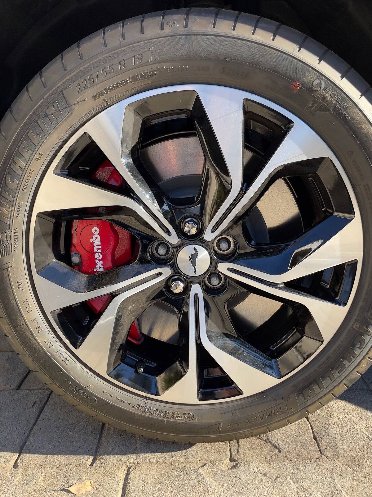

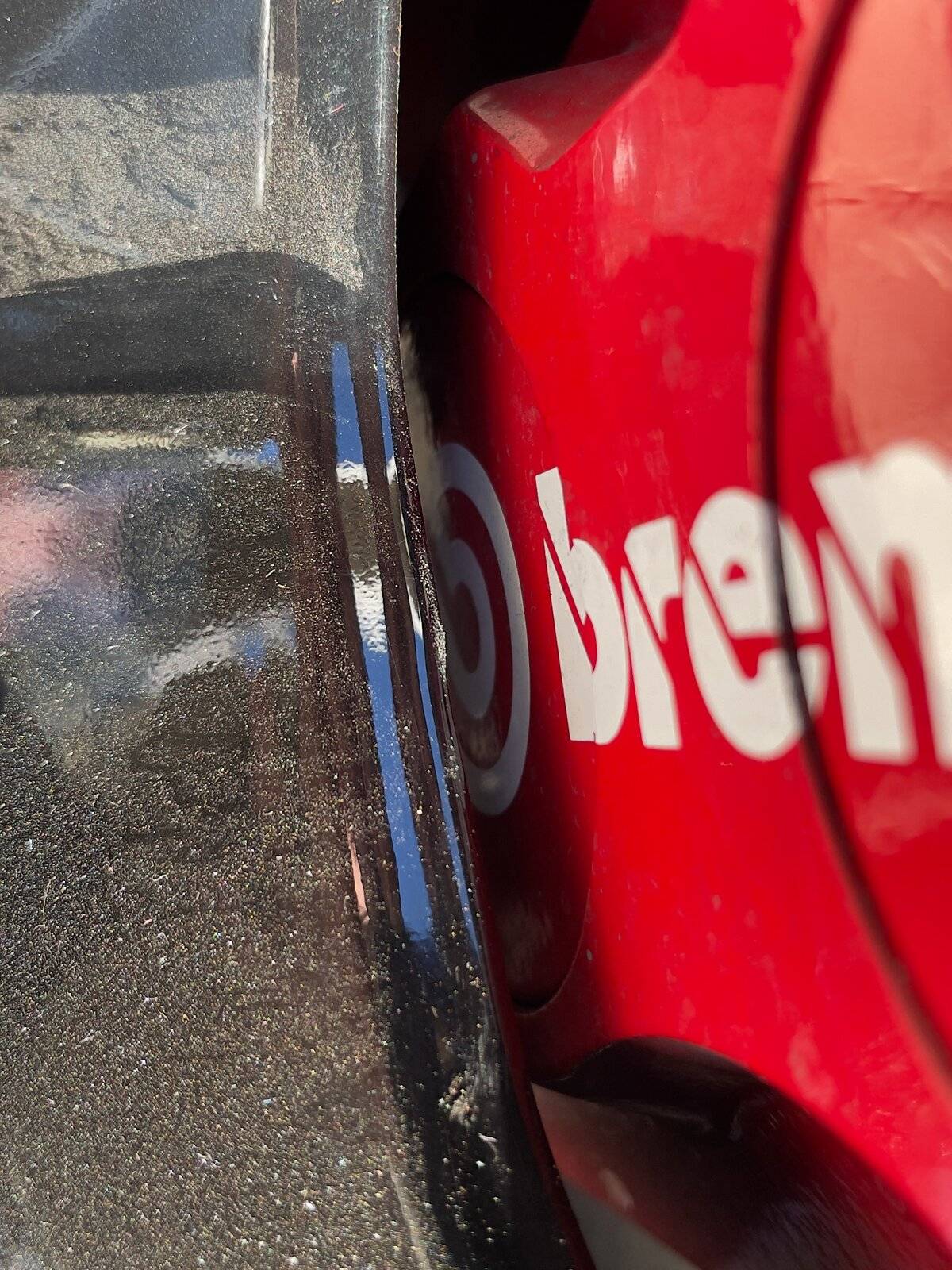

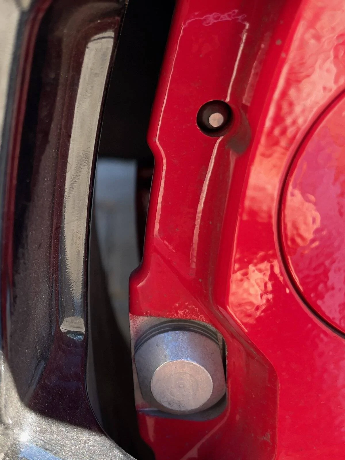

Ok Rory, the answer is YES, the 19" Premium OEM wheels do fit on the GT/PE. There is 1/4" between the inside of the wheel and back of the caliper and 3/16" between the back side of the front of the wheel and the front of the caliper.

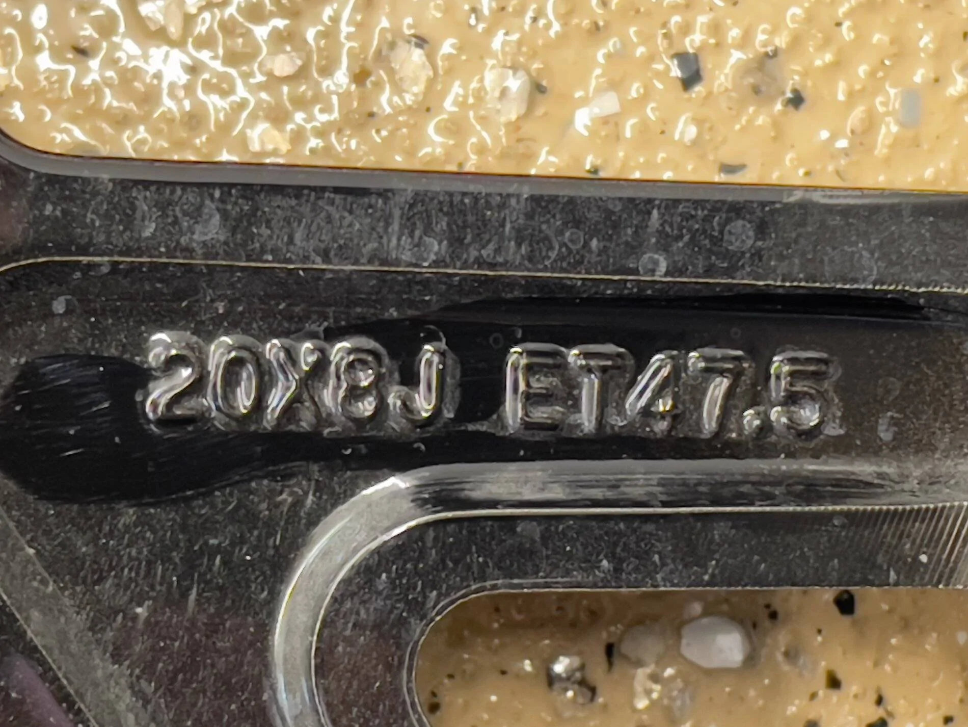

Also as stated in the Wheel and Tire info sticky thread, the GT/PE wheels are 20x8 ET 47.5

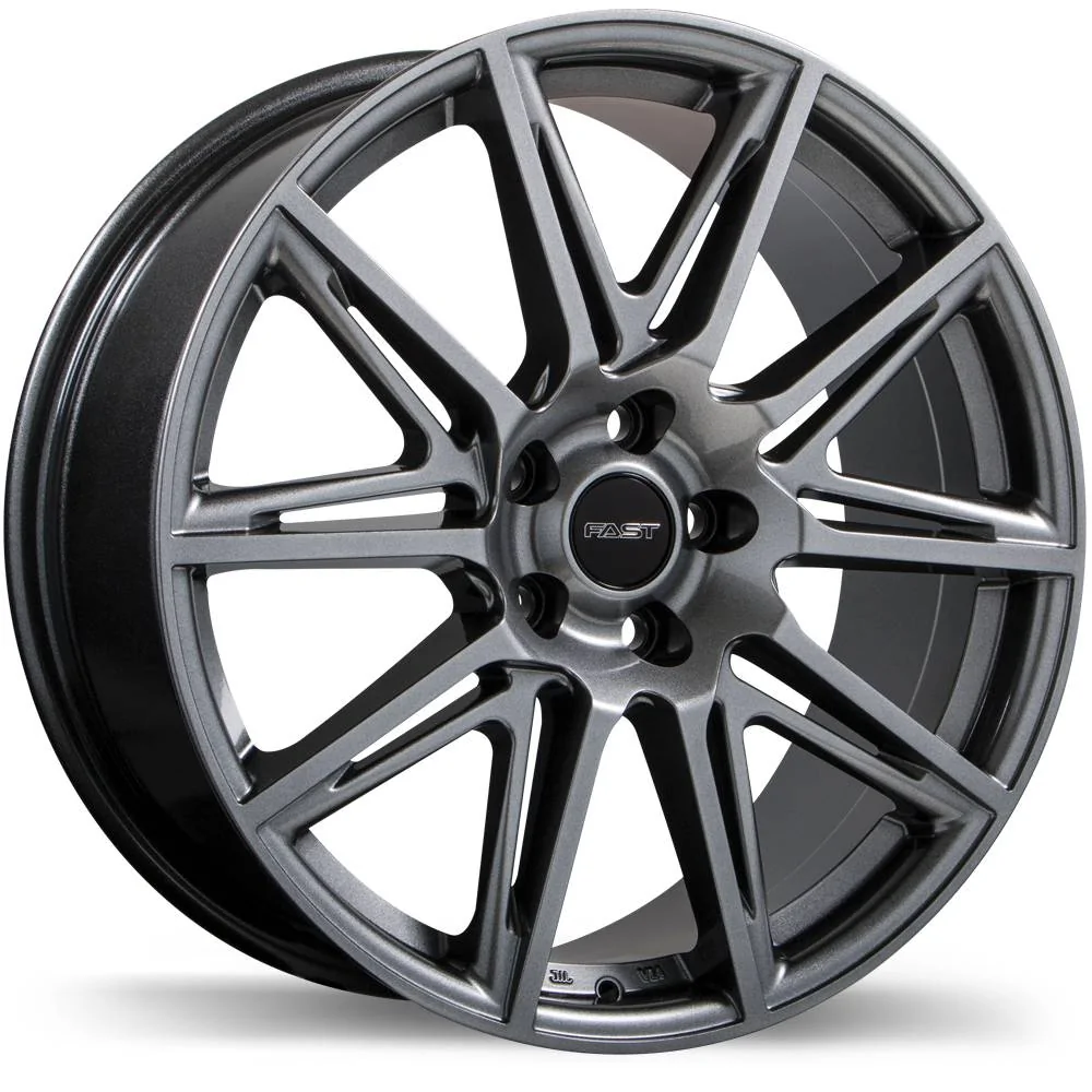

Waiting for Dec. production of my MME GT Perf. It will arrive in the snow (Toronto, Canada here). Need winter setup. Tirerack has virtually no 20" rims left in stock for the 2021 season, or if they do, they are $550+ each. I plan on leaving the Pirelli P Zero summer tires on the stock GT Perf. wheels to prevent possible dismounting damage, and went with a totally new tire and wheel set for winter: Pirelli Scorpion 245/45R20 and this Canadian company wheel, FASTCO wheels, of Quebec, Canada.
They are in stock, at only $340 CAD each. They look like the GT Perf wheels, so I think it's a good wheel for those who are still looking for something reasonable to buy in 2021....
Are they available in 20 x 8 with ET 47.5?
Clearly they fit on the hub but did you actually take it out driving? I know the rims don't flex or anything but what about overheating the brakes or something else? A quarter inch doesn't feel like a lot of room
That caliper clearance is PLENTY. Lots of performance cars with aftermarket wheel and/or brake setups have less than what Mark measured.
Yes went downtown which is about 5 miles round trip. Maximum speed was about 50 on the mountainous roads. No issues.

I would like to know exactly what the Mach-E GT Performance Edition wheel specs are. 20" x _ wide? Offset? What aftermarket wheels would match exactly the specs and fit over the brake calipers?
20"×8", offset +47.5 (ET47.5), weight 29.5 pounds. 5x108 mm lug pattern.
