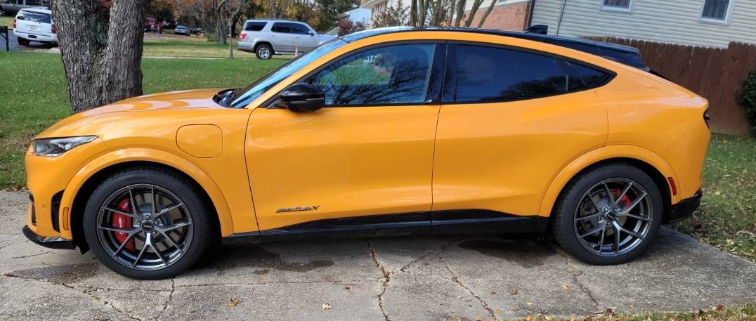

I purchased new wheels (20x8.5 Gloss Gunmetal Silver Painted ASA GT14) and the Conti DWS06+ from tire rack and haven't looked back. Look Great - Drives Great. I store the Stock Wheels/Tires in my basement and will put them back on in May.
Ford Mustang Mach-E GT Performance Edition winter tires Screenshot_20211113-151402_Gallery
