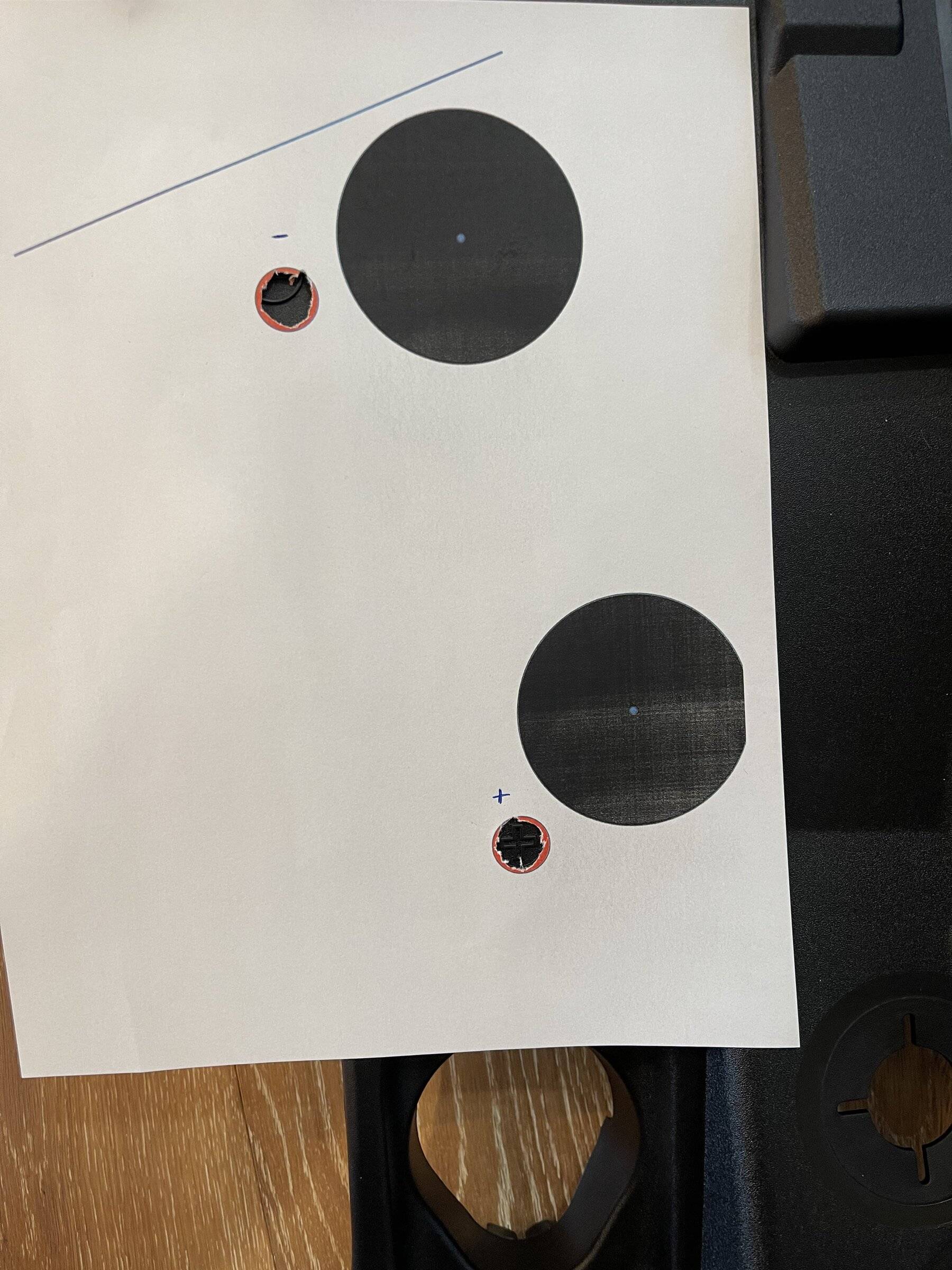

Am I not printing this right? I can’t seem to get the negative/positive holes aligned to drill them correctly. I’m slightly off
when I print it out, I put it at custom scale 100%. Not sure if the margins on/off
Make a difference but this is what I’m getting for mine
To be quite honest, the template creator made this template so it's not center over the battery posts anyway. I would align one, drill, align the other, then drill it.
Since they're not centered anyway if it's a 1/4 inch off it won't make much of a difference.

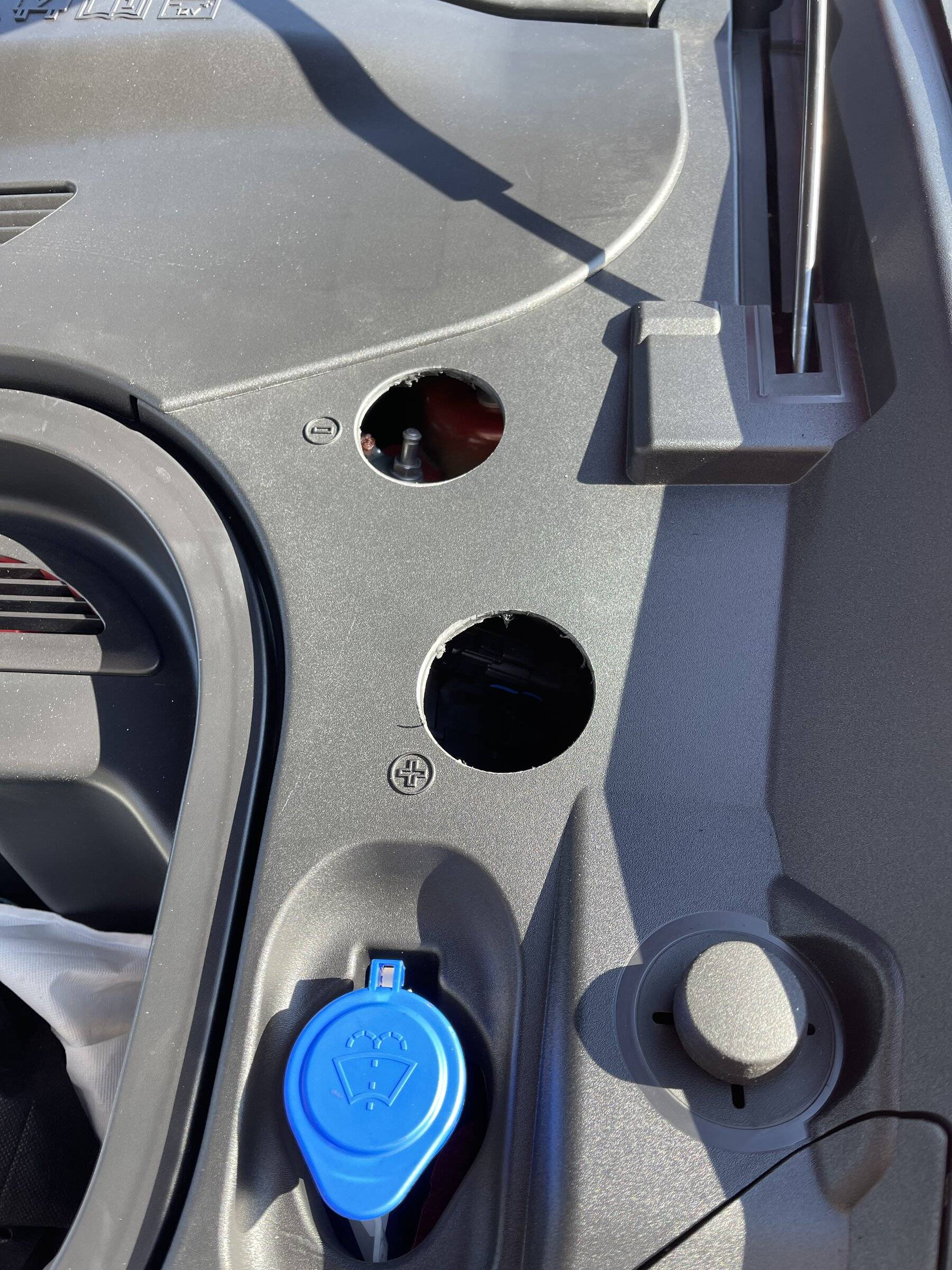

Thanks for the help! Slightly off with the positive terminal, but still worked out just fine.
Mine too with the positive terminal but access is still fine.

Thanks for the shout-out, but it wasn't originally my idea. I saw it elsewhere on the forum. FWIW, I did not remove any of the plastic shrouding. I just lined up the holes by sight based on other people's pictures and used a two-inch hole saw. Easy-peasy.
I eyeballed mine too without removing plastic shrouding. Negative was directly over connection point and positive was slightly off but will work fine.
