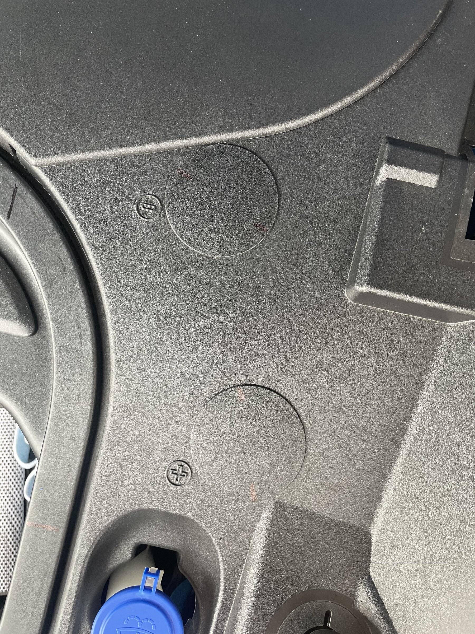

.... FWIW, I did not remove any of the plastic shrouding. I just lined up the holes by sight based on other people's pictures and used a two-inch hole saw. Easy-peasy.

You used a 2" hole saw drill bit and the 2.5" caps fit? I have a 2 1/8 bit and wondering if the caps work. I would have thought the bit needed to be 2 1/2.
I'm pretty sure that's a typo. The cap size would be the same size as the hole that was drilled.

I have fixed my error. I meant to add the diameter of the cap top. Tks for the catch.

FWIW: These 2.5" caps fit very snugly. I have removed the caps a number of times with only my fingers in warm weather. Recently, in frigid weather, I had to use a pry tool .

I took needle-nose plyers and pushed the tabs in. I also did a gentle sanding of the plastic thickness to remove burrs. They seem to be OK for me and hopefully won't rattle in the summer. ?

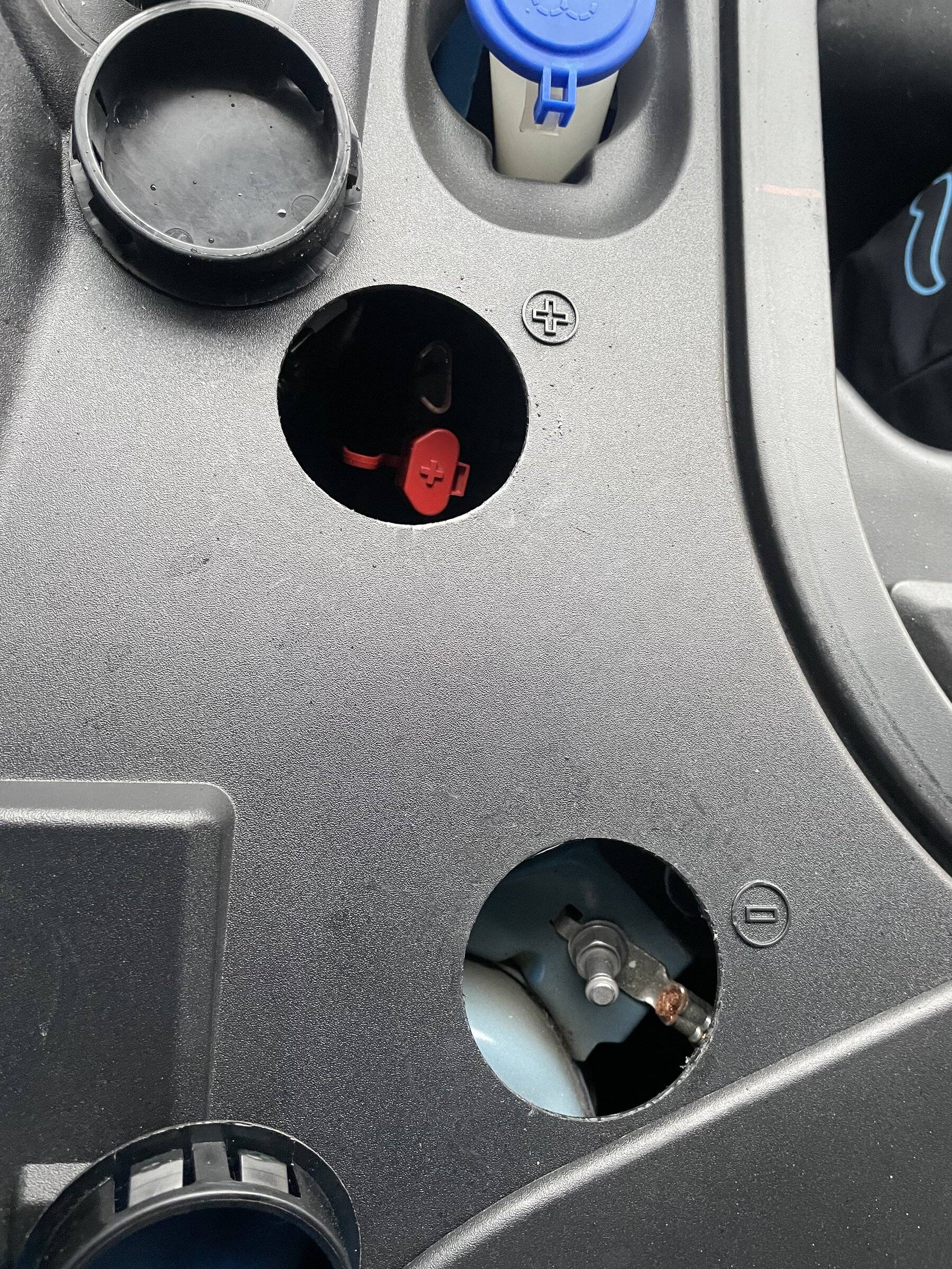

Can you post a picture with the caps removed? Is the crossbar exposed at all?
I moved the hole location a bit from the template to improve access to the jump points and avoid the crossbar.

Well, if anyone else butchers it like myself lol the part number is: LJ8Z5802038C Cowl Side Panel
I'm able to use my Ford Pass points, don't have much else to use them on, so why not! I just whiffed it with my hole saw... lol. Oh well, live and learn!
