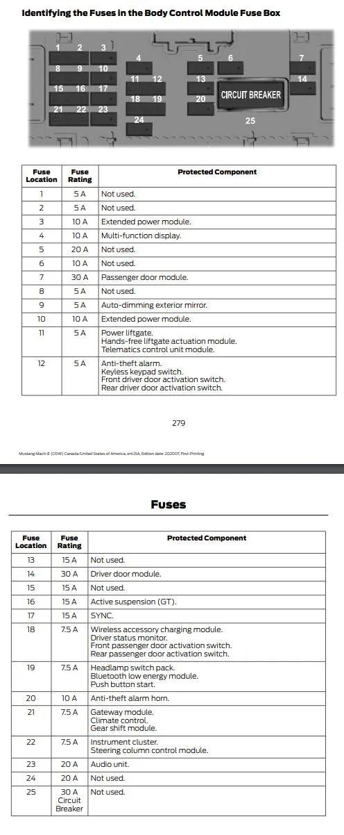

`UPDATE: Had my appointment finally with BestBuy this past Friday, did not go well. They weren't able to figure it out. They have rescheduled for Jan 13, will try again and update the board then.
Can't believe they're having trouble. What's wrong?
FWIW, I just installed a Thinkware Q800 in my Mach-E. It was pretty simple. Hardwired (no battery bank) because this is an EV, and the 12V just gets topped off while it's sitting via the DC-DC converter.
They said the car is too new, they don't know how....I emailed them the blow by blow thread posted here and they said they couldn't find a fuse circuit that was switched, only always on
The thread posted above (@louibluey beat me to it by a couple minutes)? That's the guide I used, although I actually used different fuses. There are several in there that are switched, and several that are always on. I think I tapped one of the "not used" fuses instead of the multi-function display.
Sounds like the guys at Best Buy are idiots. I would not take it back there.
All of the "not used" spots are live, unlike a lot of European cars, so it would be recommended to use one of those.
For reference, I talk about the switched/non-switched and tap types here:
https://www.macheforum.com/site/thr...a-dashcam-and-radar-detector.5542/post-291304
