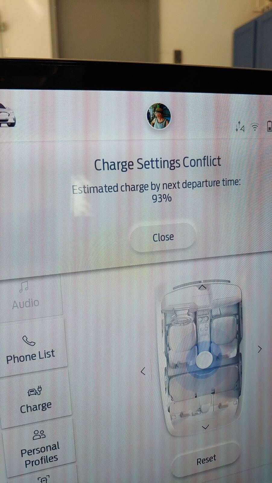

I got the car on February 11, I was able to charge the car at home every weekend on 240v using the ChargePoint Home or the Ford charger, except one weekend when I was at work, but not on weekdays. Last weekend I was able to charge it, the voltage was 257v, I tried every weekday since, when I get home, with no luck. This morning it worked again with absolutely no changes in the sittings since last weekend, the voltage today is around 255v. I still get the message that I’m charging outside my preferred charge time even though I don’t have any preferred charge time. I think even with the Master Reset the car still have some preferred charge time in the background which needs to be reset.

I am starting to get that impression as well. I have no location for home set up on FordPass anymore, but I got the charge settingsconflict message again last night. I have not been successful charging at home on 240 in over three weeks.

I get the same Charge Settings Conflict message every time I pull into the driveway at home.
