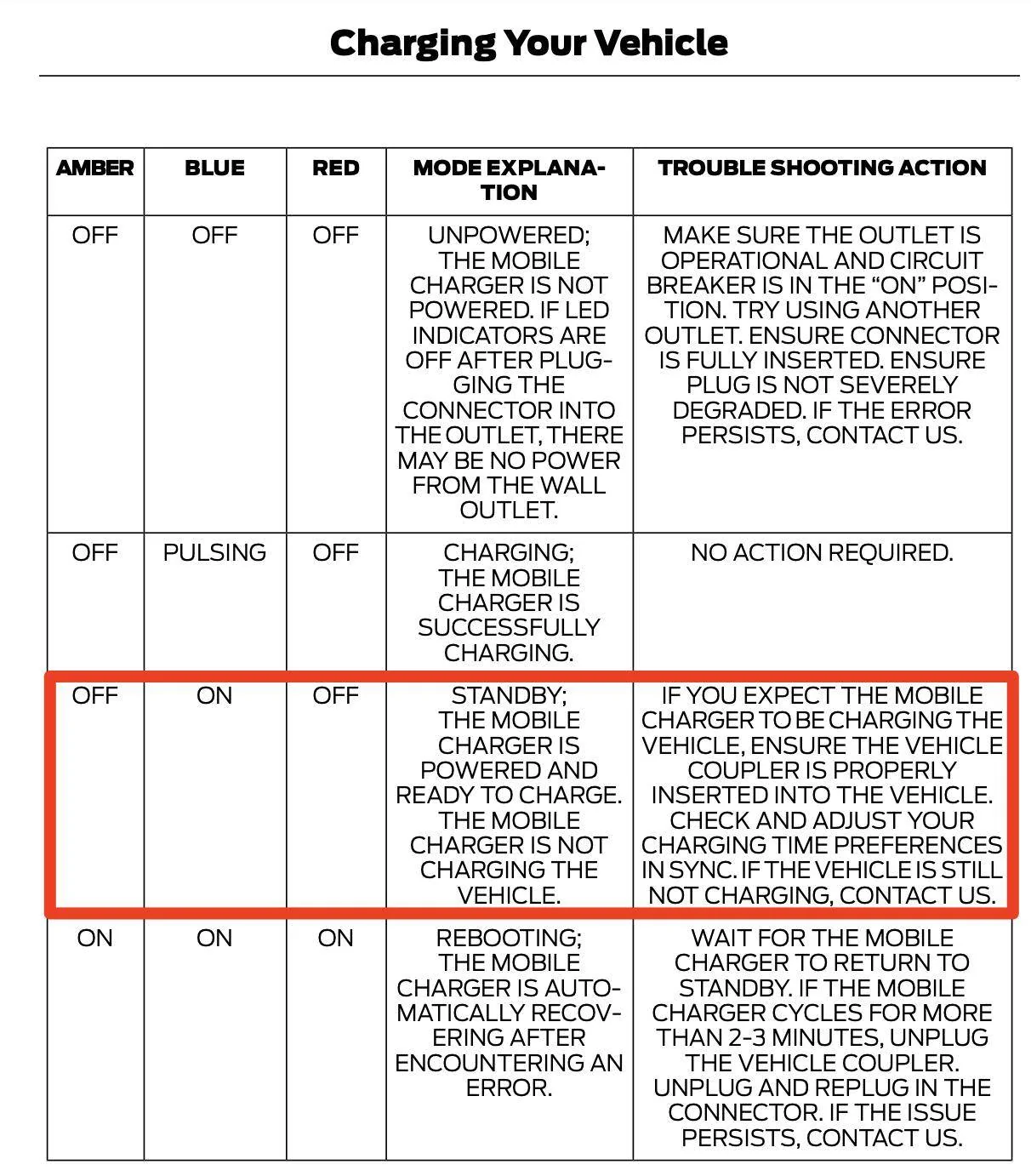

I'm starting to get the inclination that this is not either of the EVSEs based on this snippet from the owner's manual. The Ford mobile charger is just a solid blue, and the car confirms it's plugged in on the driver display. I've set my preferences in FordPass to charge anytime the vehicle is plugged in. Looks like a call to Ford is in the works.
